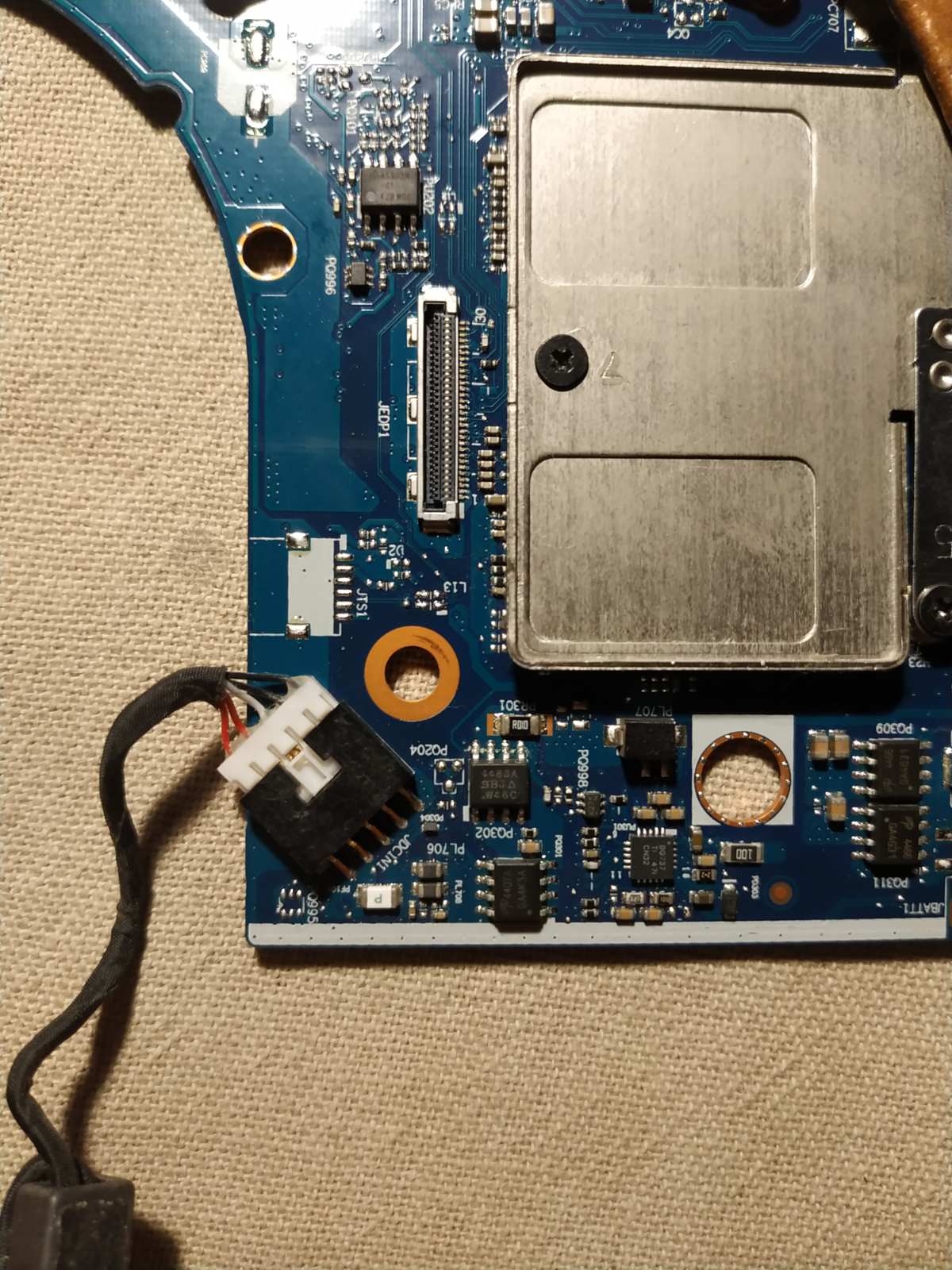

      I think you misunderstood, this is in fact a Lenovo laptop. It is the G50-70 with a 4th gen i3 and an basic AMD discrete GPU. The ACLU2 is, I think, the codename for this motherboard. There is also a thread on this forum, I think there are all the schematics needed there:
      https://www.badcaps.net/forum/showthread.php?t=72373
      1. pic attached
      2. 20V in, as the adapter states on the sticker. it is the original Lenovo one.
      3/4. there are 2 mosfets near the DC in on the mainboard, 4488A and 4407A.
      I do have a multimeter and I know how to solder but unfortunately I do not have a hot air station .
      thanks. 👍

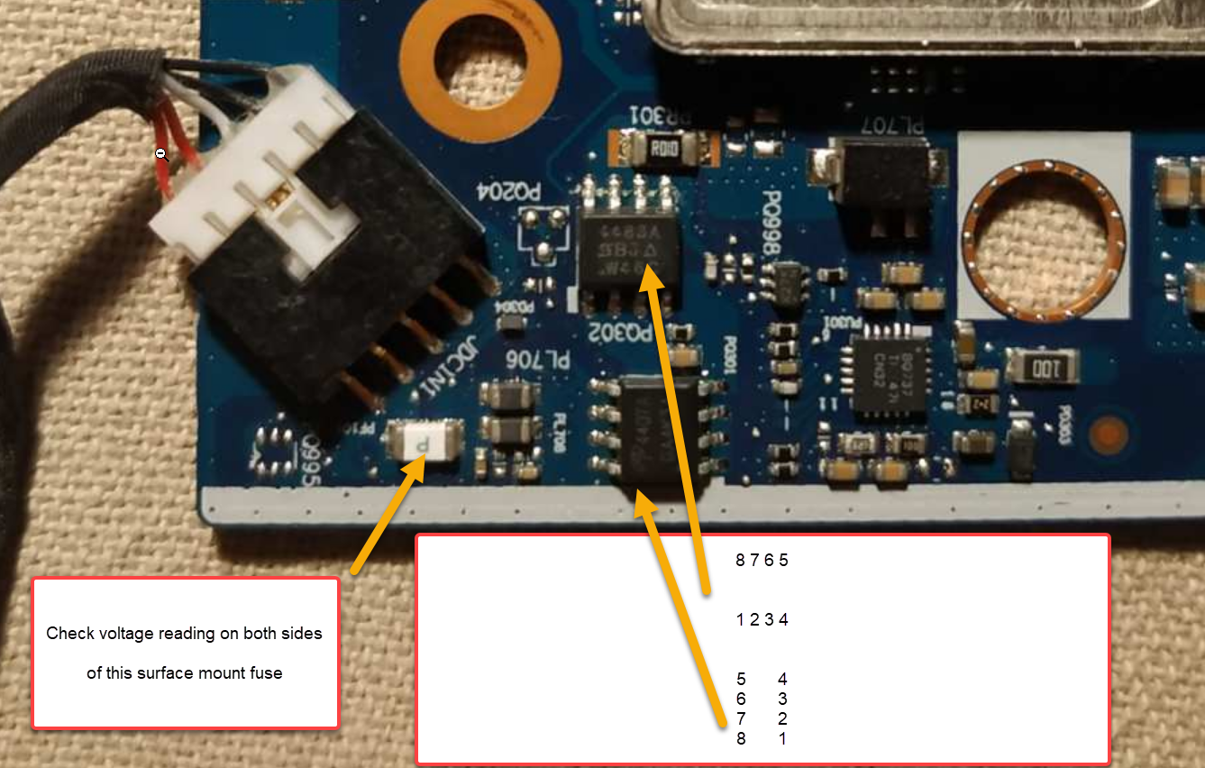

        Re: ACLU2 (G50-70) Motherboard Not Powering On
        See attached.
        Meter in DC voltage mode (any setting with 20V or higher is ok).
        1) check the voltage reading with the adapter plugged in on both sides of the surface mount fuse (it is the white component).
        Red meter lead on the one pad & black meter lead on any ground on the logic board (can be metal shield).
        2) If you do see the adapter voltage on BOTH sides of the fuse, continue to check the mosfets as per attached diagram.
        3) the white DOT on the part = pin # 1. See my Picasso drawing that shows how the pin order is for each mosfet.
        Check and post the voltages on each requested pin.
        Note that the pins are shorted together (on purpose) as per the schematic so you only need to check the voltage on any of these pins.
        In these tests, you are checking if the first in-line fuse is blown or not.
        Then you are checking to see if the first 2 mosfets are working properly or not.
        PS: For now, you do not need the hot air station. These mosfets, if they need to be replaced are SOIC 8 style. Using some sharp diagonal shears / cutters, you can remove them off the board and apply a fresh one. We are not there yet so for now, ignore.

          Thank you for the detailed instructions, here you go:
          Fuse is OK (20V in and 20V out).
          With reference to Gnd:
          Mosfet #1 (4488A):
          Pin 1: 19.91 V
          Pin 2: 19.91 V
          Pin 3: 19.91 V
          Pin 4: 19.91 V
          Pin 5: 0V
          Pin 6: 0V
          Pin 7: 0V
          Pin 8: 0V
          Mosfet #2 (4407A)
          Pin 1: 19.91 V
          Pin 2: 19.91 V
          Pin 3: 19.91 V
          Pin 4: 19.91 V
          Pin 5: 20.44V
          Pin 6: 20.44V
          Pin 7: 20.44V
          Pin 8: 20.44V

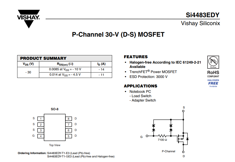

            Ok.
            1) PQ301 = mosfet p/n AO4407AL
            2) PQ302 = mosfet p/n Si4483ADY (last digit is a '3') - from the posted values, this 2nd mosfet in the design is not turning on since DRAIN pins are @ 0V.
            PQ302 is a P-channel mosfet (see attached) - specifically P-Channel Enhancement Type MOSFET (the broken dash lines inside the circle denote enhanced type).
            http://www.learningaboutelectronics....hannel-MOSFETs
            To turn PQ302 ON, the gate has to be lower than the voltage value on the SOURCE. The present reading is that the GATE (pin # 4) matches the input voltage of about 19V.
            To turn ON this mosfet, PACIN or BATT_OUT has to be a positive value such as +3v to turn on the local mosfets (2N7002) which will then apply a GROUND to the mating resistors.
            Once the local mosfets are ON, a resistor voltage divider is created which will then divide the +19V down to a lower value which will then turn on the PQ302 mosfet through the lower gate value.
            That is, when 2N7002 @ PQ307B is ON, then PR303 & PR307 form a resistor based voltage divider with +19V as the high side voltage. Together these resistors will offer a lower voltage @ GATE of PQ302.
            If the 2N7002 is OFF (default) then only PR303 is active and it will pull the GATE to be @ +19V which means that PQ302 will remain OFF.
            For these other 2N7002 mosfets to work, the 'always-on' rails must be working.
            See and check the attached. Post their values.

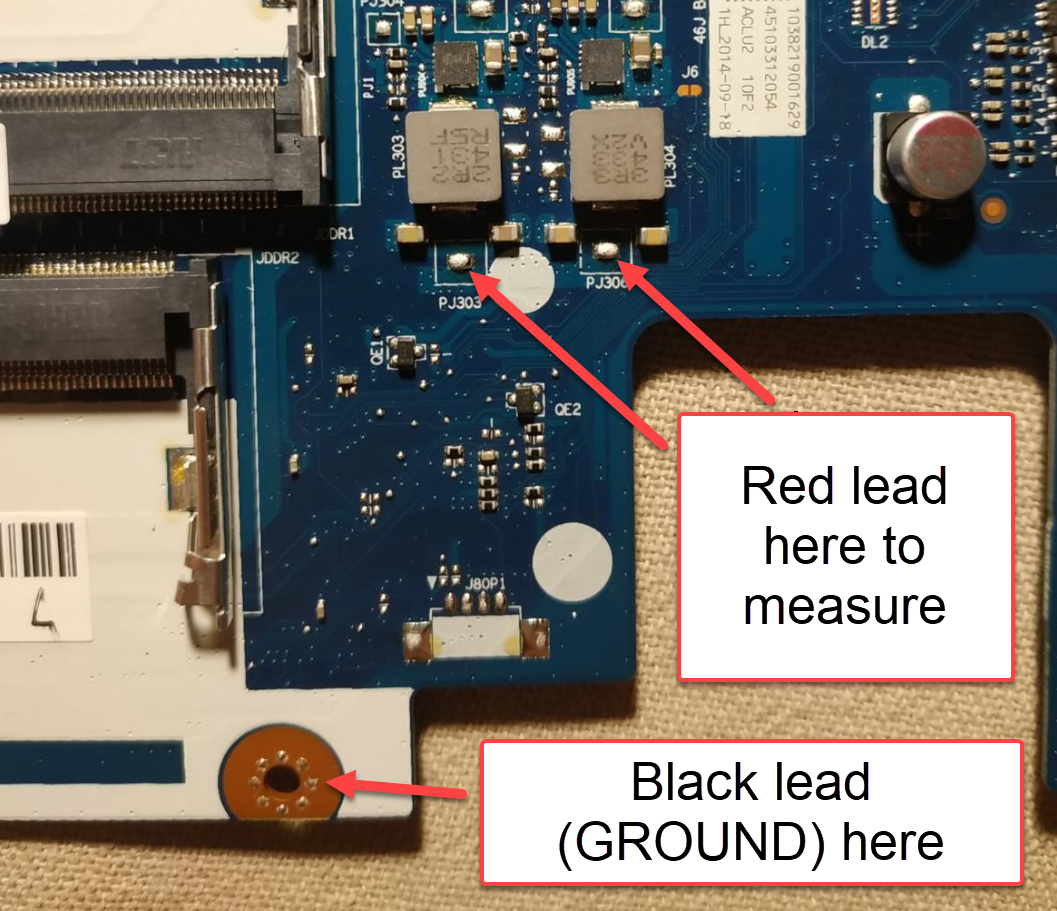

            • orestes_
              • Jun 2021
              • 14
              • Greece
              Originally posted by mon2
              Ok.

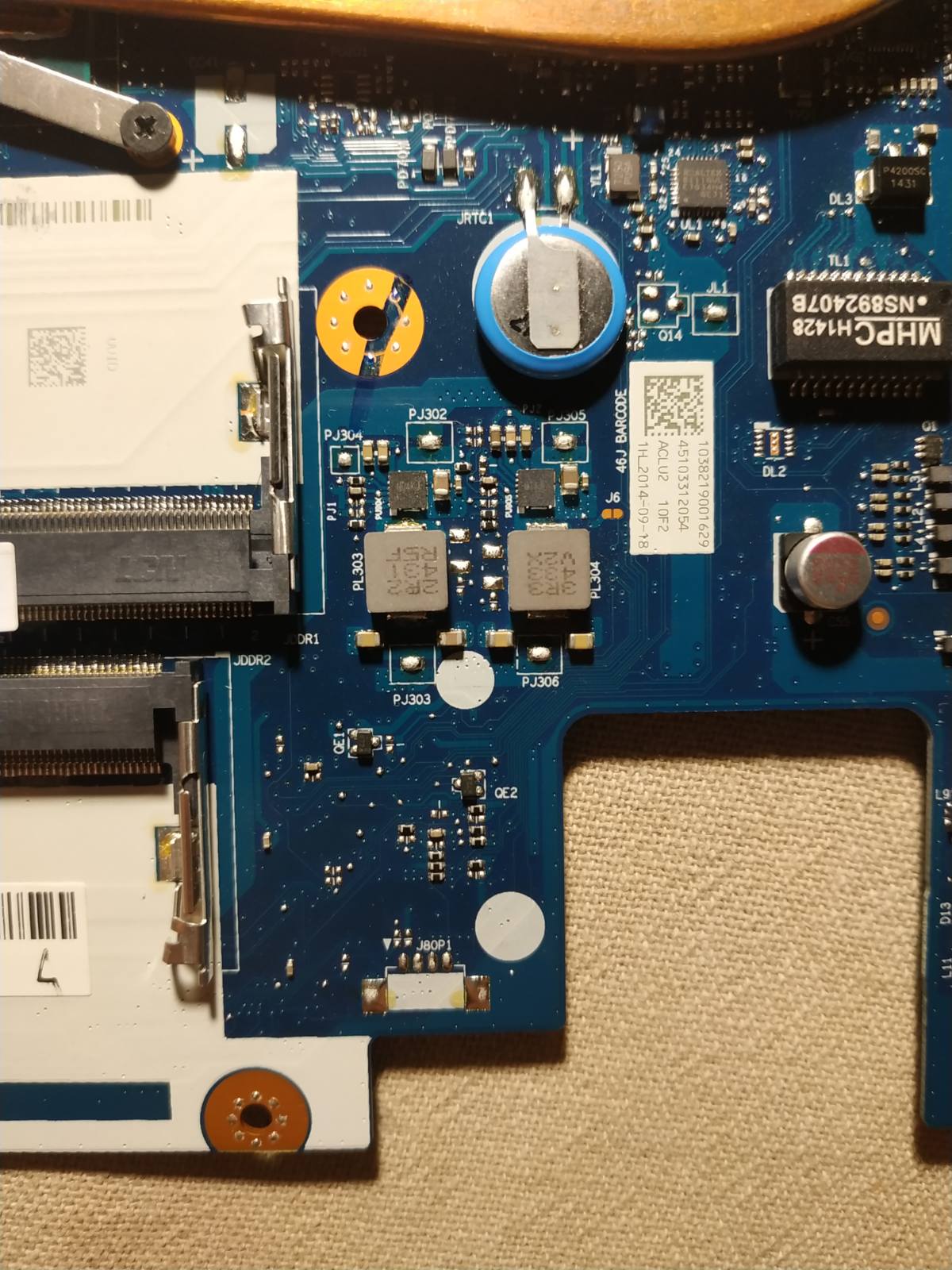

              Took me a while to find them 😅.
              You can see in the pictures the said area of the PCB and how I probed them.
              It reads 0V on both of them.
                I think the measurements were not taken properly for the black (ground) lead.
                Please see attached and repost after checking again.
                • orestes_
                  • Jun 2021
                  • 14
                  • Greece
                  indeed, I am stupid.
                  however, there is no voltage present on both of them even when with reference to ground.

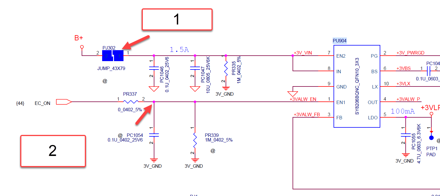

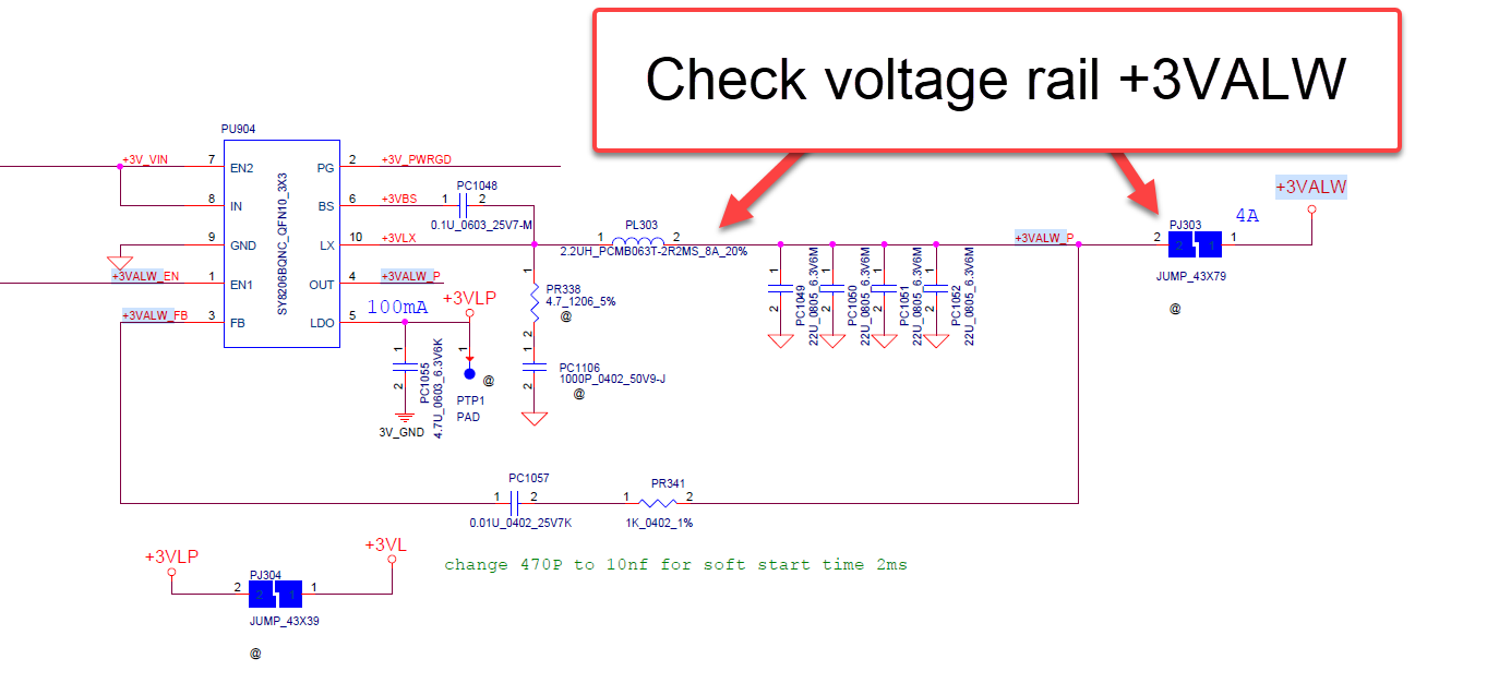

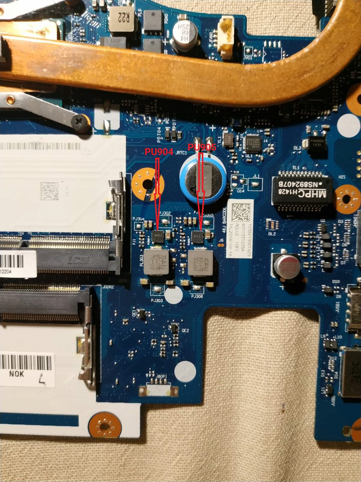

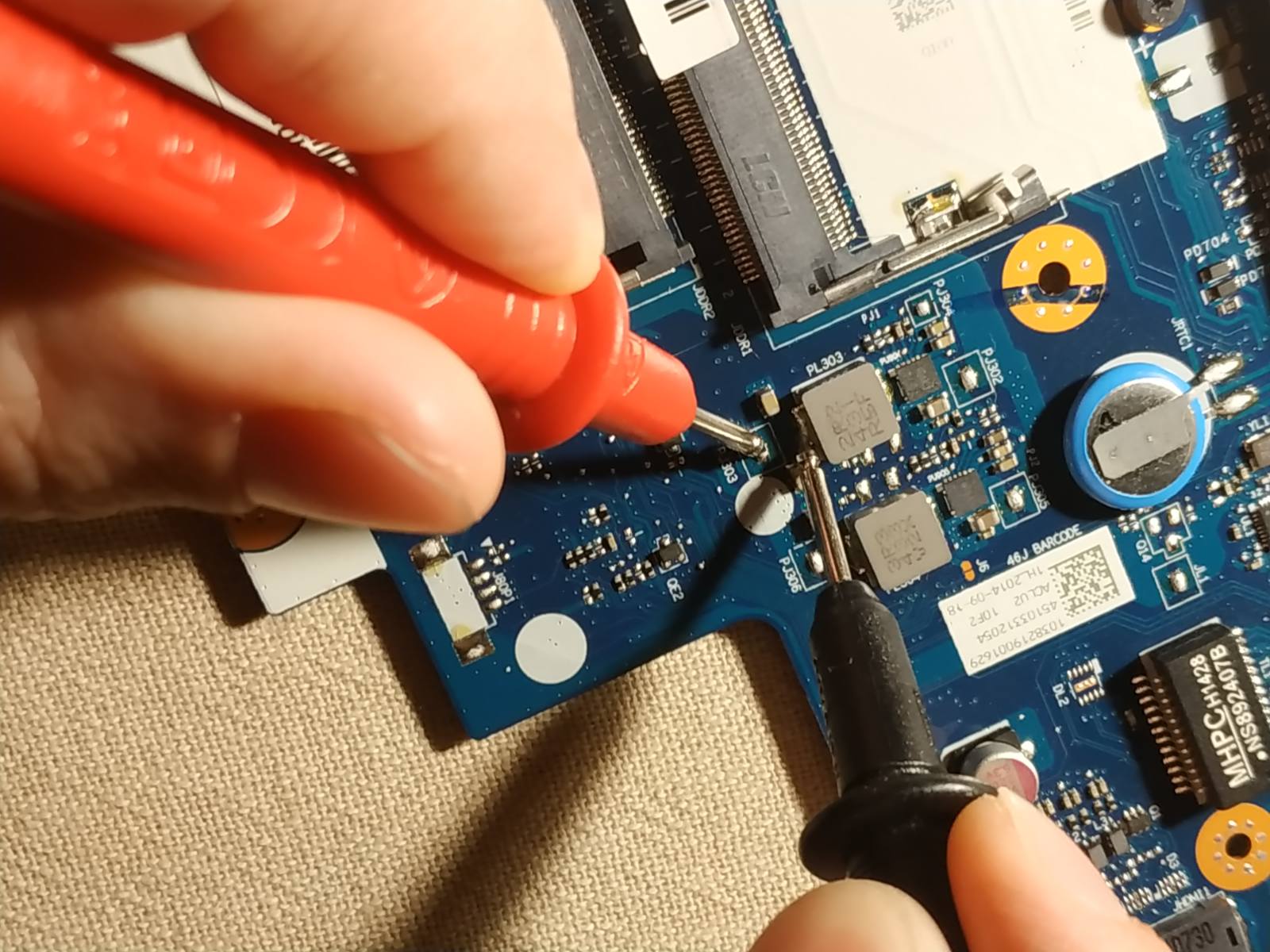

                    hi.
                    1) see attached. check and post the voltages at '1' and then for '2' on PU904.
                    Meter in DC mode (20v or higher is ok).
                    Red meter at the requested test point. Black meter lead to ground.
                    We are checking if the DC adapter voltage is reaching this (+3VALW) regulator and also if the regulator is being ENABLED = told to turn ON or not.

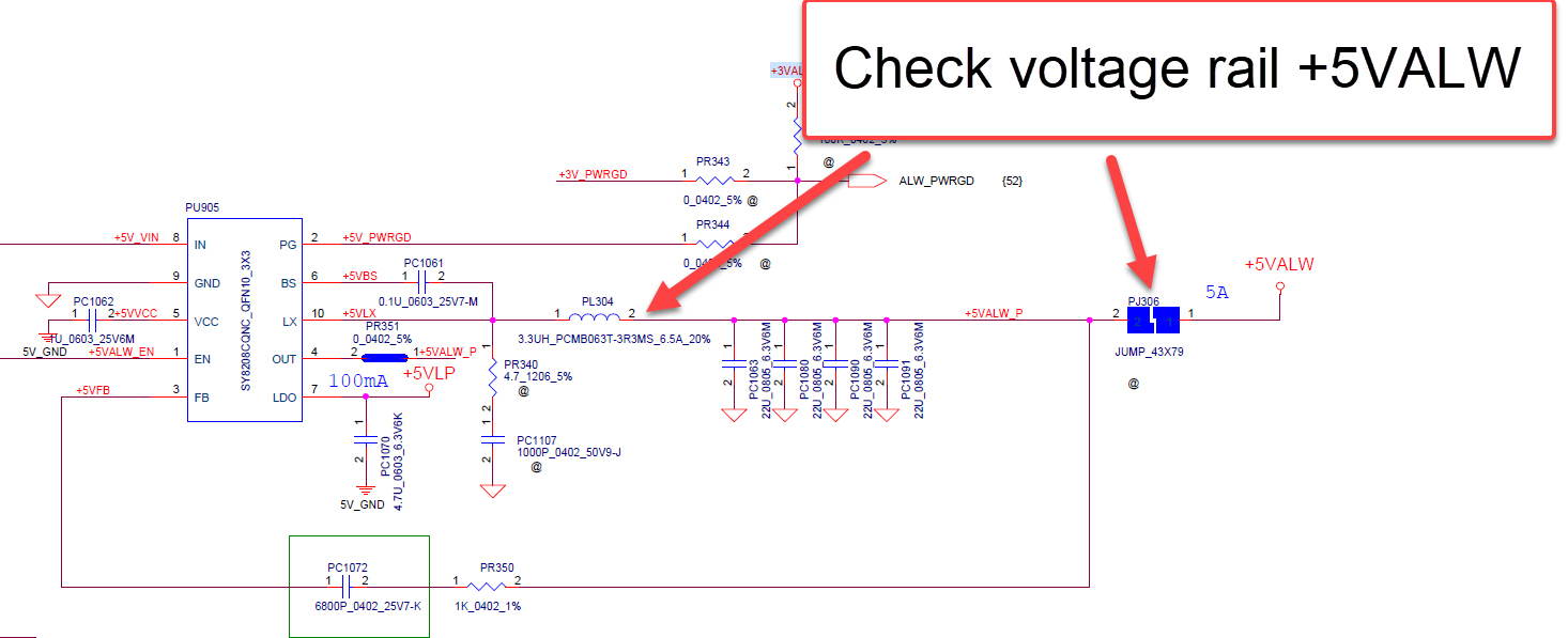

                    2) Then repeat the same test for the +5VALW rail.
                      @mon2, is there any sense in measuring voltage at PU904 when it is clear from PQ302 measurements that B+ rail is absent.PQ301 is just passing the voltage in diode mode as there is no proper biasing at gate of PQ301. PQ304 & PQ305 are there for protection purpose.@Orestes, try removing PQ304 and PQ305 one at a time and see if you get 6V approx at pin4 of PQ301 or not??
                      ps: You can safely apply power while PQ304 & PQ305 is removed.
                        hi.
                        Thank you for your reply.
                        1)
                        1. No voltage
                        2)
                        1. No voltage
                        As for the other two points (for the 3V and 5V), I am not sure where exactly I should be probing for voltage? I tried probing both sides of all nearby passive components but I did not detect any voltage on all of them.
                        I am not sure I will be able to desolder them safely/resolder them back on the board if needed? I only have a T12 chinese soldering iron availiable.
                        I am attaching pictures as well.
