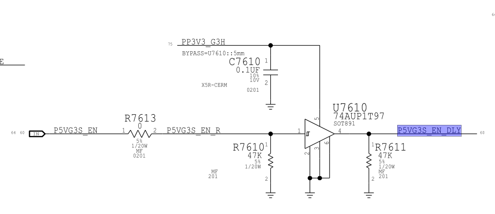

    P5V_G3S = 0V
    Check and post the voltage reading of P5VG3S_EN_DLY
    The P5VG3S_EN_DLY signal is driven by U7610. Investigate that this circuit is operating correcting by reviewing the INPUT to U7610 (pin # 1).
    Be sure that R7613 is still present.
    U7610 single gate IC is being powered via pin # 5 ?
    Post your readings.

      Thanks for the help. But now I have a bigger problem. The PP3V3_G3H is also no longer there.
      I removed the mosfet Q7680. After that I measured the pins
      https://ibb.co/17RcpLq
