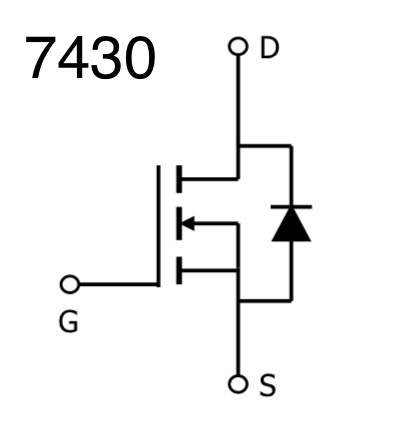

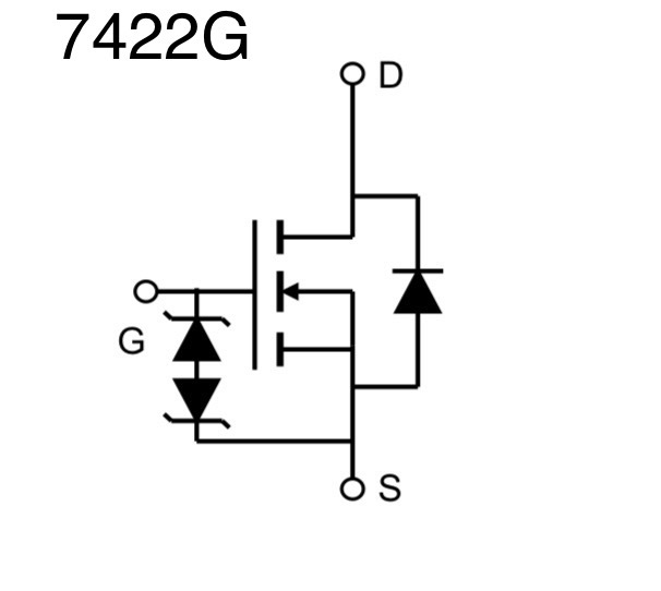

    Toshiba Tecra A40-G-138 (FUZ2SY1 A4607A) not charging
    Does anyone have a schematic for a Toshiba Tecra A40-G-138 (FUZ2SY1 A4607A motherboard)?
    It's not charging through USB C, the mosfet was dead, I've replaced it but still not working. The charger is putting 20v out and the laptop is showing it's charging so it's partially working.
    The original mosfet was a AON7422G, I’ve replaced it with a AON7430 which is a similar spec

      After replacing the mosfet, it did work briefly, 20v @ 1.57a.
      I’ve traced the voltage and it goes all the way to a mosfet, it charges fine using the barrel port, this goes to the mosfet next to the one for USB C charging. It uses a isl9241 which I believe controls the PD. I’ll get some pictures later today.

        I have a feeling is may be down to the MOSFET I’ve used, I switched them around and it stopped charging from the barrel connector.

          If you suspect the mosfet(s) -> remove all power. Meter in resistance mode.
          Measure the resistance across the mosfets:
          source / drain
          source / gate
          gate / drain
          Post each measurement. Each measurement must be hundreds of k ohms or higher if the part is ok. Otherwise, the part may be defective. Next suggestion is to flux and remove any suspect and then measure it again while the part is off the board and on your work table.

                          Im finally back on it, 9 months later thank expected. I bought the correct mosfets and it would charge very intermittently, I checked everything but no problems found. I had a spare battery, fitted that and it appears to be working correctly
