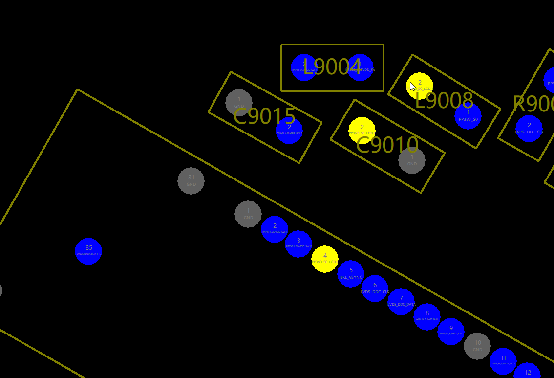

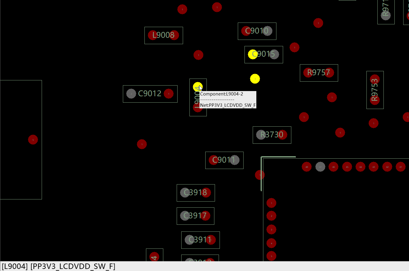

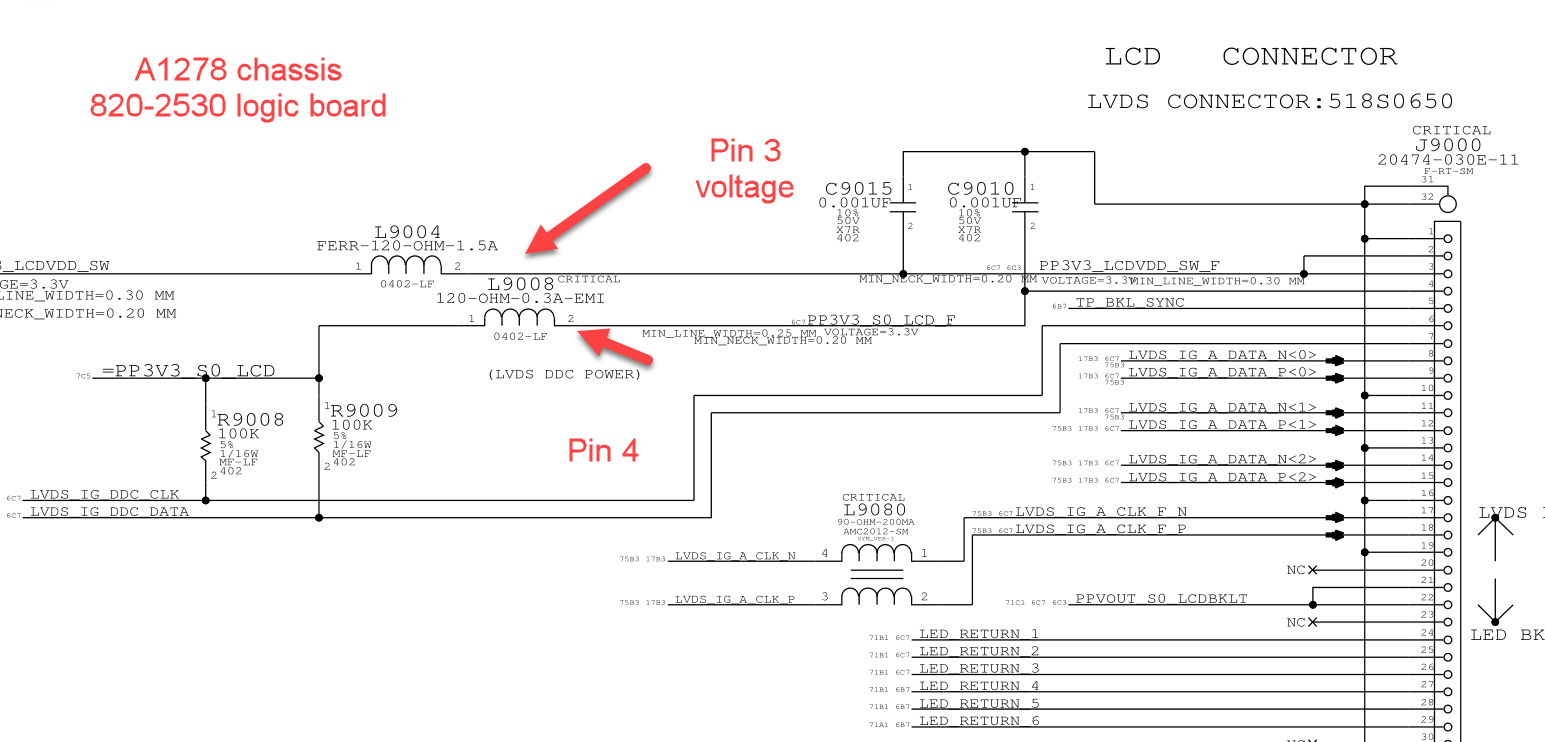

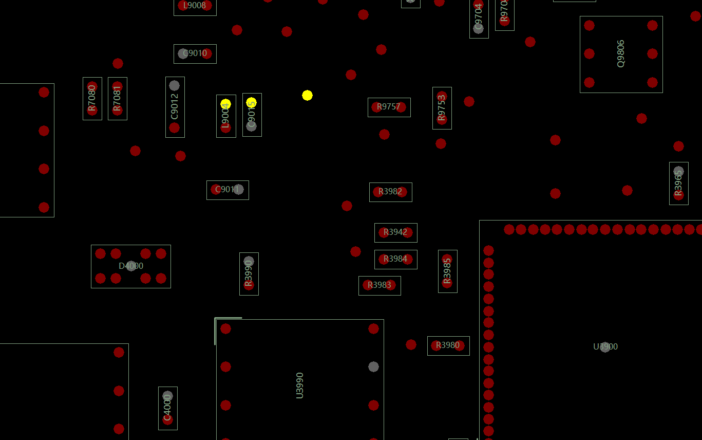

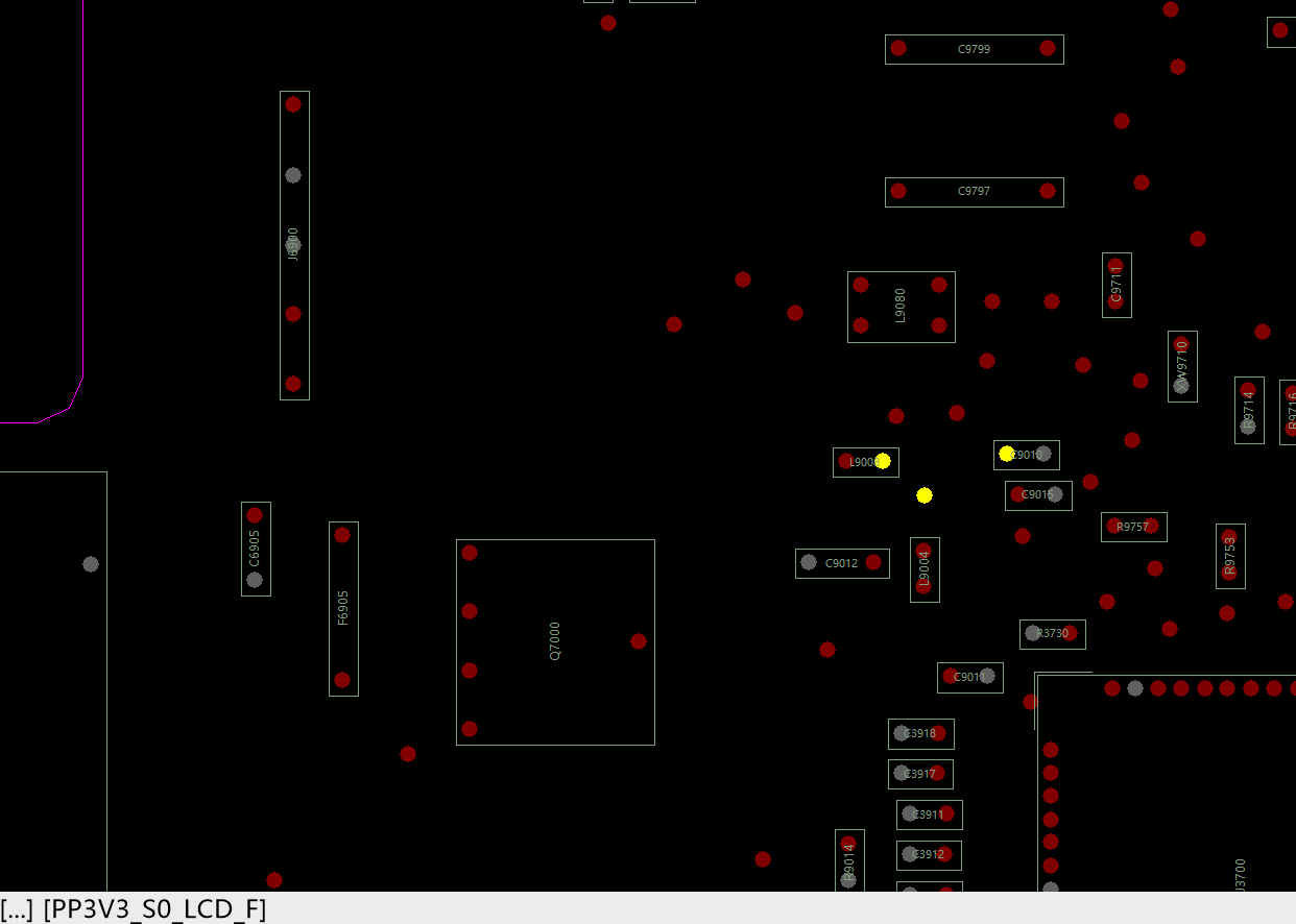

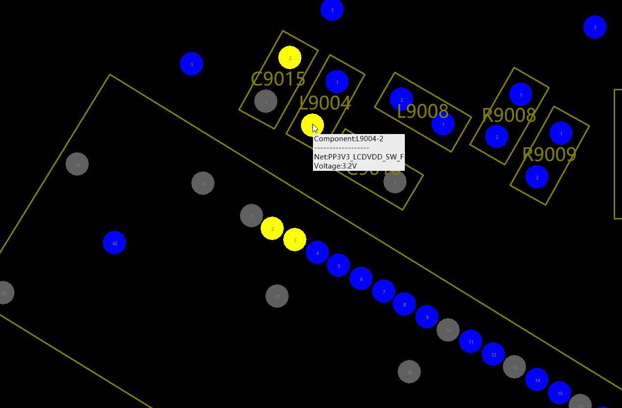

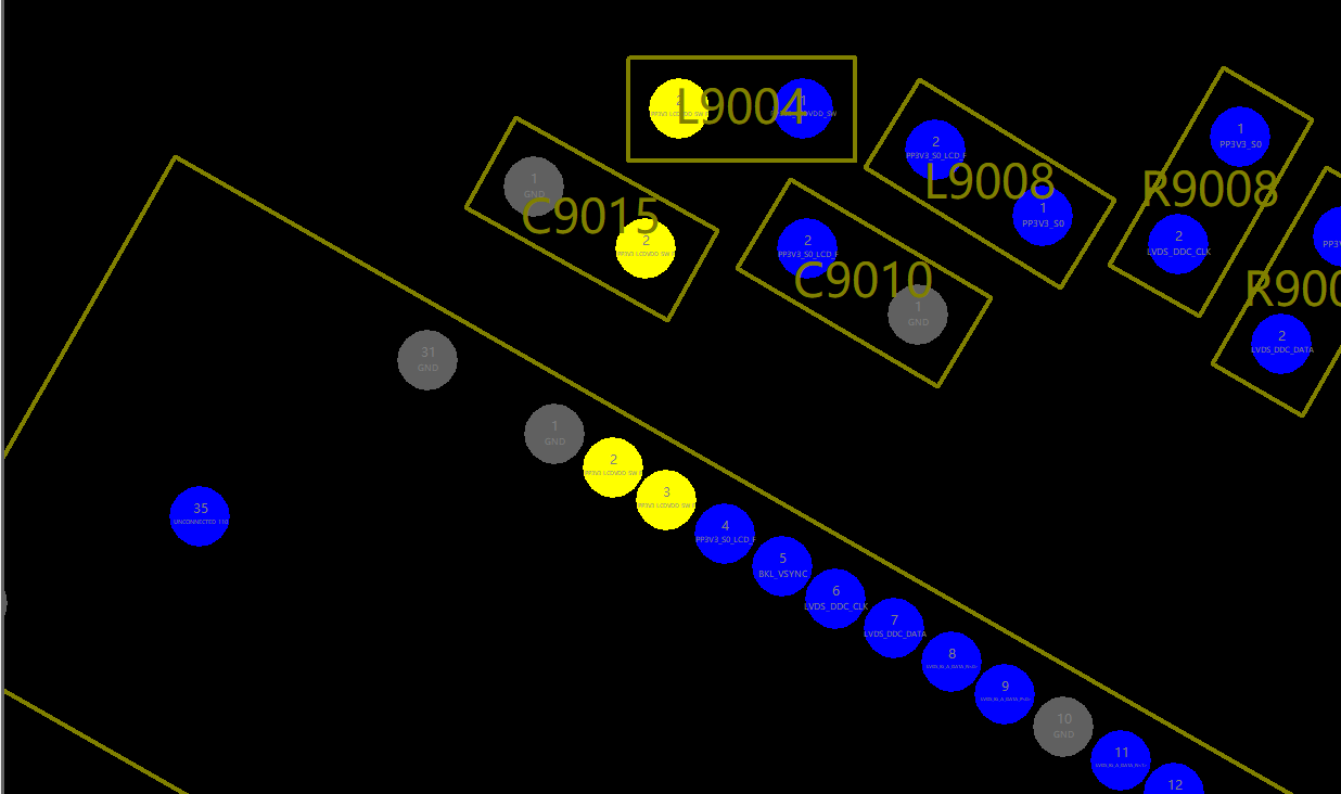

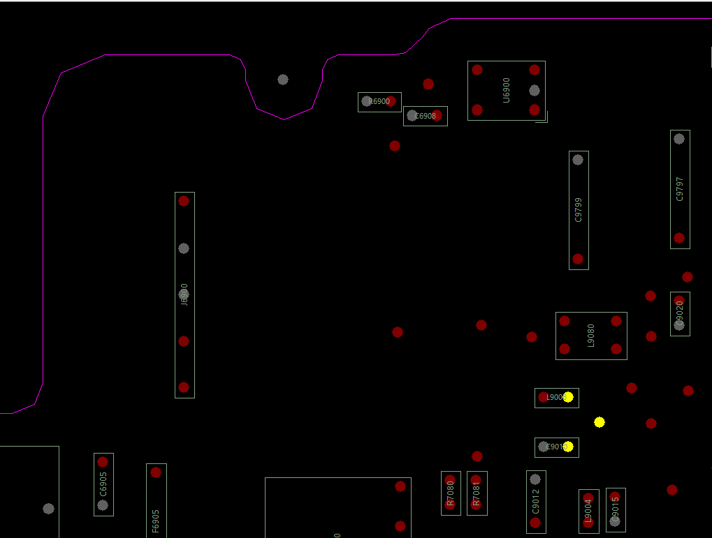

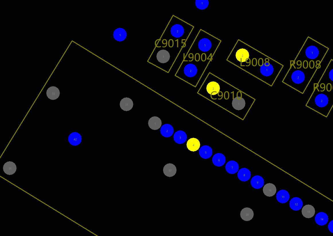

    Hi
    Was having issues with MBP emc2351 display. Corrotion on Pins 3 and 4 of LVDS connector. Unfortunately lost solder pads.
    Looking for alternative solder points for pin 3 and 4.
  • mon2
    • Dec 2019
    • 14659
    Re: 2010 MBP LVDS PIN 3 and 4 alternative solder points
    See attached...
    suitable for A1278 (Macbook PRO):
    820-2530
    820-2879
    820-2936
    820-3115
    (covers all the 2010 models in my database)
    • gersrt
      • Jan 2021
      • 21
      • Ireland
      Perfect. Thank you very much.
