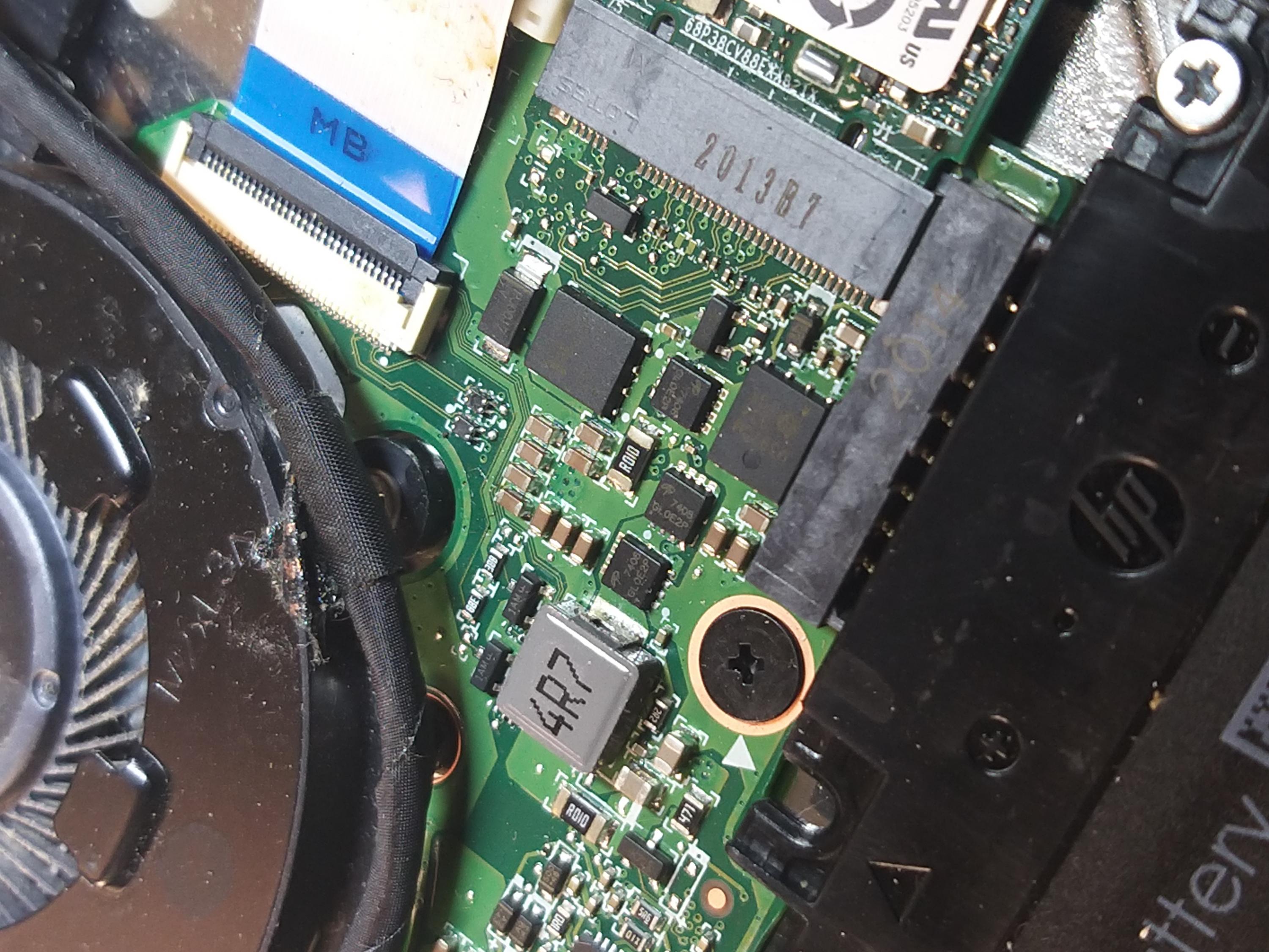

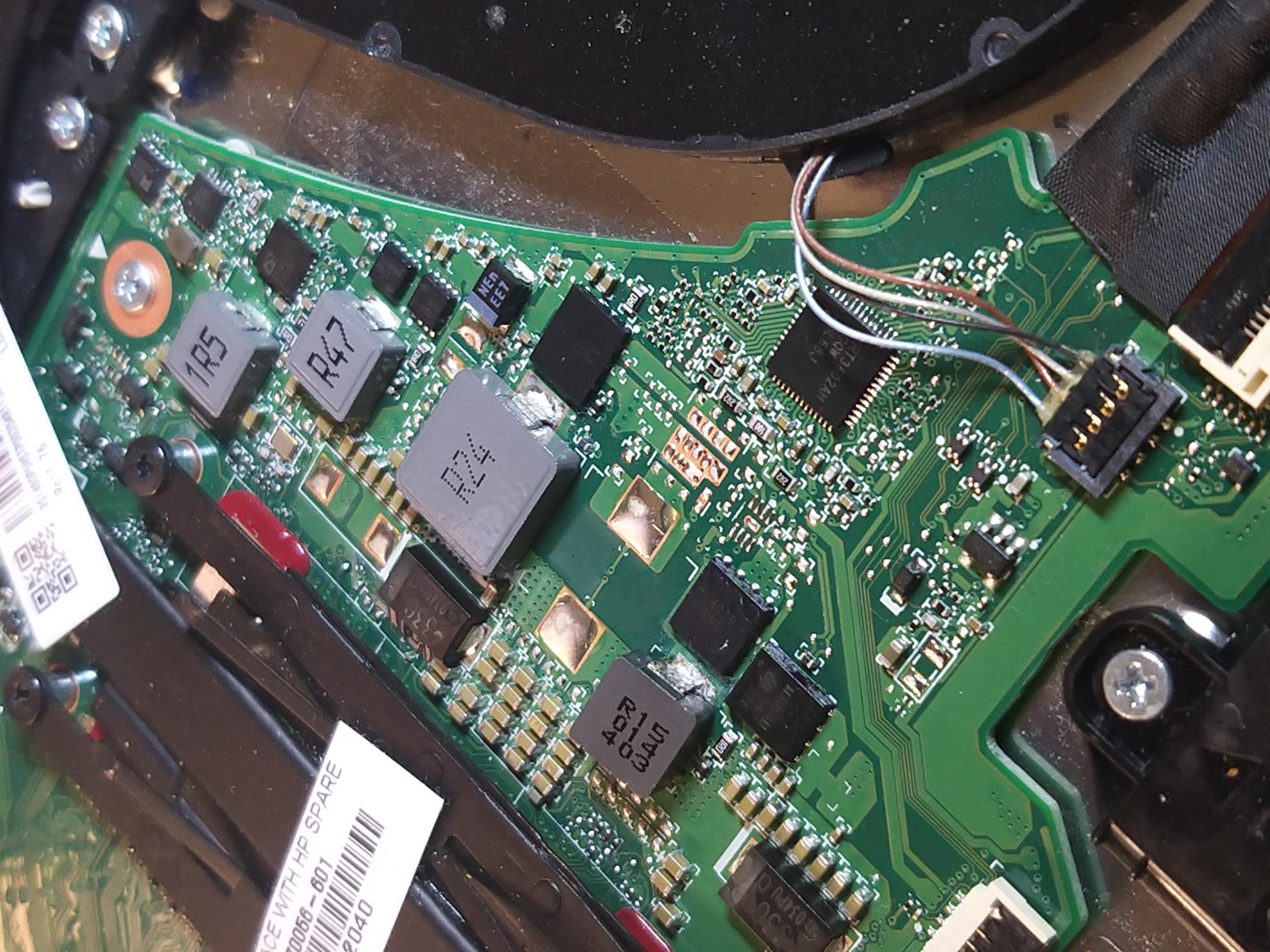

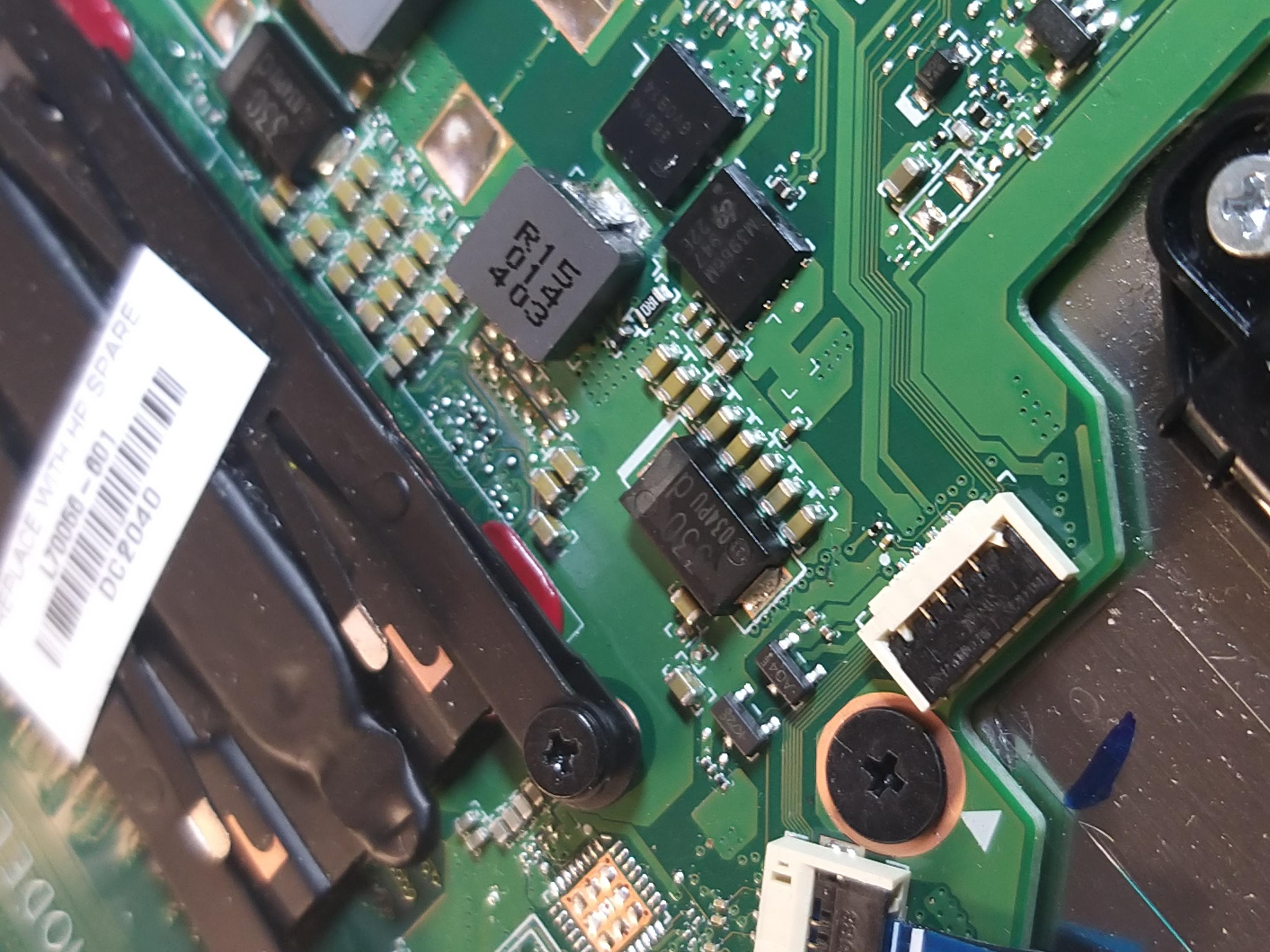

            Re: hp 15s-fq0017na Caps lock blinking 3 slow, 2 fast
            hI,
            here are some photos.Could this problem be caused by the CPU?
              Originally posted by vikivng
              da00p5MB6D0 REV D
              ALL of the following shows beeps on both sides to ground in continuity mode.
              In resistance mode to ground both sides of coil show the following.
              R24=12 OHMS
              1R5=23 OHMS
              4R7=00 OHMS
              2R2=21 OHMS
              R15=18 OHMS
              NO brief pulses of voltage on standby on R15
              1R5 or 4R7-these are ratings for coil/resistor. Does it makes any sense to us. How do i know the coil 1R5 stands for which rail?? Resistance between different coils may vary like hell & heaven,eg, resistance on vcore rail may be 5 Ohms whereas the same rating on ram coil is definitely showing short. So we cant make out anything about ur resistance readings unless u mention the coils are meant for which rail. So please do the home work properly and we'll try to help you as far as possible.

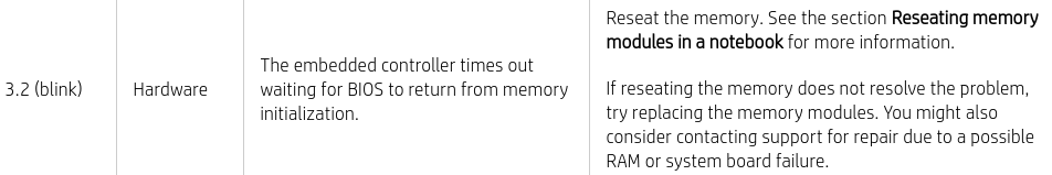

                  Do not know the solution but the caps lock blink sequence relates to memory and BIOS:
                  The embedded controller times out waiting for BIOS to return from memory initialization.
