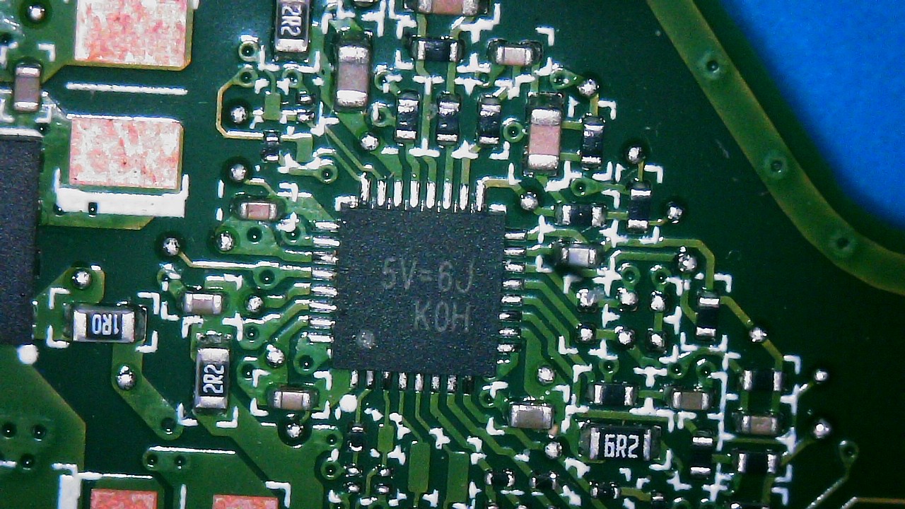

    Help with HP DA0P5DMB8C0 IC component identification
    Laptop: HP 15-dy1074nr
    Motherboard: DA0P5DMB8C0 REV:C
    IC marking: 5V=6J K0H
    I can't seem to find schematic for this motherboard.
    From now, thank you for you help
    The problem with this Laptop is that it does not detect the charger, in ACDET I have only 2V, and in the power supply I have a consumption of 0.000A

    Re: Help with HP IC component identification
    usually acdet circuit have a voltage divider connected to dc in (19.5) and ground. Chcek the resistors.
      No schematc, but the IC is a Richtek RT3612EB
        Are you looking for the Charging Controller? This Richtek isn't it. Common Brands are Texas Instruments and Intersil/Reneseas
