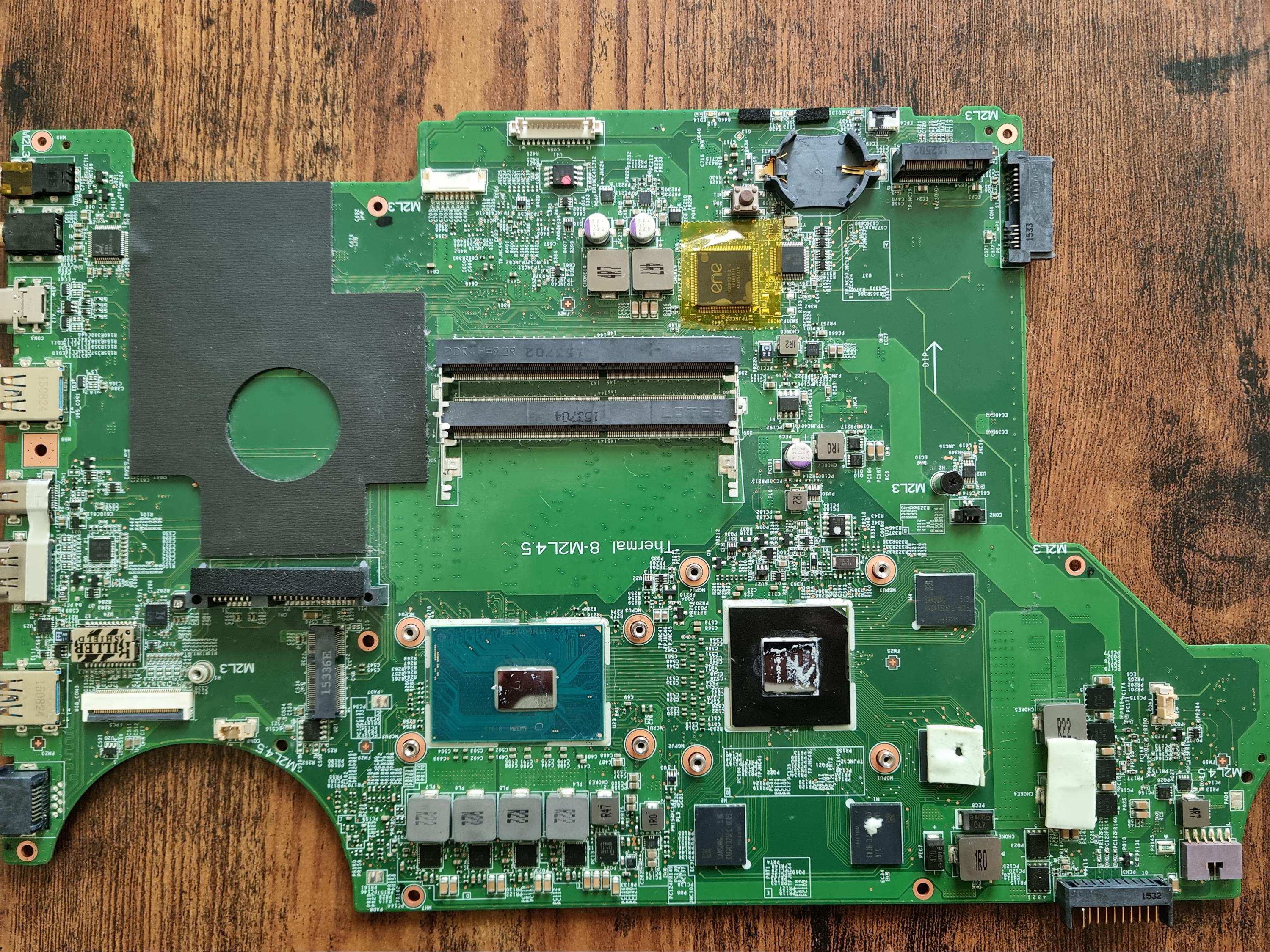

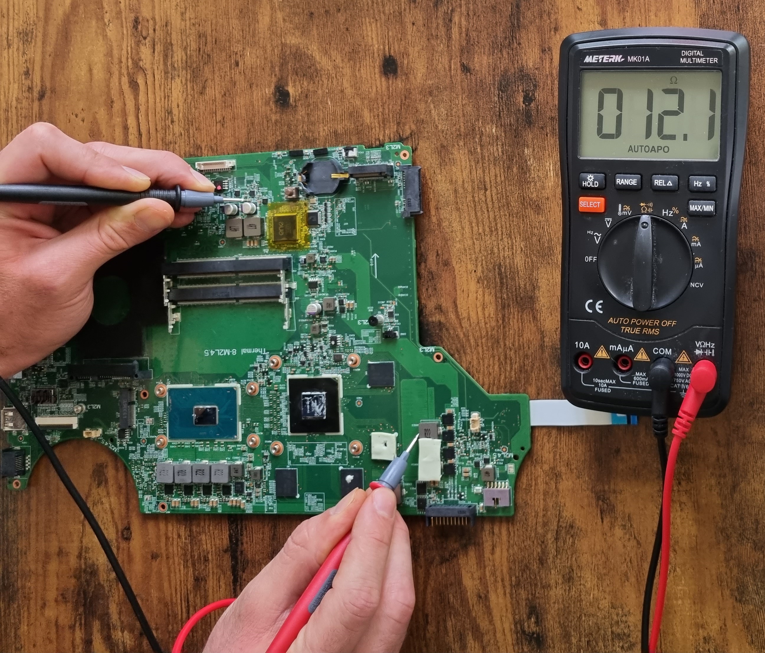

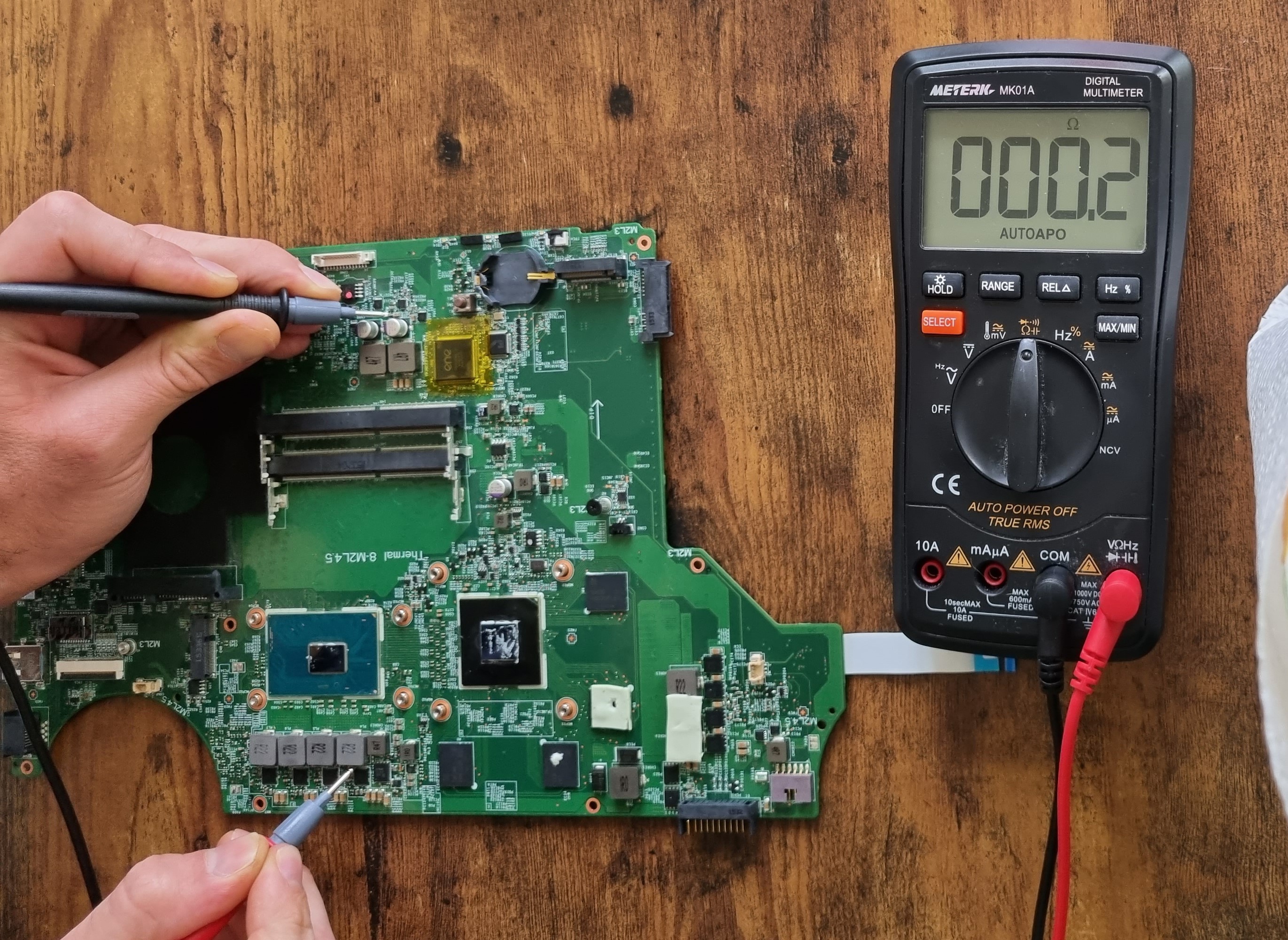

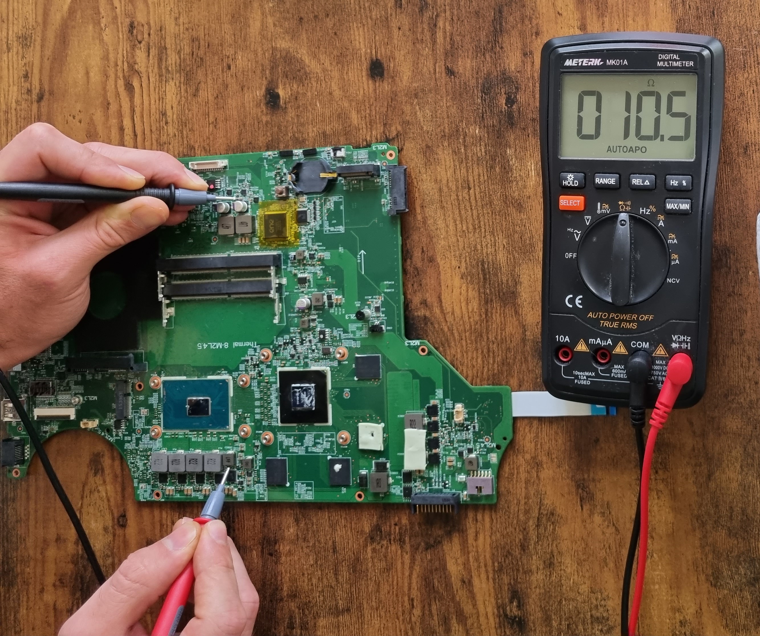

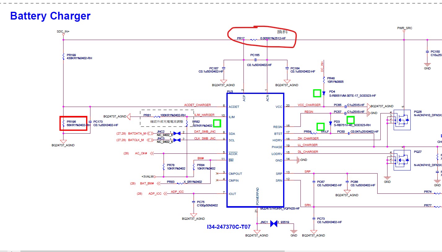

    I am currently learning to repair laptop motherboard and I need some advice/help.

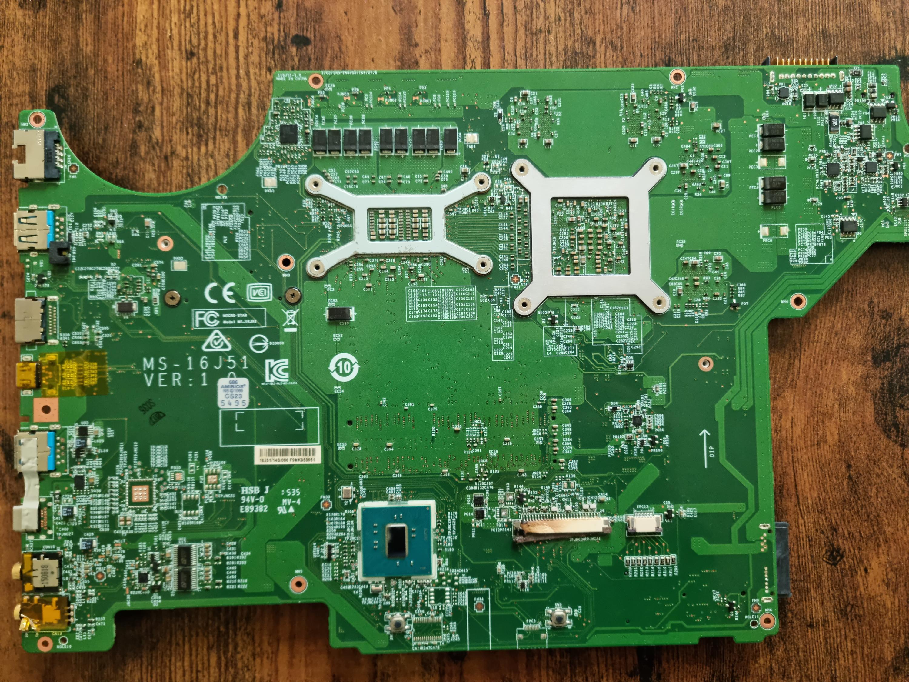

    I have a MSI GE62-6PQ laptop that didn't boot. It's an old laptop that got a glass of coke :/
    I have cleaned the motherboard with isopropyl alcohol and a brushteeth.
    The motherboard is a MS-16J51. I put the schematics attached.
    I also attach high res pictures of the board.
    Symptoms :
    When I connect it to the power supply, it goes into protection.
    What I have done :
    Checked the fuse : OK
    Visual check OK : No burned components

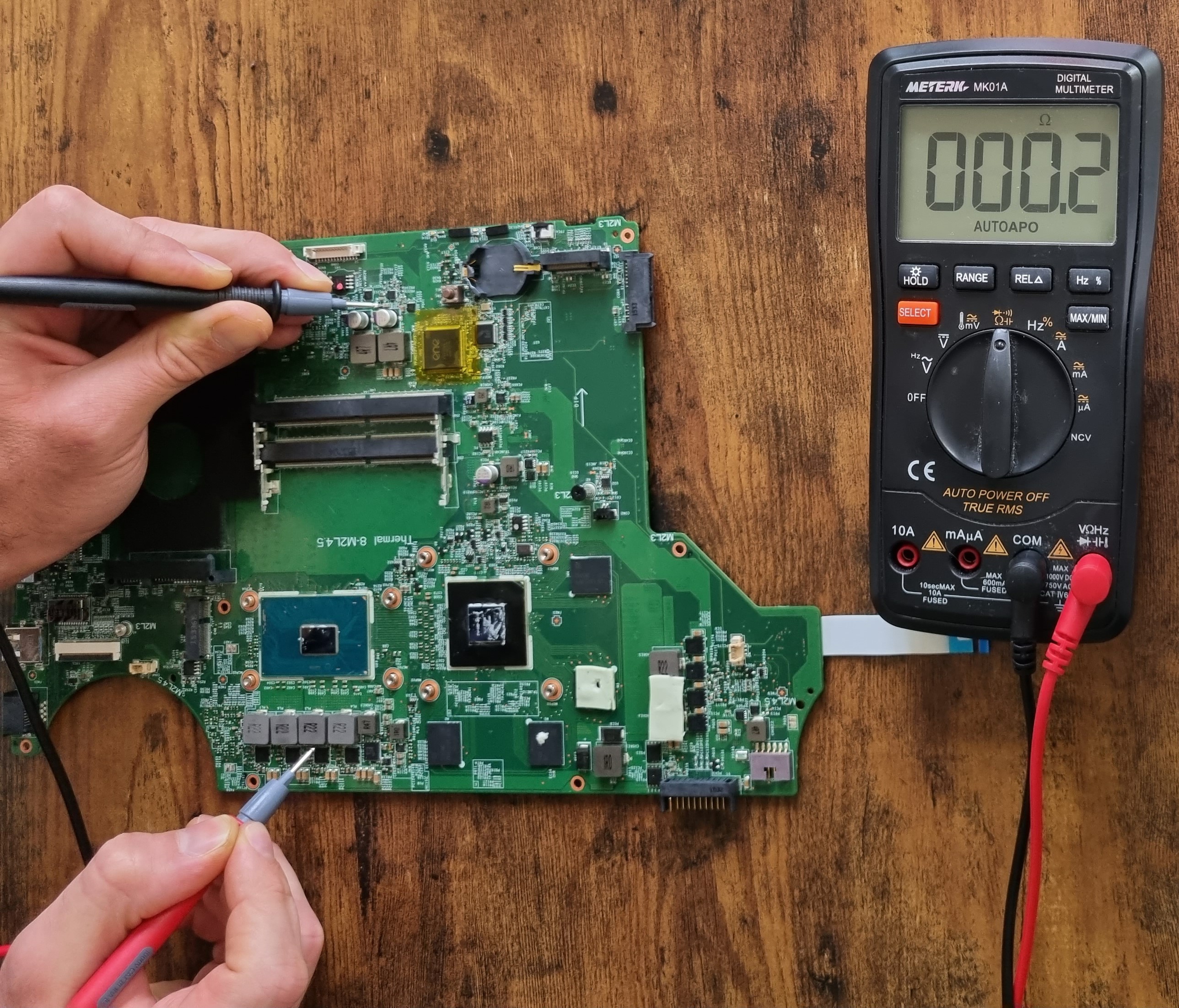

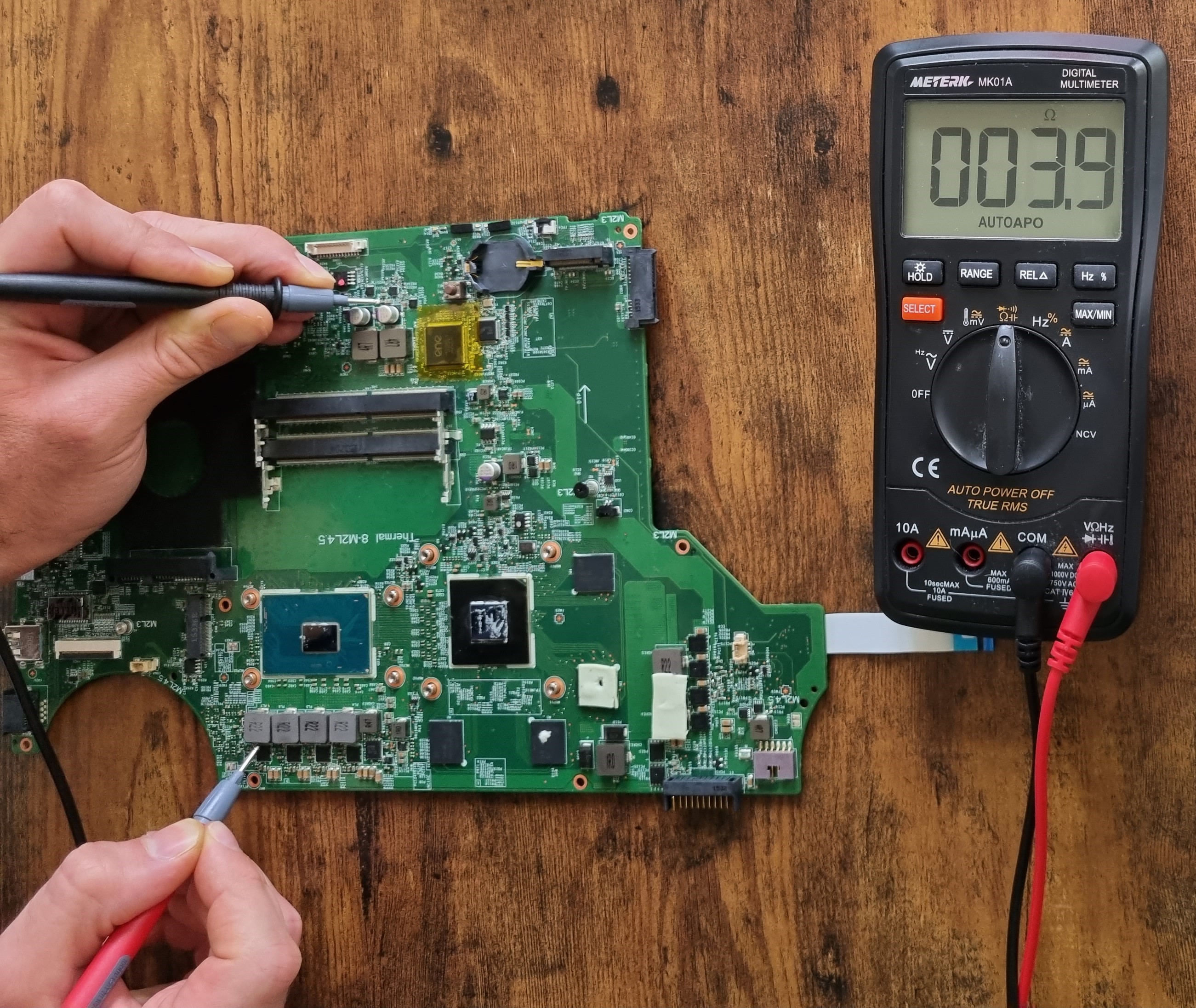

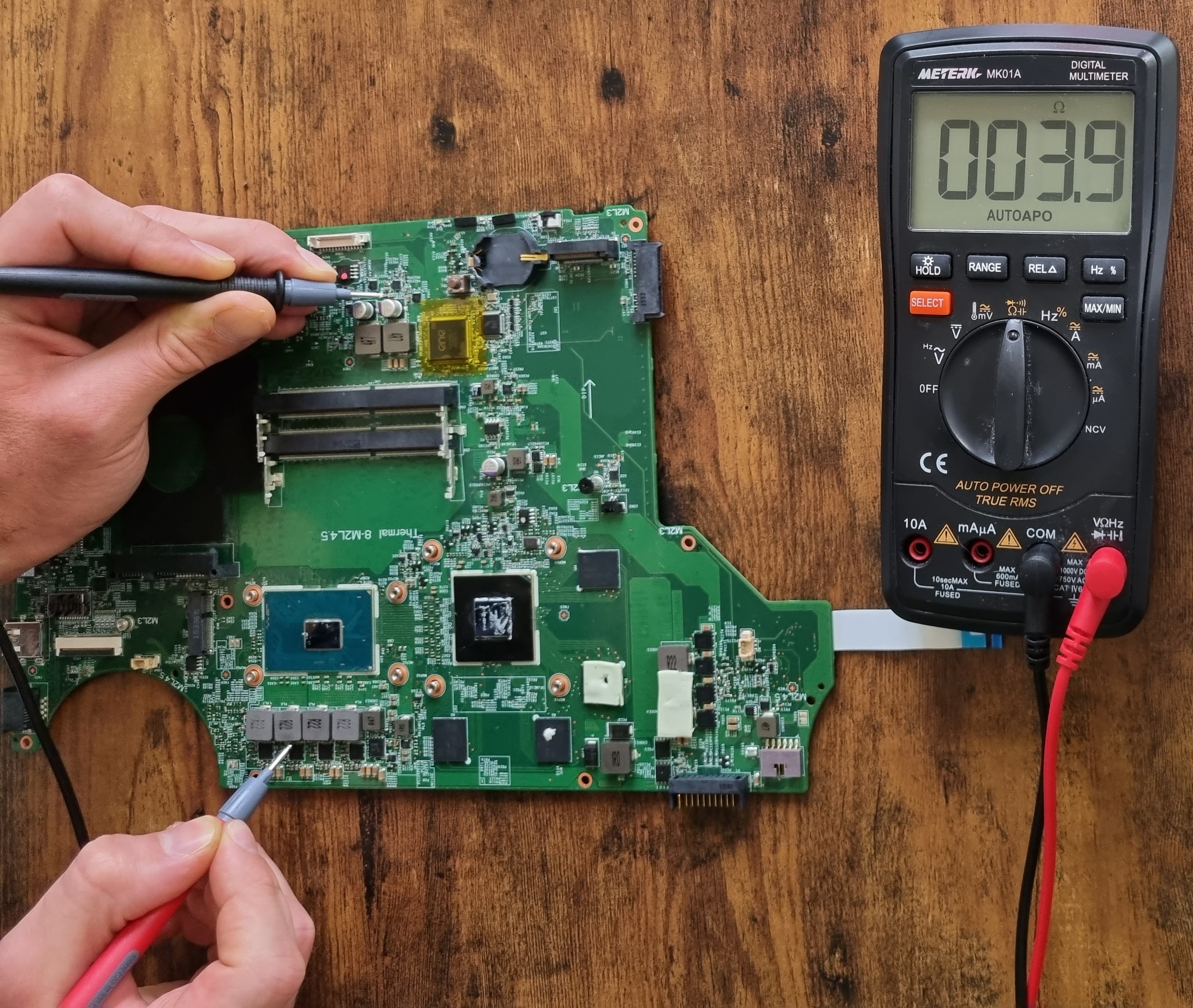

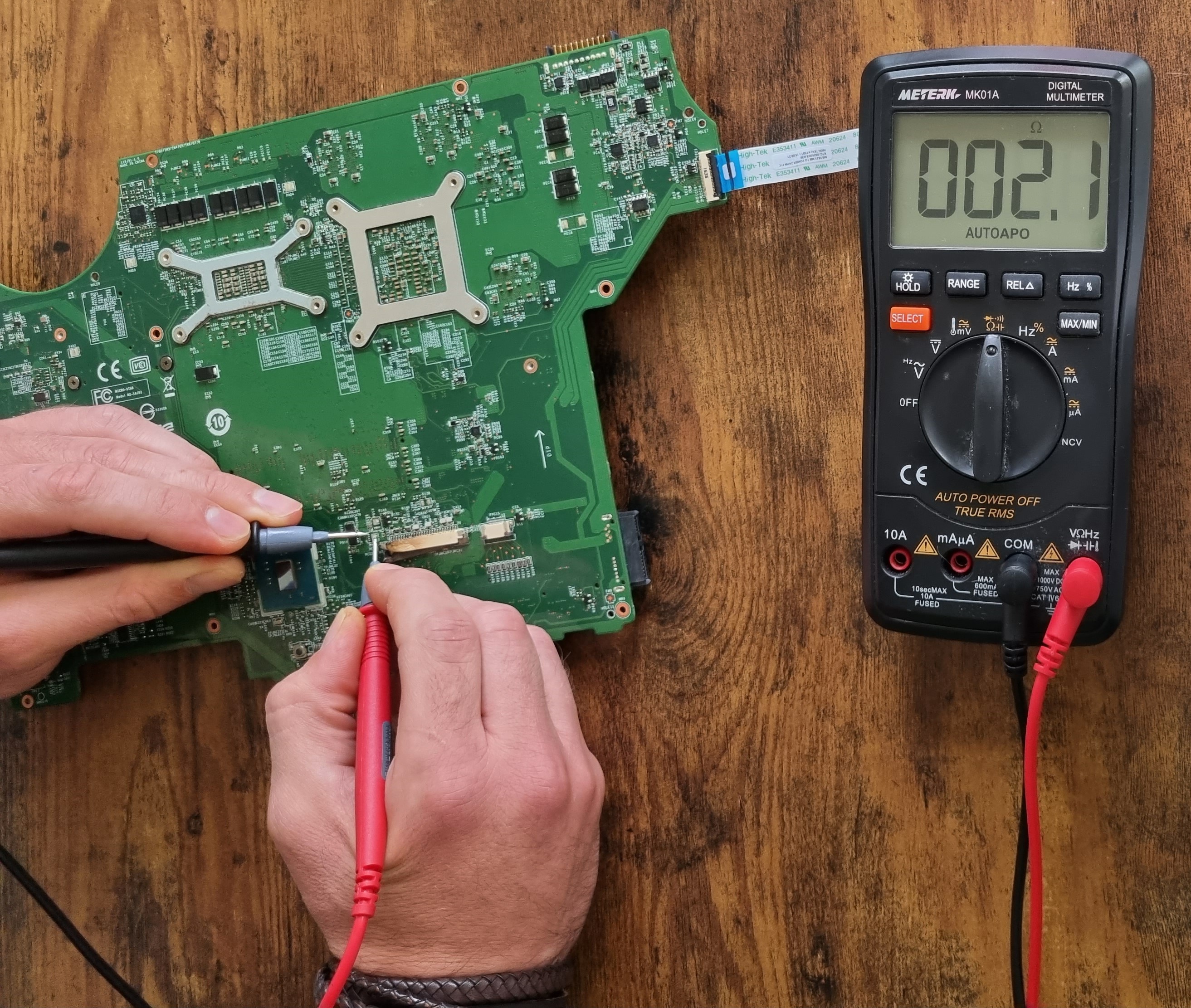

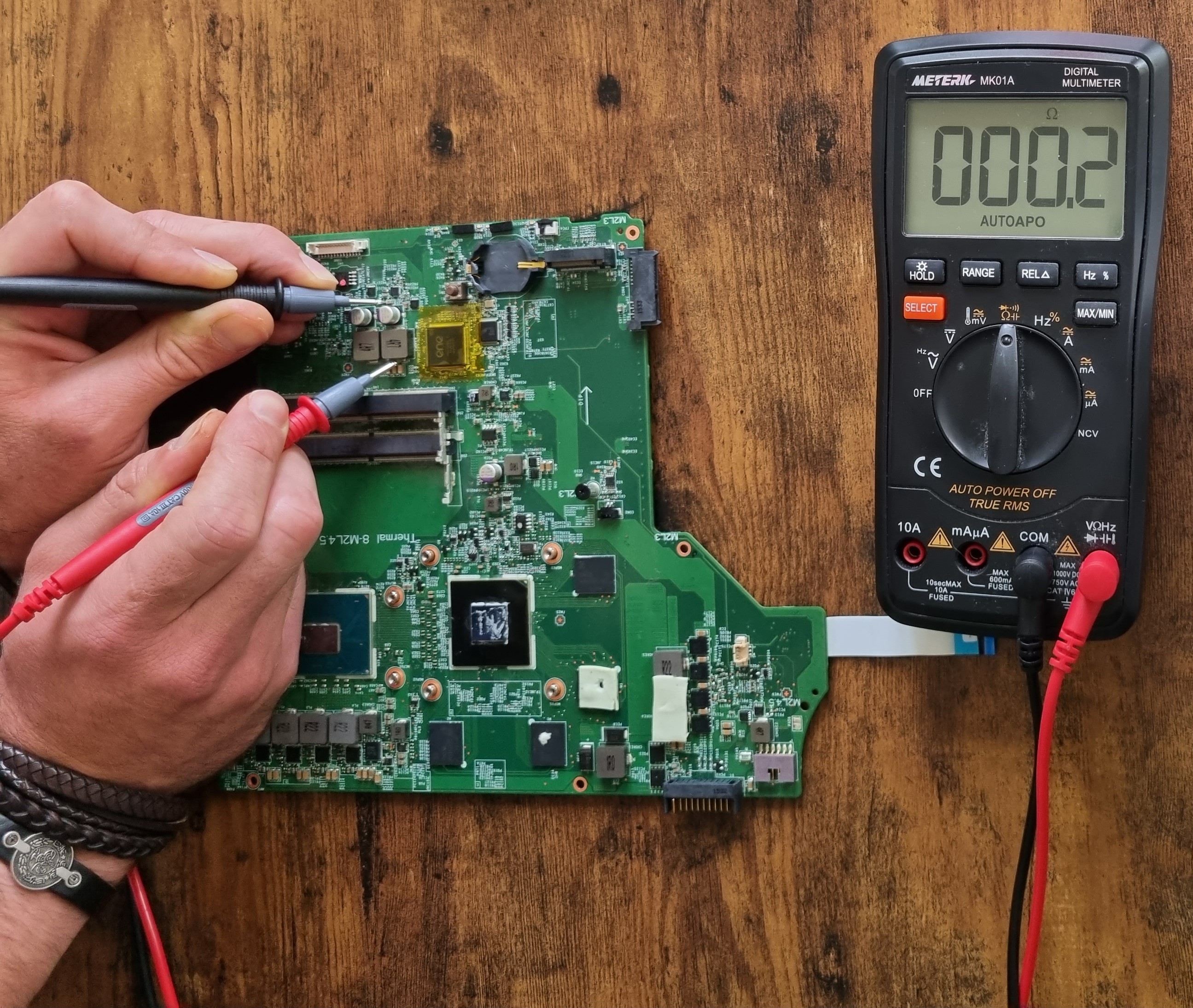

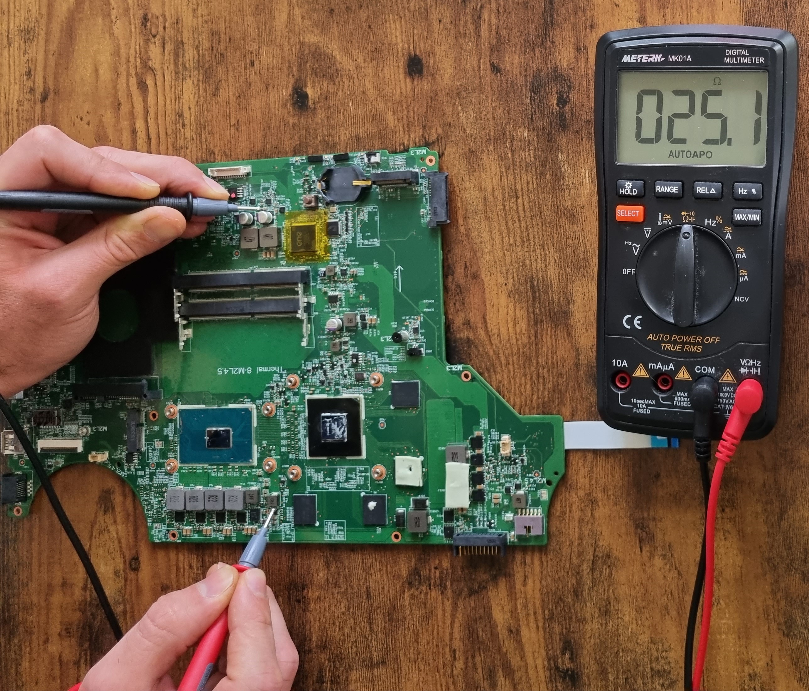

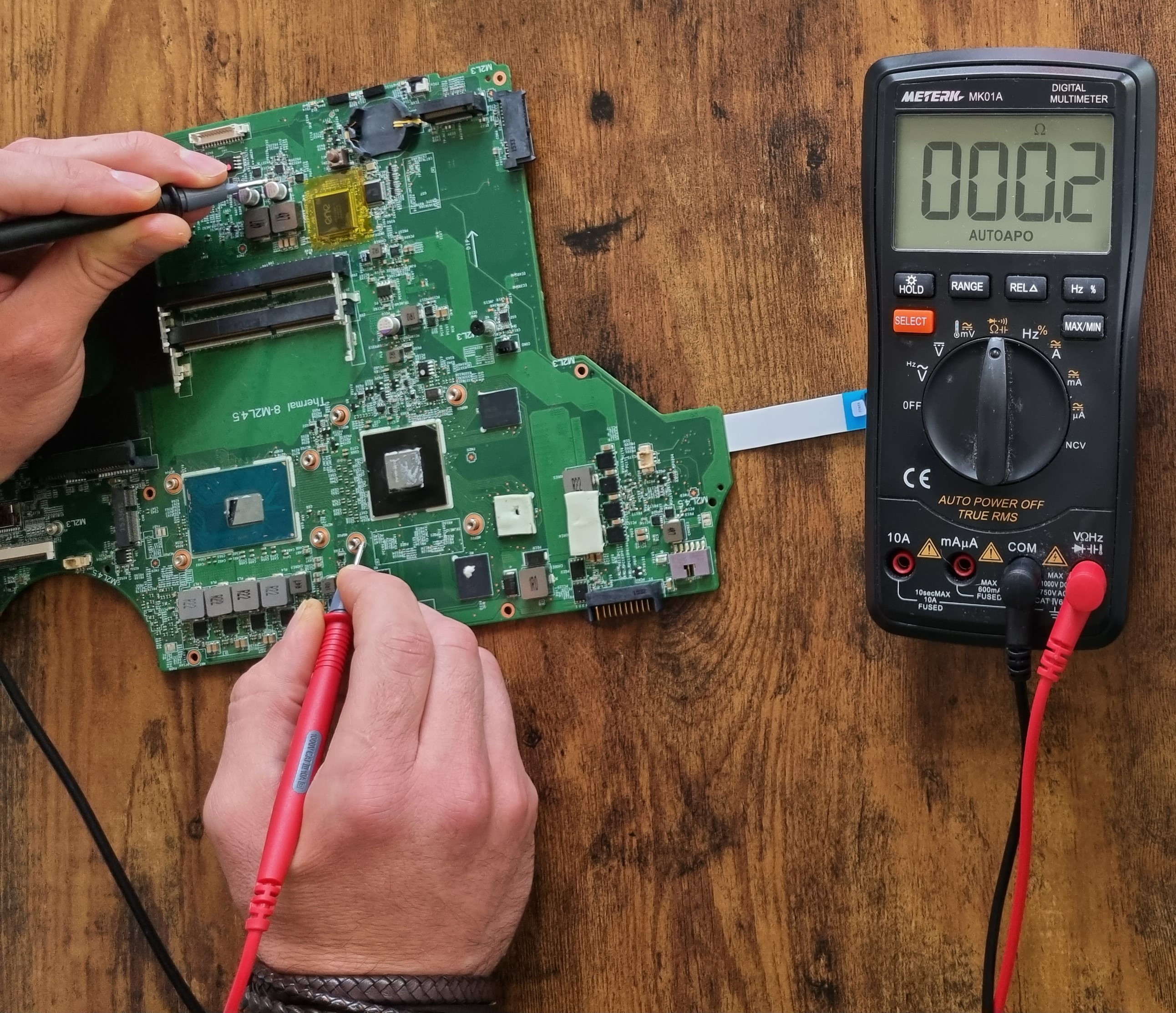

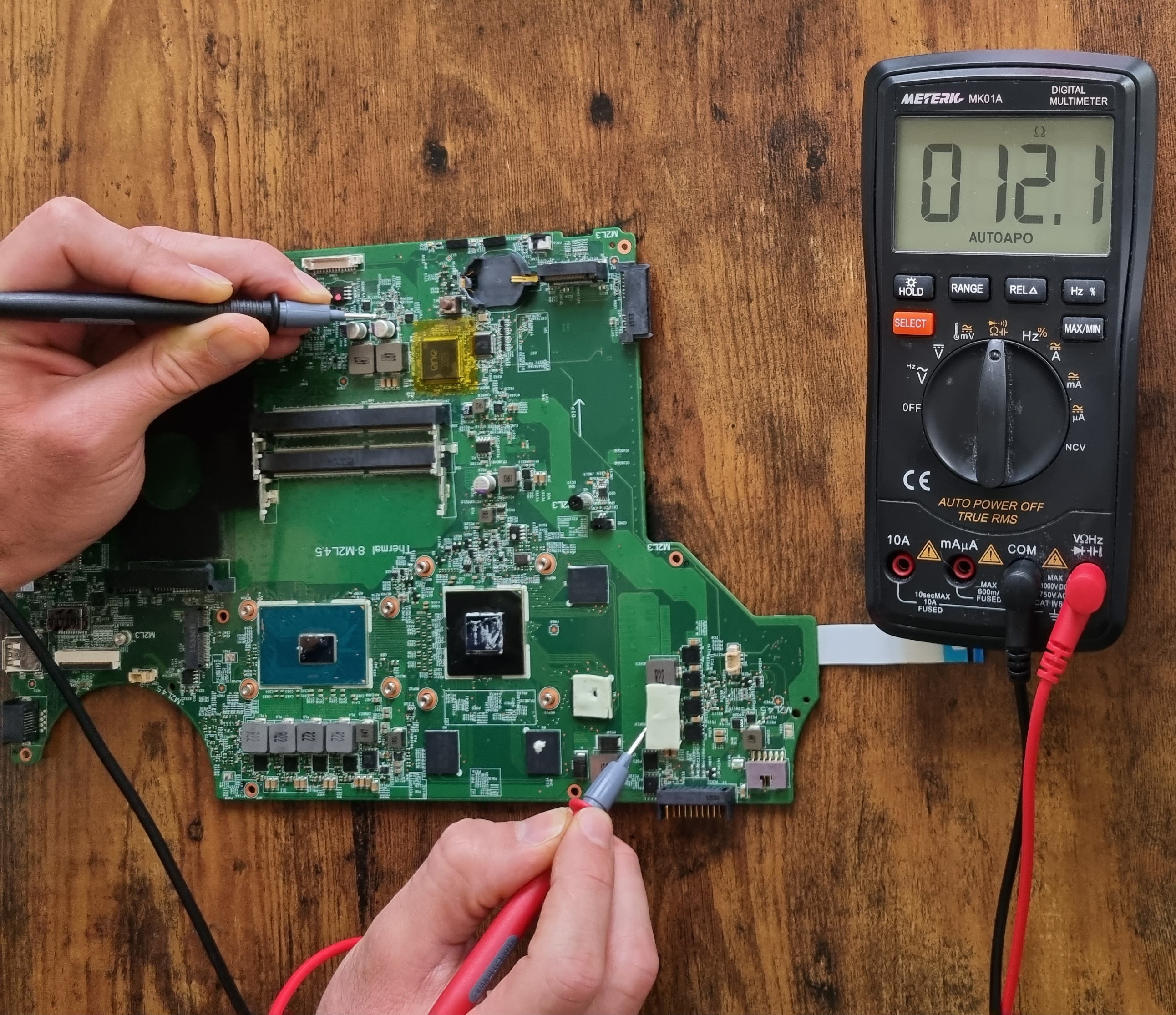

    I have measured the resistance between PWR_SRC (main rail) and GND : 0.2 Ohm
    The main rail is shorted, but where

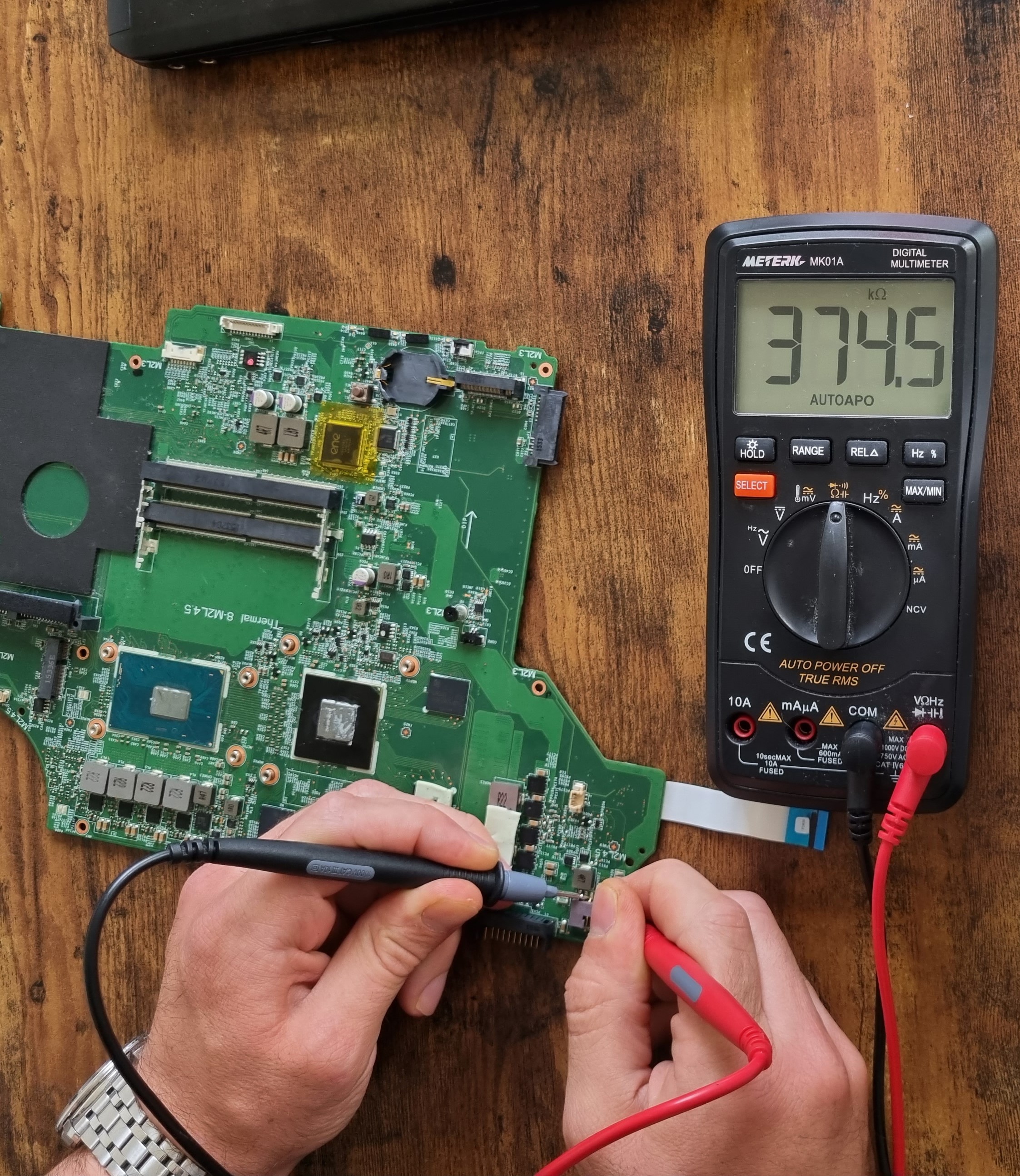

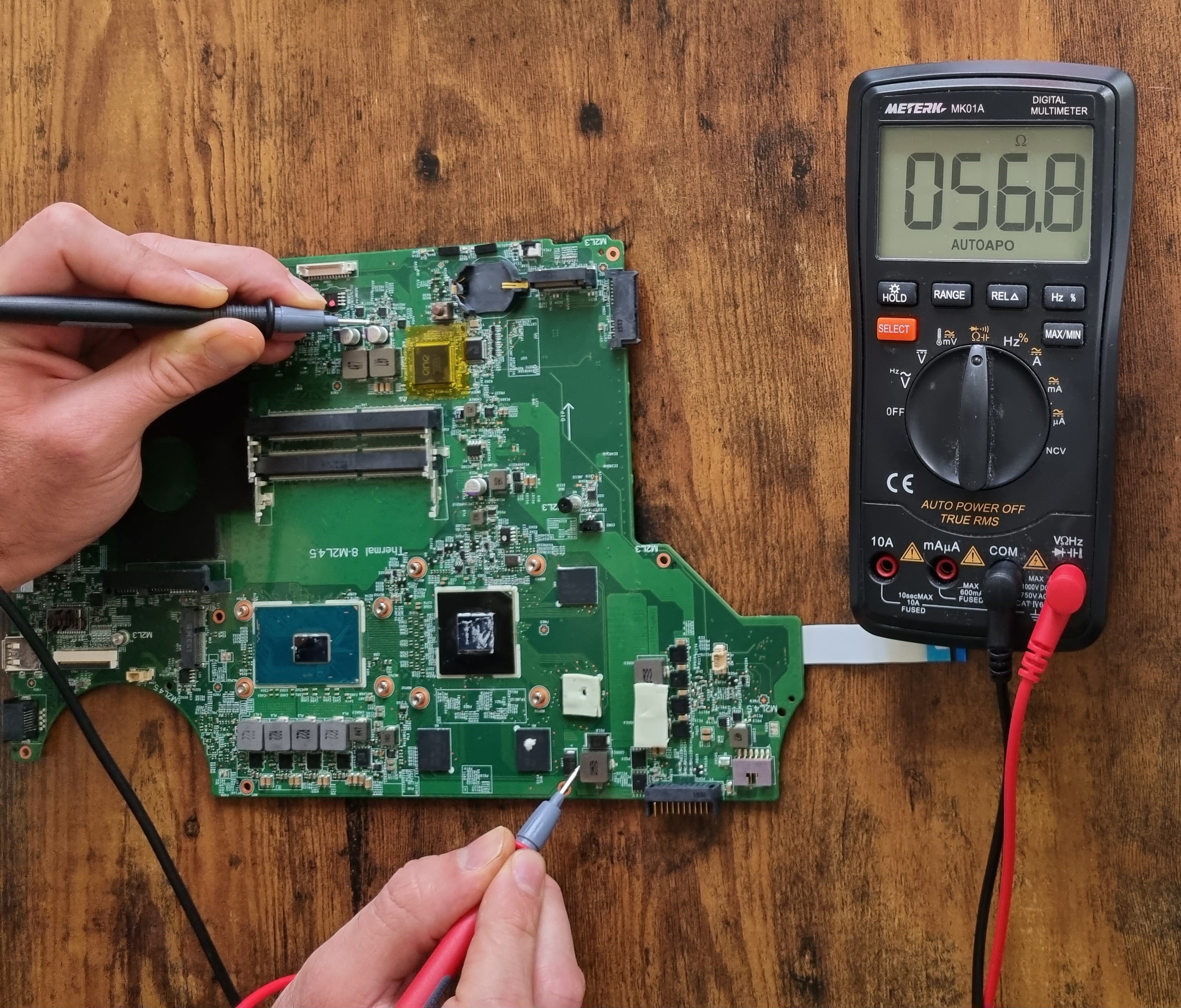

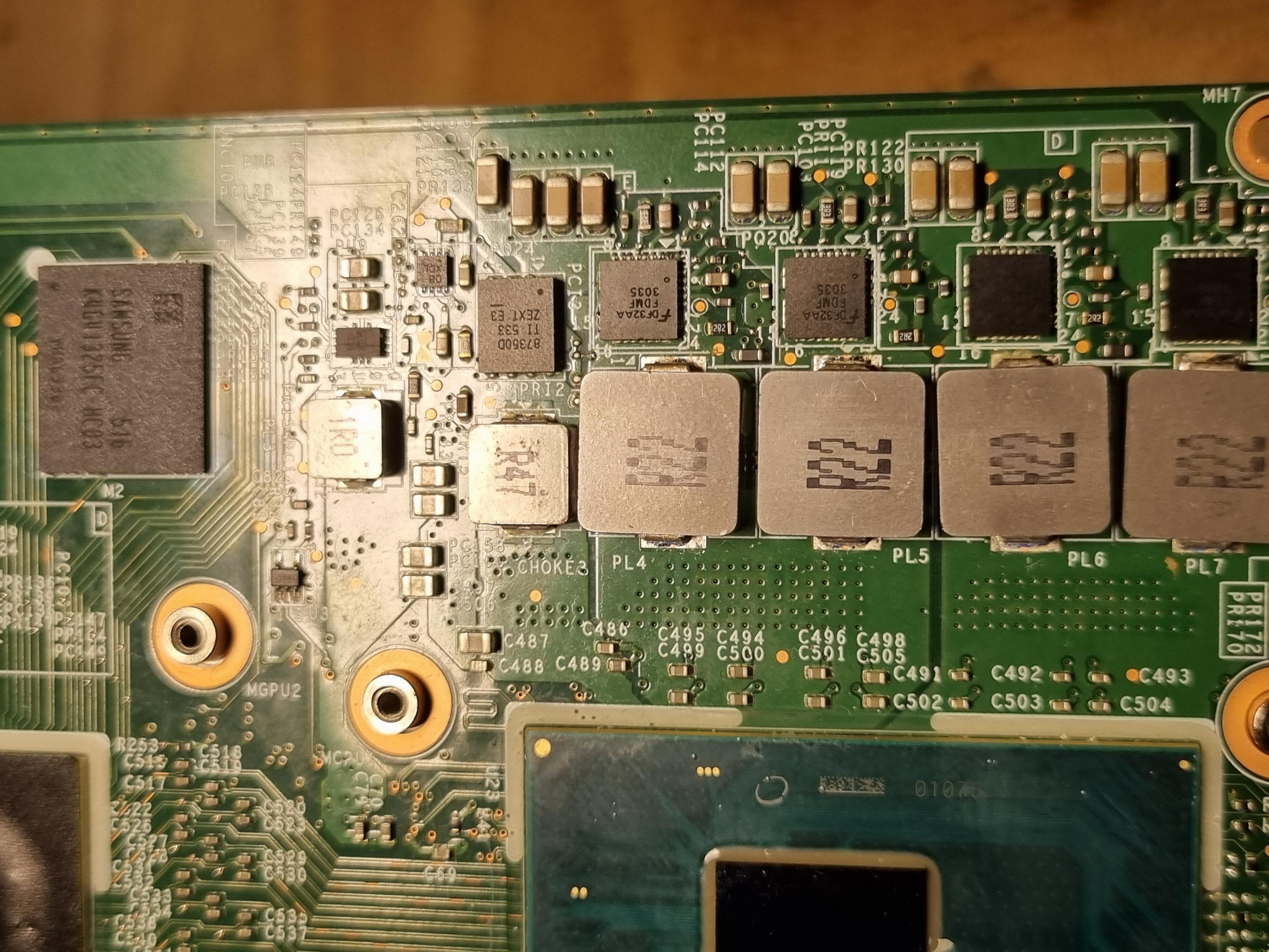

    The resistance between PWR_SRC and CHOKE9 (5V rail) was very low (<1ohm), so I have measured the resistance betweend source and drain of MOSFETs PQ13 and PQ15, both shorted. So i removed them. But the short is always here
    You can look at page 40 of the schematics
    I have tested the MOSFETs separatly, they seems OK.

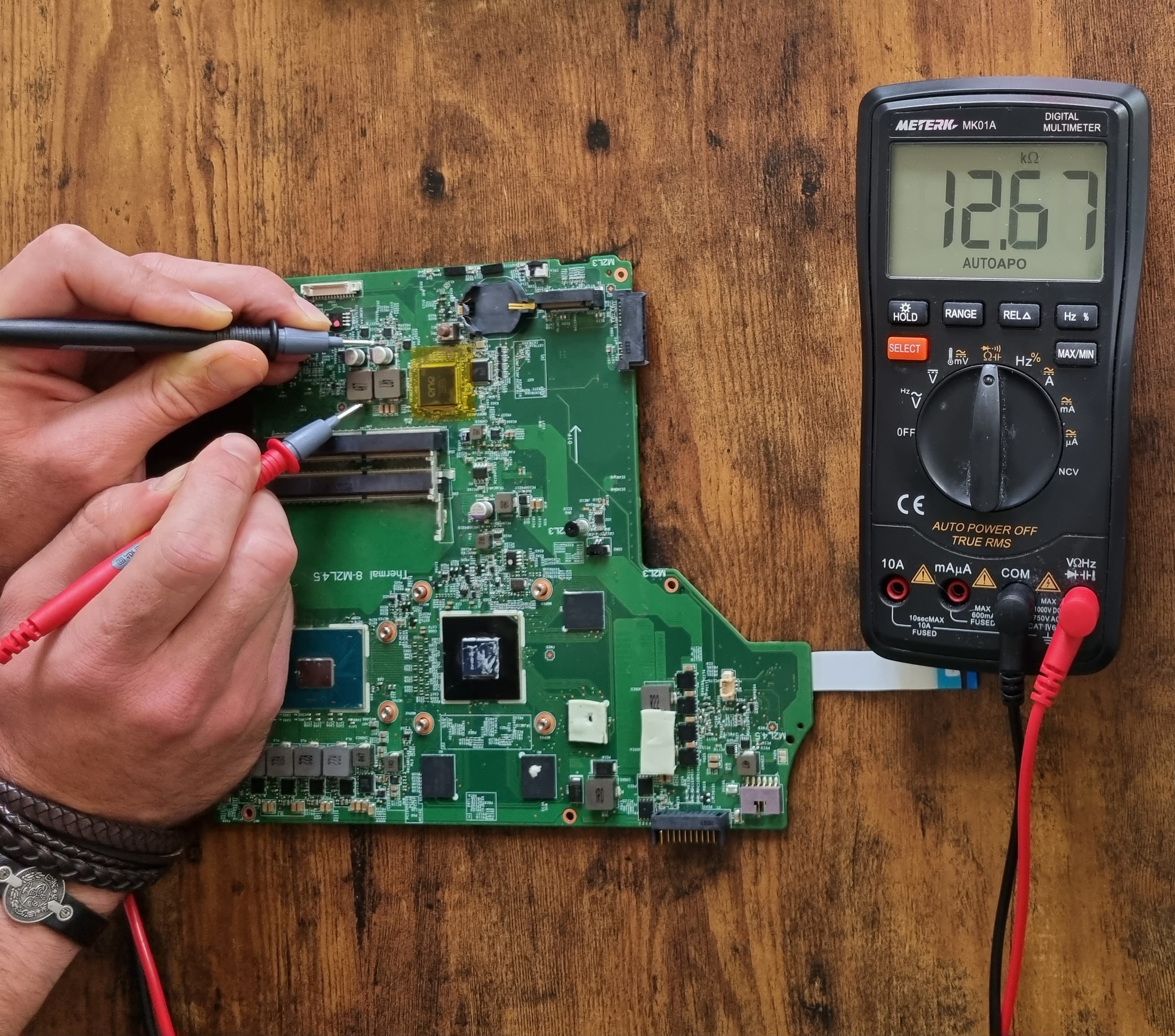

    The resistance between PWR_SRC and PL4 and PL5 are very low too. I think there is also a short near the CPU power. But I want to resolve the short on the 5V rail first
    The others mesurement seems OK
    What can I check to find this ***** short ? Any help/advice appreciated

    Re: MSI GE62 Laptop Motherboard with Short on main power rail
    When power supply goes into protection, its your +19V rail which is shorted. Locate the CLR after 2 dc-in mosfets and remove it from the mb. Measure resistance on both pads of CLR(after removing it. One side will show short to Ground. Inject +1V/1A with dc supply and gradually increase AMP(not Voltage) upto 5Amp and find out what is getting hot. However, if you inject more then 1V/5A , then there is risk of onboard CPU/GPU getting shorted if one of the high side mosfet is leaky/shorted on cpu/gpu rail. So try the above steps and report back.
      Hello, thanks for help
      I am not sure about the CLR you talking about. Is it PR17 ? 0.005Ohm resistor
      See image attached
      • mon2
        • Dec 2019
        • 14838
        Yes, PR17.
        CLR = current limiting resistor.

          OK, thank you, gonna desold and try with a power supply

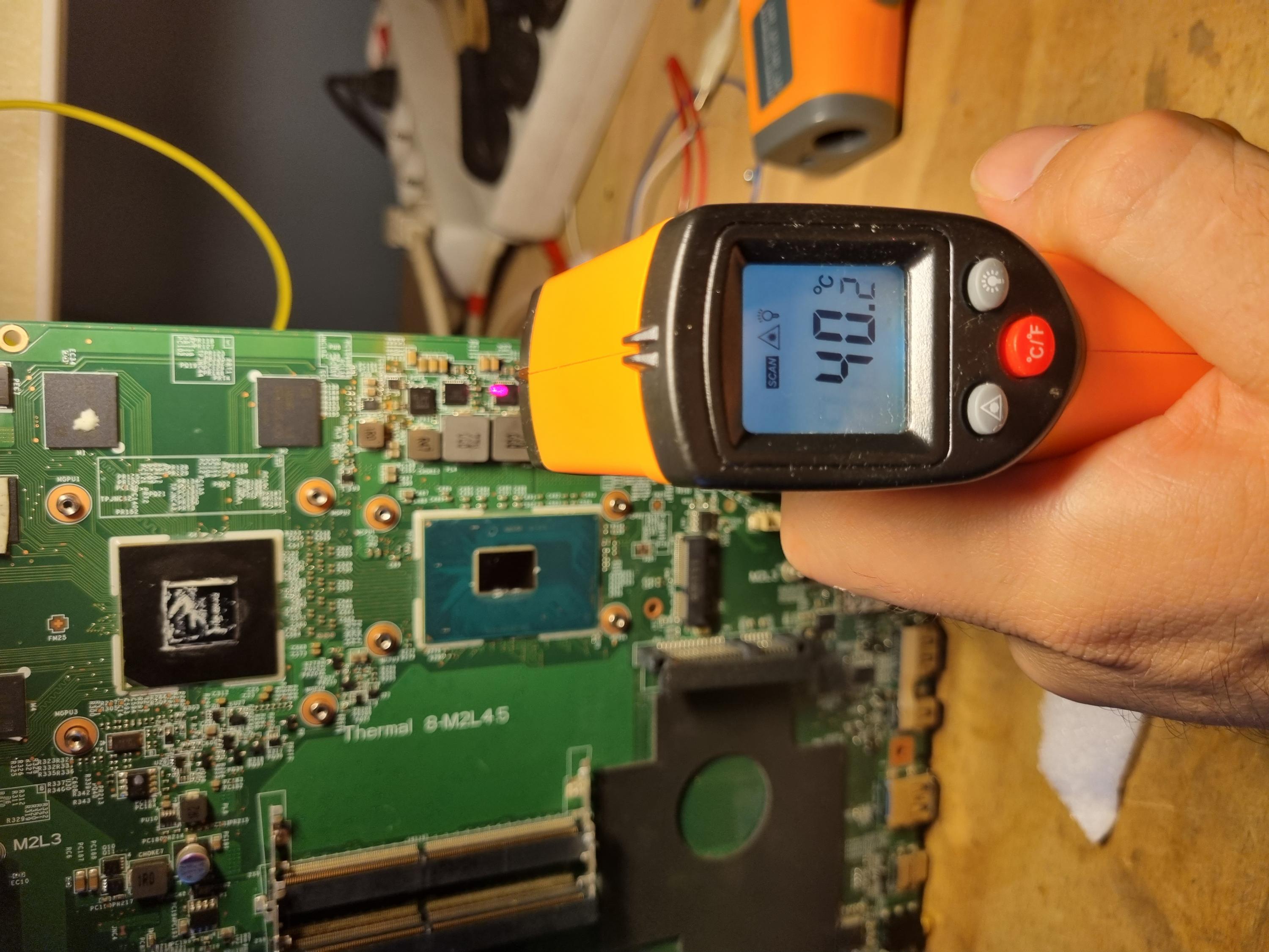

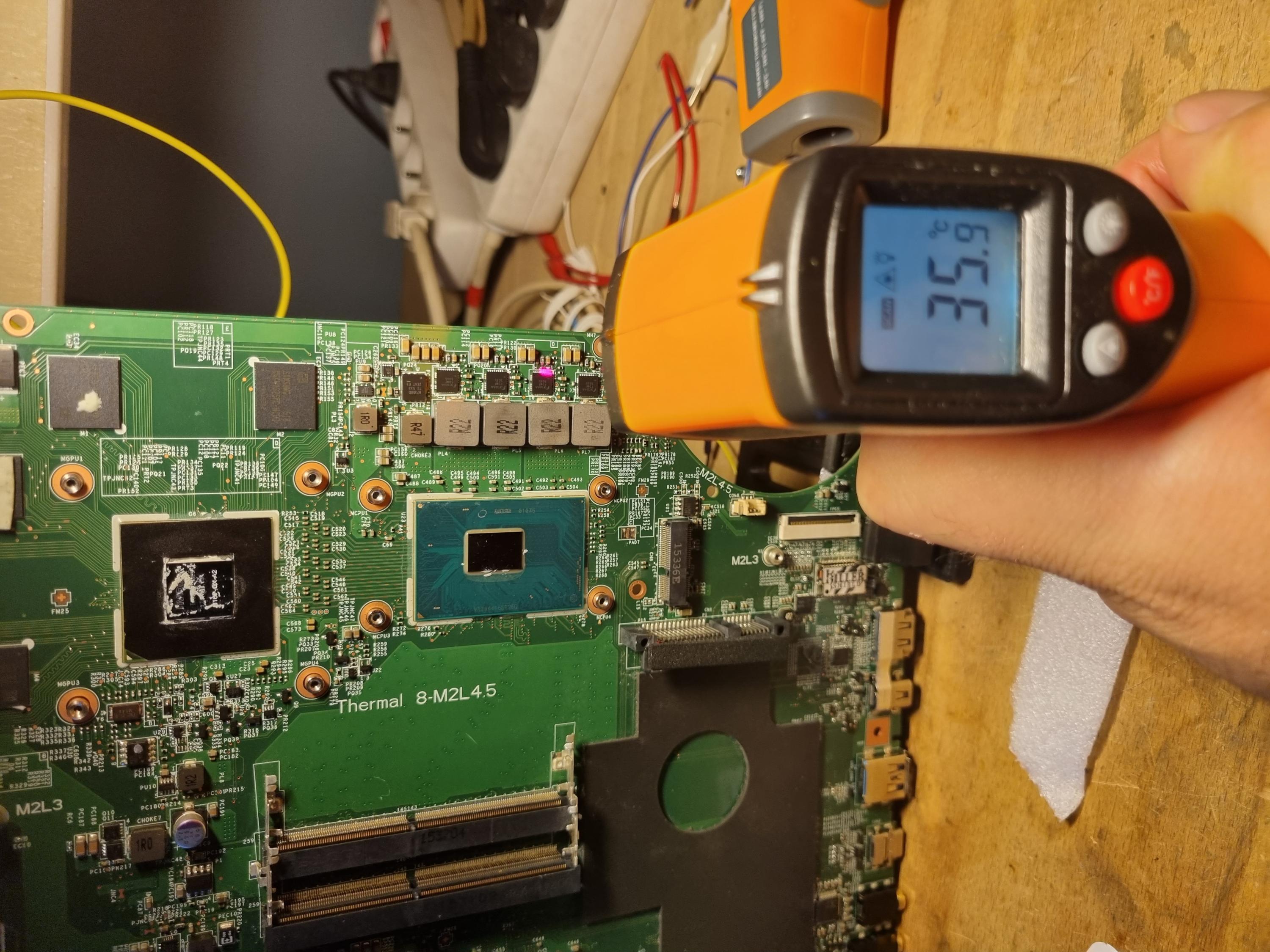

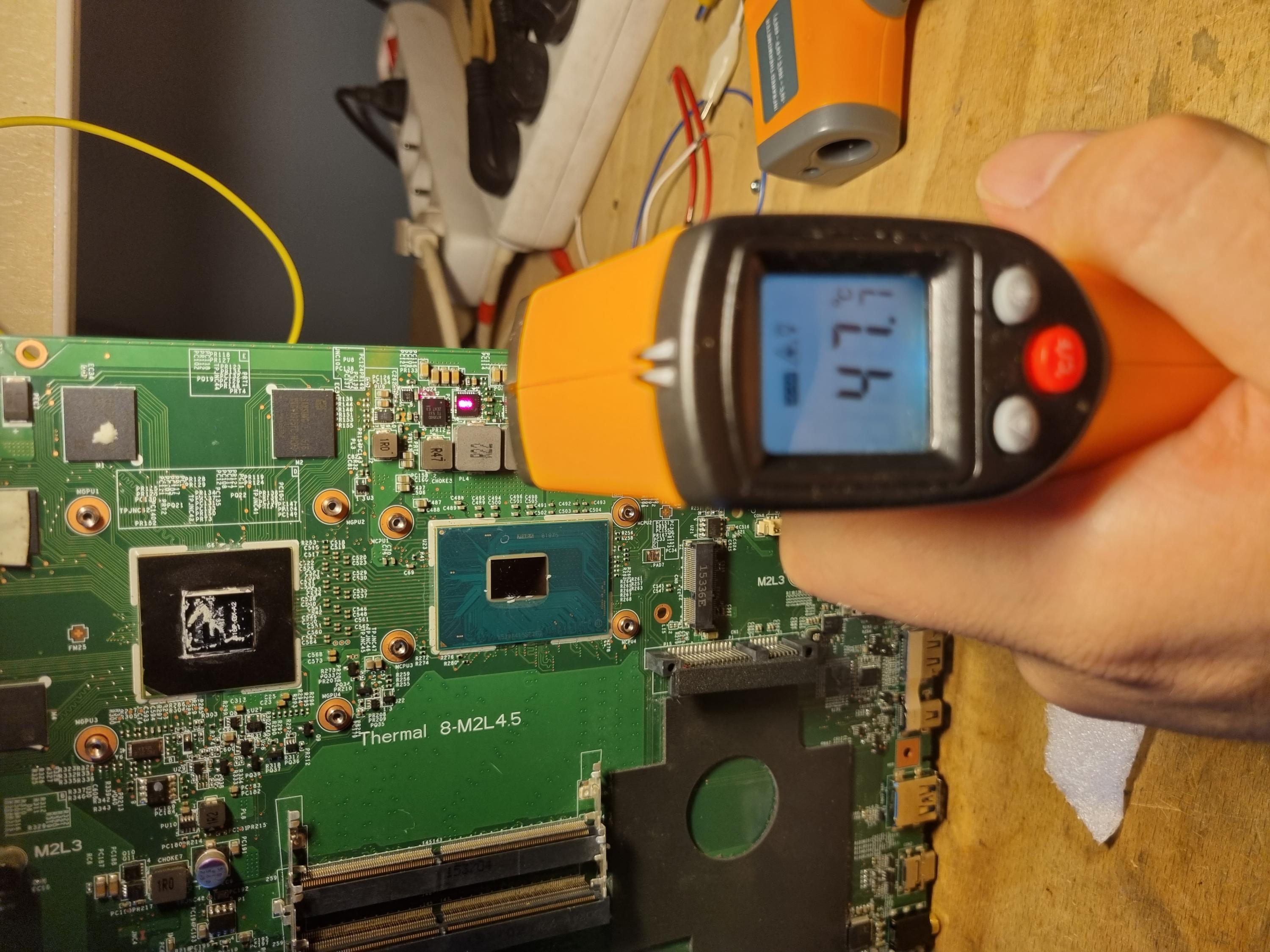

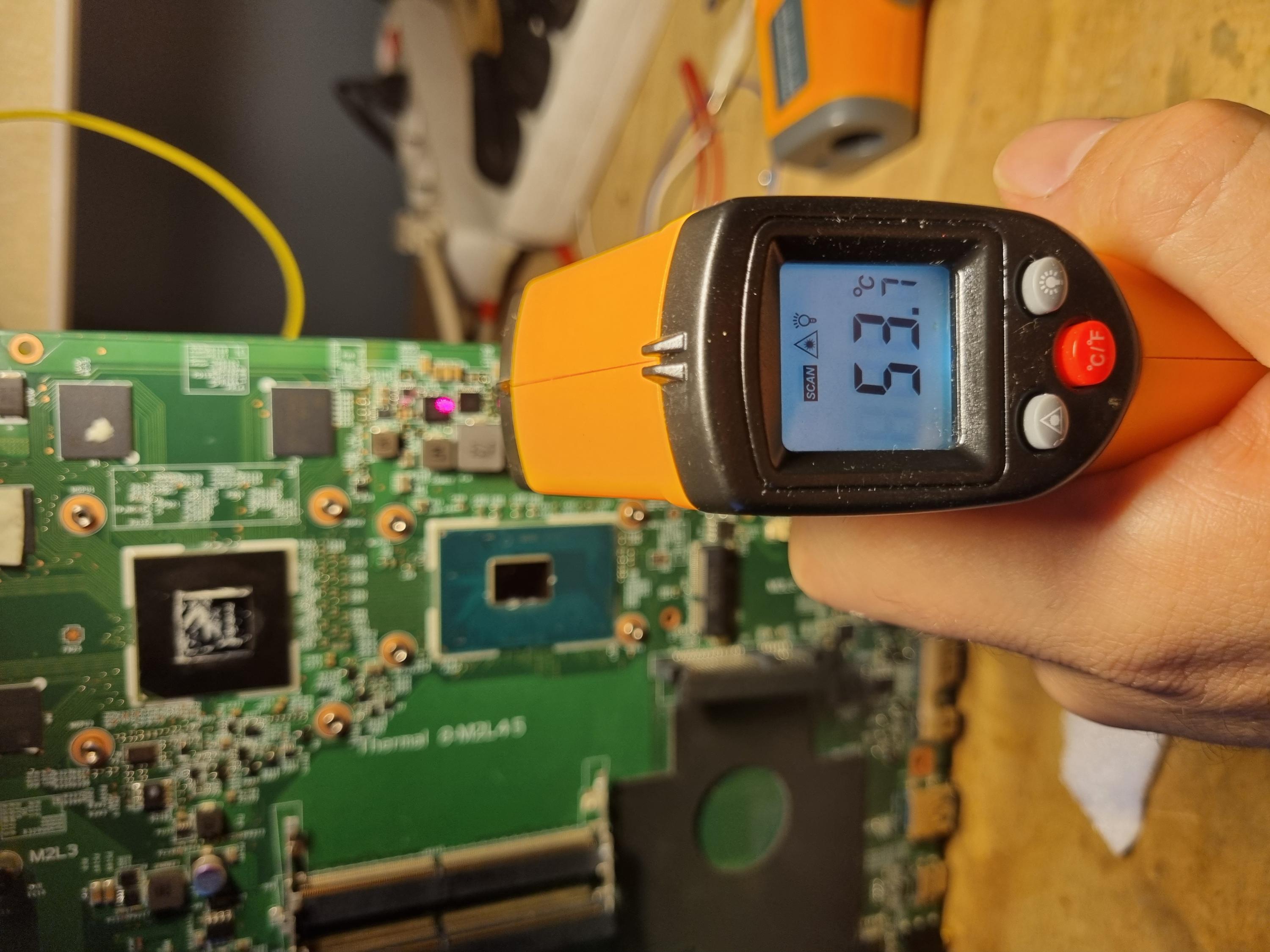

            OK I have injected current on main rail. 1.1V but with 3A because supply can't do more.
            I have searched for hot zone on the mainboard.
            I have found one place that became very hot near +VCCSA mosfet PQ24.
            The mosfets from +VCC_Core were hot too.
            I think to desold choke and capacitor on these rails to see if the short gone.
            Am I right ?
            Any better idea ?

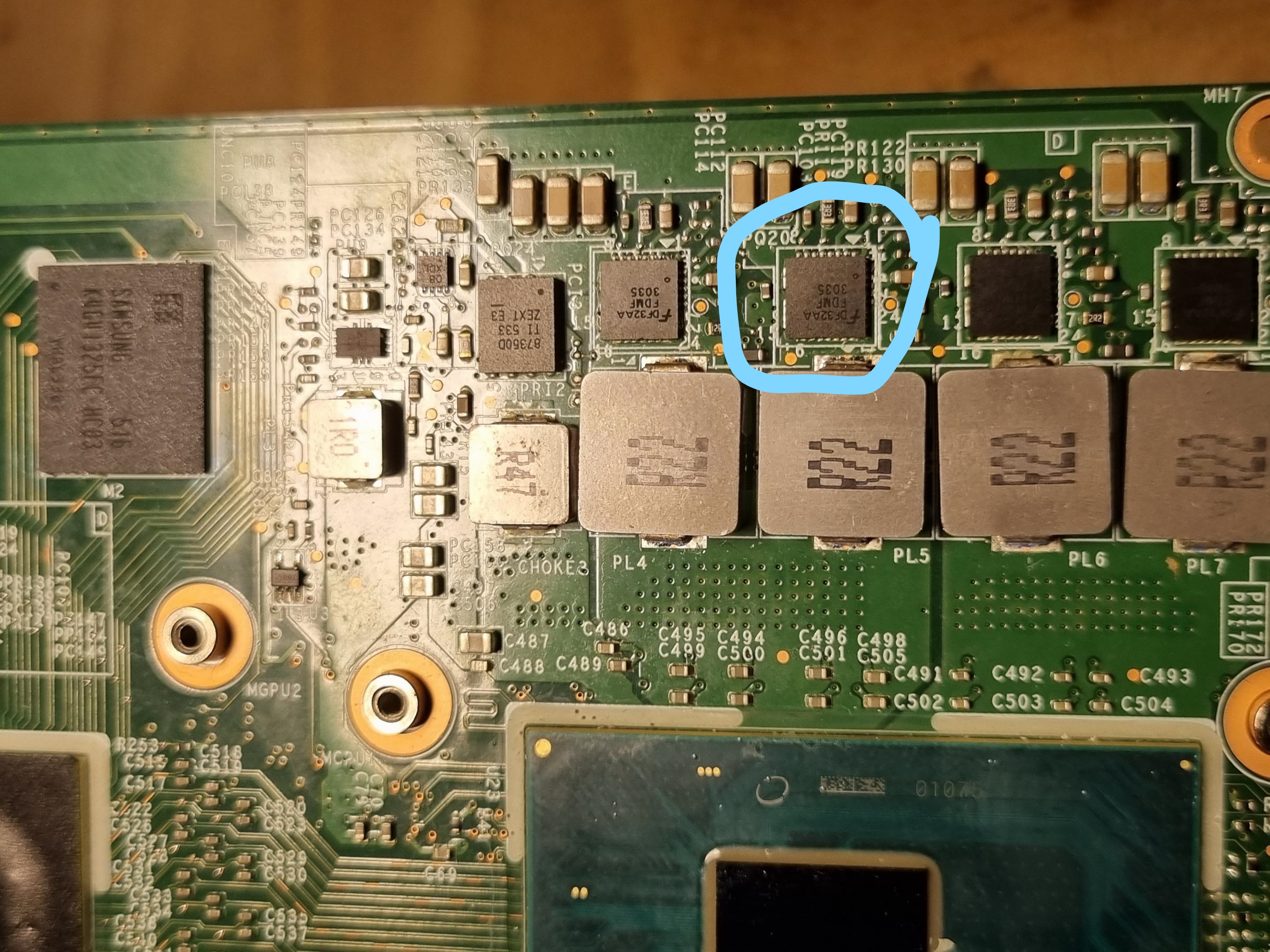

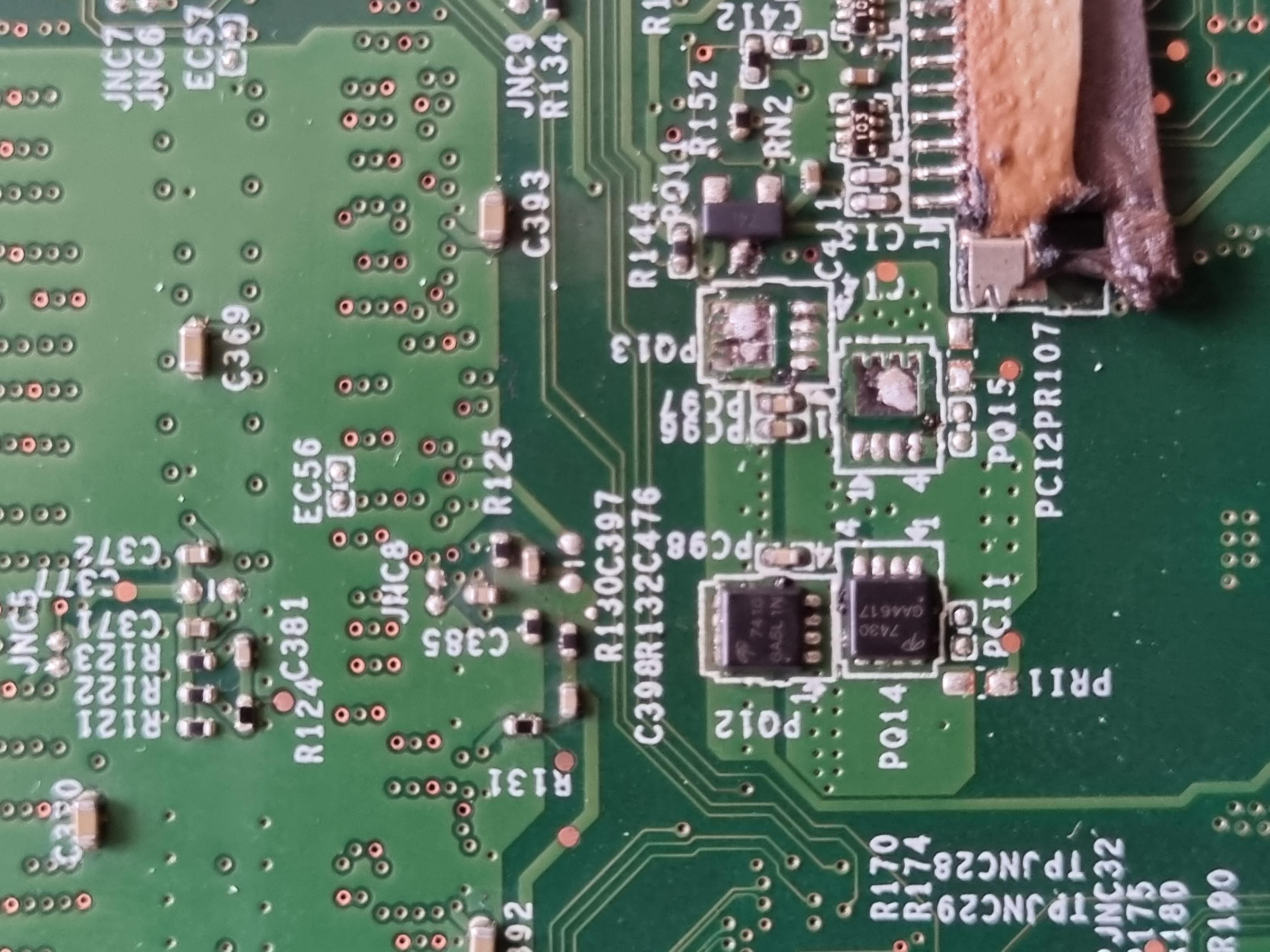

              Hello
              After removal of chokes, I have found the PQ20 MOSFET was shorted.
              I have removed it, and I have now 3kOhms between pwr_src (19V) and gnd.
              I will replace it and see what happens when I put DC IN

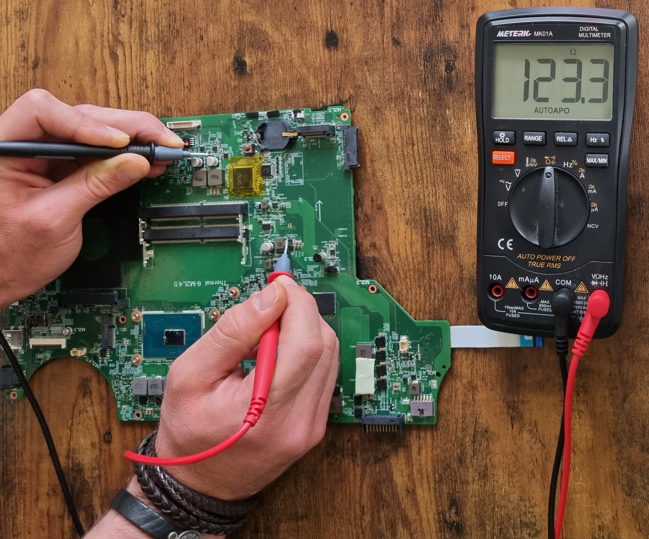

                But I have measured 0.4ohm between GND and +VCC_Core. Do you think it's good ? Or CPU is shorted ?
                • mcplslg123
                  • Jun 2015
                  • 7262
                  • india
                  0.4 Ohms is bit low and likely cpu is shorted.

                              Absolutely no point since the CPU is shorted. It's a common enough failure mechanism that I personally wouldn't even bother. High side FET goes short, allows full rail into CPU/GPU etc, killing the silicon.
                              • worlor
                                • Oct 2020
                                • 28
                                • France
                                Hello
                                Just to give news :
                                Yes I have replaced the mosfet
                                Yes the CPU was shorted
                                I have bought a new mainboard, non-shorted CPU report 2.4 ohms on same VCC line.
