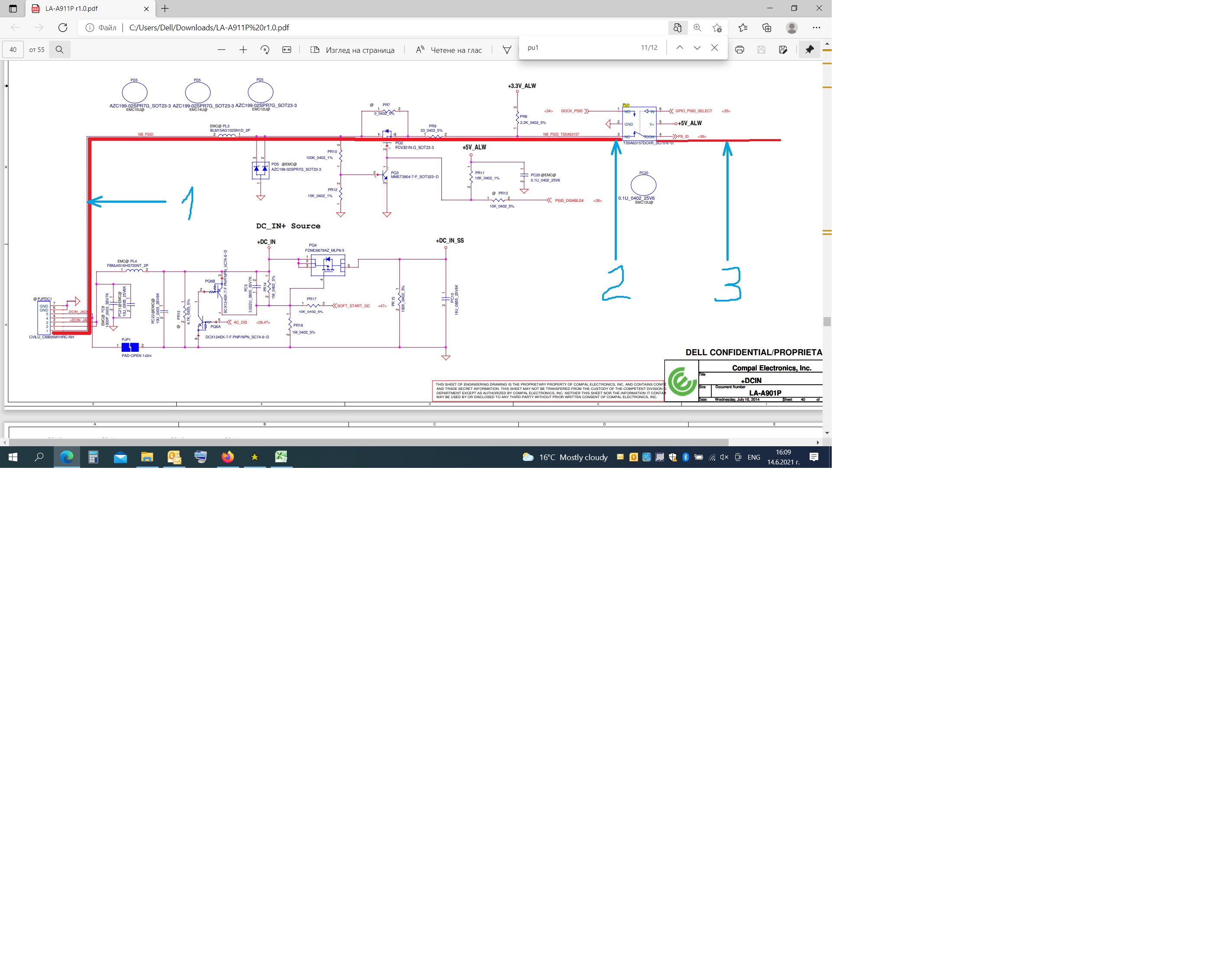

    hello.
    I have a Dell E5550 that doesn't recognize the charger, the usual Dell problem, i tried multiple chargers that charge fine other Dell laptops so the issue is clearly in mainboard.
    I replaced the PQ2 and PQ3 but no luck, so i need your help on what to do next.
    Schematics attached.
    Thank you in advance

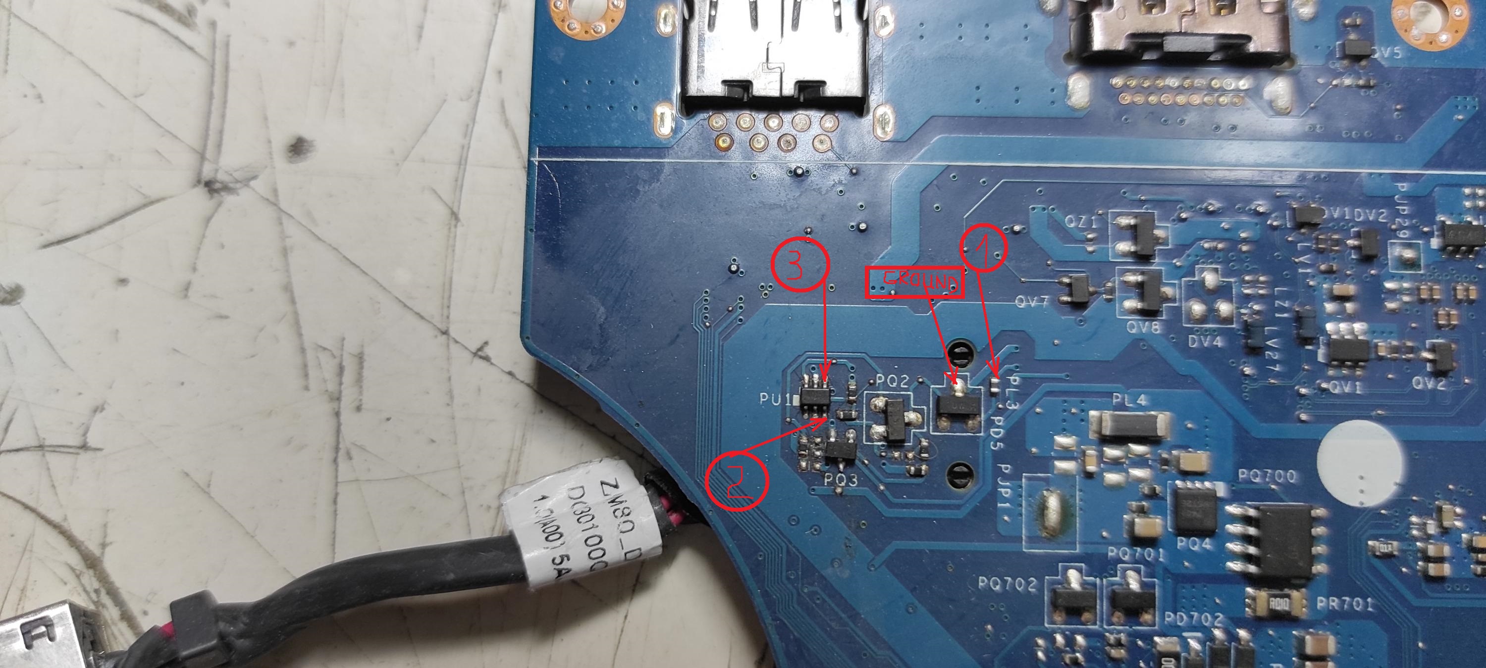

            Pin3 is directly connected to PR9, so check again - I mean the voltage on PR9 and pin3 of the PU1 must be the same. Also check resistance to ground in the line.
            ----> Look here. The diode marking for your board is PD5, the rest is the same.

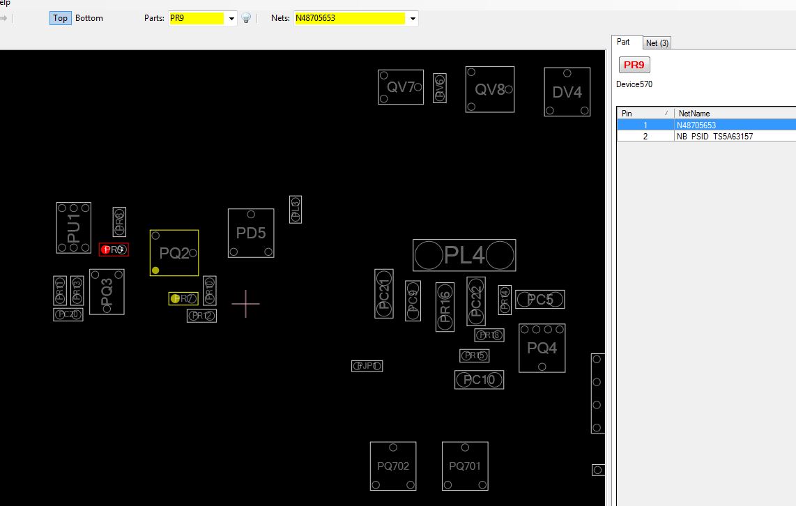

              To avoid any confusion please show me which one is PR9 as there is no writing, just to be 100% i'm measuring correctly
                • 20898
                Re: Dell E5550 No charge (charger unidentified)
                Just posted the boardview - https://www.badcaps.net/forum/showthread.php?t=67214

                  Can't open it, boardviewer and openboardview crash when i attempt to open it
                    • 20898
                    It opens ok for me with BoardViewer, make sure you have the latest version -
                    http://boardviewer.net/
                        Look the arrows.

                          Originally posted by Vesko356
                          Look the arrows.
                          Yes i can confirm pin 3 and 5 have both 5v. (not sure why i measured 0.66 before @ pin3)
