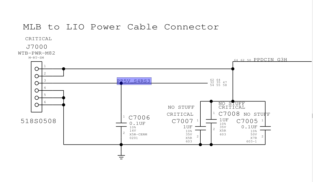

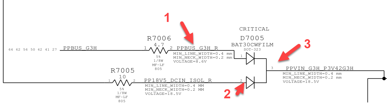

    1) Is the adapter an Apple original? Is it a known good working adapter ?
    2) Attach the adapter. Post the voltages from the attached locations. Meter in volts mode, black lead on ground. Red lead on each requested location.

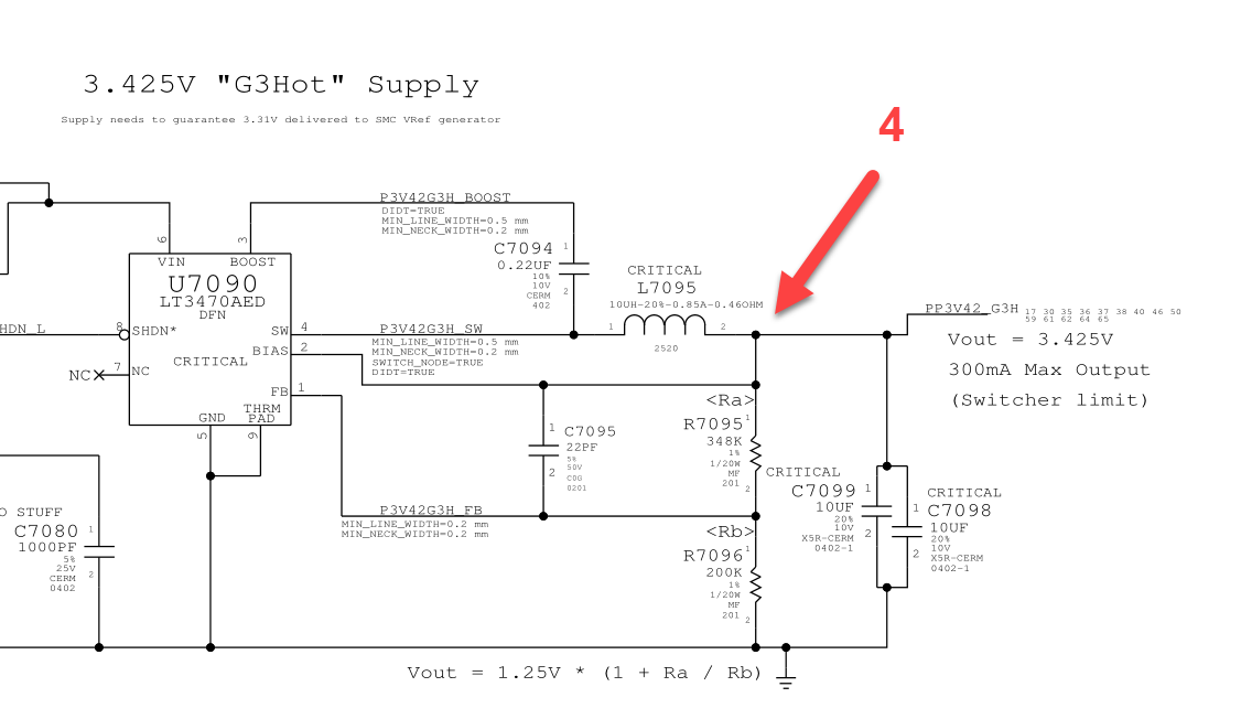

    3) Volts on L7095, pin 2 = PP3V42_G3H. This rail must be 3v42 or close to this value.

      Location 1 = 8.57V
      Location 2 = 15.09V
      Location 3 = 14.83v
      Location 4 = 3.427v
      Thank you .

            2) Post your voltage for PP5V_S4RS3 rail @ L7520, pin # 1.
            3) Confirm the voltage reaches the connector J7000, pin # 3.

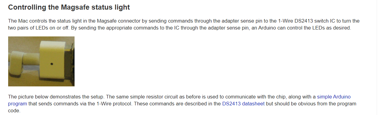

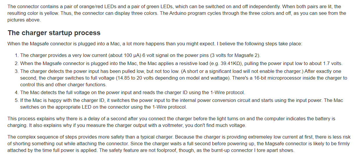

            4) The LEDs onboard the magsafe head are based on the Maxim (aka Dallas) Semiconductor 1-wire interface. Using a single wire / pogo contact pin, communication occurs between the magsafe adapter and the host logic board.
            After a handshake occurs between these 2 parties, the magsafe power adapter will power up to the max voltage to power the logic board.
            Check that the pogo pin contacts are clean on your paddle (LIO) board that mates with the magsafe adapter. This is very important. Recommend to use a cotton swap or similar with alcohol to clean up each contact.
            Also attempt to power up the logic board without a battery. Does this allow for the magsafe light to turn on?
            5) Check that the bridge cable between the main logic board and this LIO board is solid and with no corrosion. These cables are relatively low cost to replace (821-1722-A).
            6) The LIO board may be defective. Not aware of any schematics for this paddle board.
            See here:
            http://www.righto.com/2013/06/teardo...f-magsafe.html
