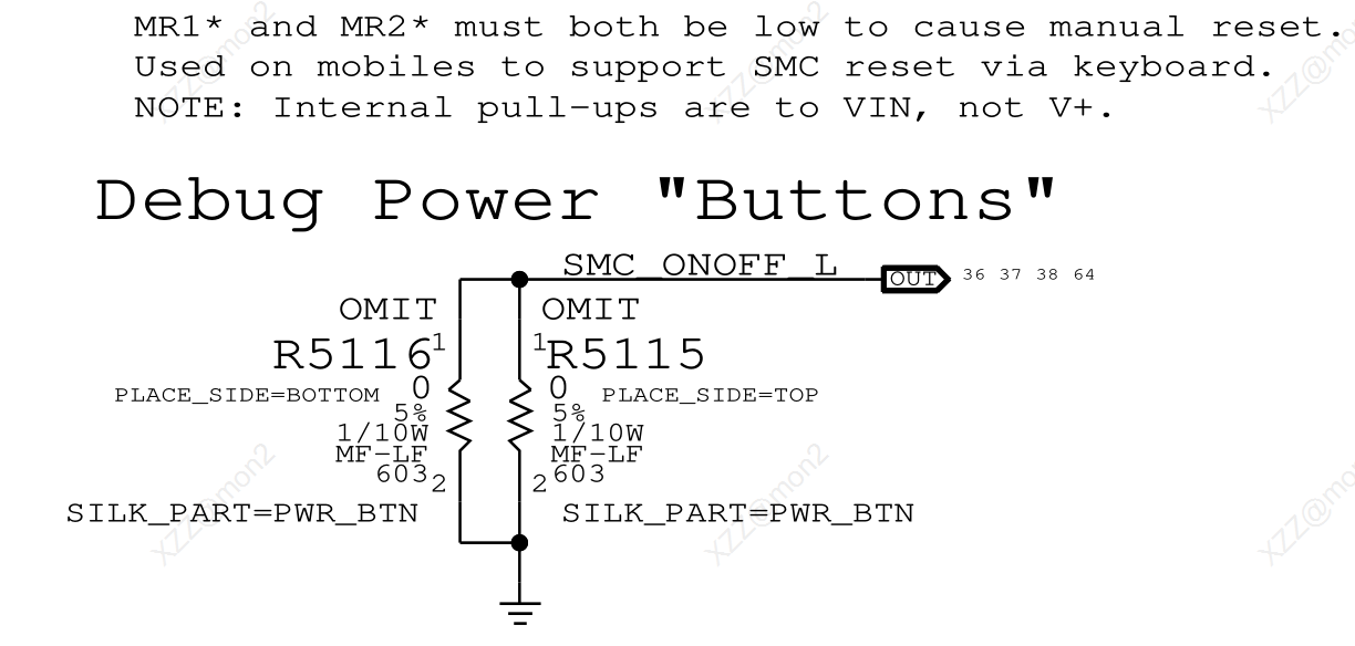

          Locate the power on/off button pads on the PCB. Use a pair of tweezers to short one pair to mimic the power button on the keyboard.
          Does the board turn on and remain on with this method?

            If i just short the pads on the not populated R5116 or R5115 for a sec, fans starts than stops.
            If i keep the short on the mentioned pads for few sec, the logic board turns on and remains on even if i remove the short.
