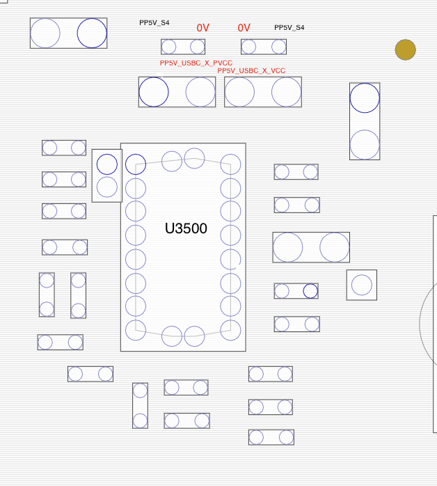

      Re: a1706 820-00239-A charging but no 5V Output
      Thanks for your answer.
      I am missing PP5V_S4_X_USBC.
      PP5V_S4 is always present.
      UPC_X_5V_EN at 3.3V
      P5VUSBC_X_PGOOD 0.2-0.6V not stable
      What can be the issue?

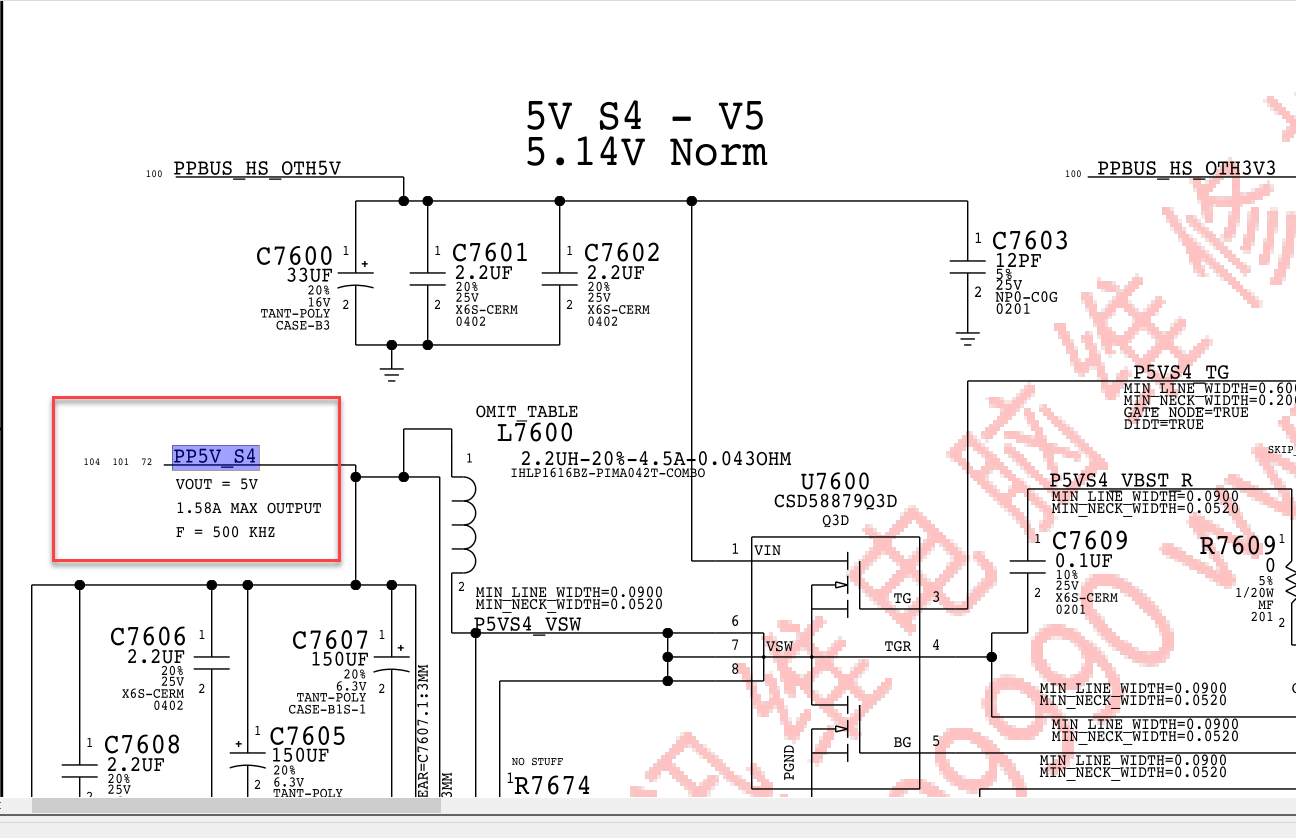

          1) PP5V_S4 rail is generated as shown on sheet 72 / 119 of the PDF schematics.
          With a resistance of 6 ohms to ground, using ohm's law calculator:
          https://ohmslawcalculator.com/ohms-law-calculator
          Feed this calculator 5 Volts and 6 ohms, yields 0.833 A.
          The rail can support up to 1.58A so it is ok.
          2) Since PP5V_S4_X_USBC is missing, power down & remove your battery.
          Place your meter in resistance mode (OHMS) and place red lead on pin # L3500 and black lead to ground.
          What is the resistance reading ?
          3) Using your meter in voltage mode, check the voltage of PPBUS_G3H @ pins 8 & 9 of Q3501 mosfet. This local switching power supply rail accepts the higher PPBUS_G3H voltage and steps it down (BUCK regulator) to generate the missing PP5V_S4_X_USBC rail.
          It is possible that the issue is linked to this page # 33 - the mosfet may not be switching or the regulator is not enabled.
          4) Check if the regulator is enabled by monitoring the voltage on UPC_X_5V_EN = pin 15 of U3500.

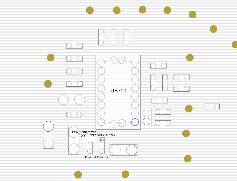

            Thank you mon2 for spending so much time with helping me.
            Before i go on, here is a short explanation about the history of this macbook.
            it was liquid damaged. I took a spare board and changed
            1.SMC
            2.U7800 SN650839 (Power Management Controller/ is this the pch?)
            3.isl95828 (CPU Controller?)
            After this work the macbook came back working and usable.
            Charging on every Port with 20.3V.
            I mention that all cd3215 are ok so far.
            PROBLEM 1:
            No one port recognizes any 5V source, i tried with a simple USB Drive on usb-c adapter.
            I checked this adapter-USB Drive combination on a working macbook before.
            PROBLEM 2: (possibly a result of problem 1?)
            Instead of hibernating / switching to wallpaper mode AND when in standby (Display shut)
            the machine does reboot by itself and giving me the ERROR :
            Sleep/Wake failure in EFI
            All other functions were OK.
            From this point i did :
            1. new (known working) BIOS with ME clean (old SN copied)
            2. "POST TOPIC" Found this 5V Line (U3500,UB700) with problems.
            Today i took out both isl95870 USB controller and 3 resistors which were found with about 17ohm instead of 2.2
            R3501 / R3506 / RB706
            Why was on RB701 PIN2 PP5V_USBC_T_VCC passing 5V?
            PP5V_S4 has now 130ohm to ground
            UPC_X_5V_EN was at 3.3V
            BUT
            P5VUSBC_X_PGOOD was only 0.2-0.6V
            I want to put in new isl`s and resistors but ran out of spare parts.
            I think something is pulling down PP5V_S4

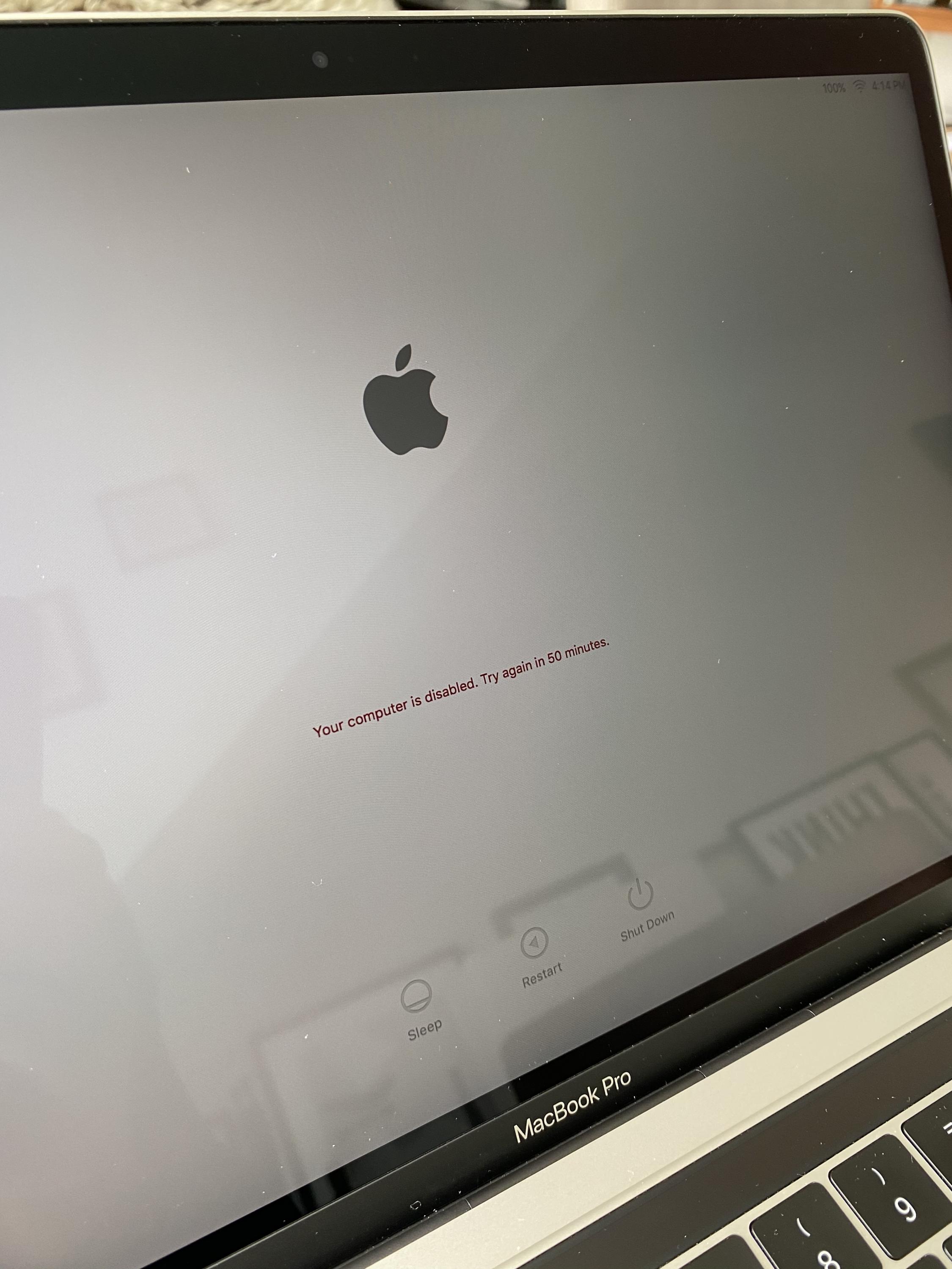

                Today i changed the mentioned 3 resistors and both isl U3500/UB700.
                5 V is back.
                No i get the message that computer is disabled.
                Because i changed the bios chip?
                • mon2
                  • Dec 2019
                  • 13950
                  Hi. See here:
                  https://discussions.apple.com/thread/250159484
                  Good idea to ask in the BIOS forum as well.
