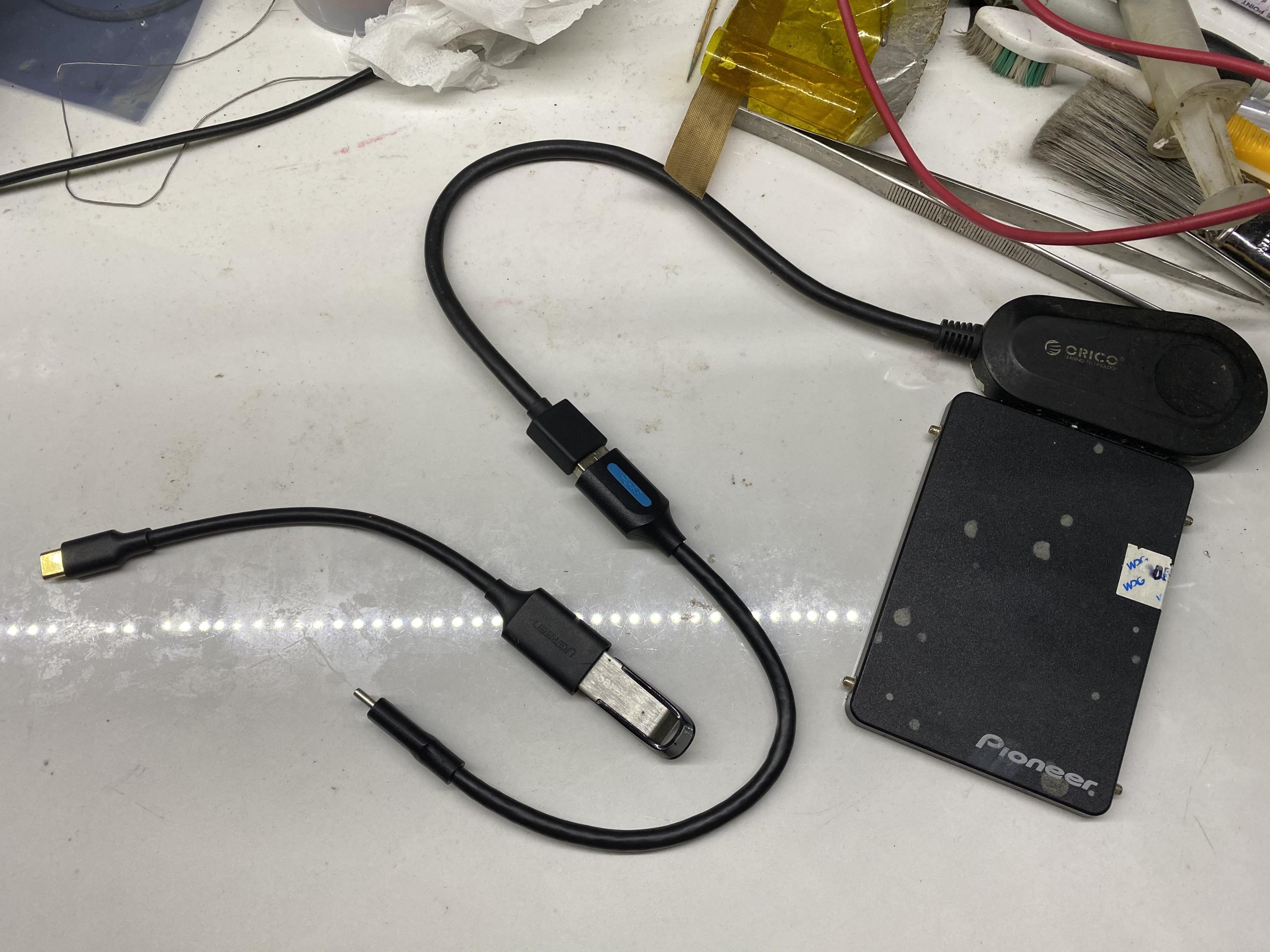

      I'm using simple converter from USB 3.0 to USB-C instead of external hub

        Can you link where you bought this cable ? It is important to know if this cable is properly wired. Is it a branded cable where a wiring diagram can be downloaded ?
        If you connect your USB stick + this type C cable to a power adapter with Type C - does the USB stick receive power ? Or can you attach some USB A style product to validate that power does pass through using this bridge cable ?

          I'm using this converter more than years and working properly.
          I tried to different MacBook Pro (2016 13 Non TouchBar, 2017 13 TouchBar, 2017 15 TouchBar), all working perfect... just plug & detect.
          But in this mac nothing happen (USB converter LED power OFF)

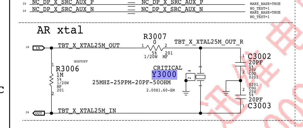

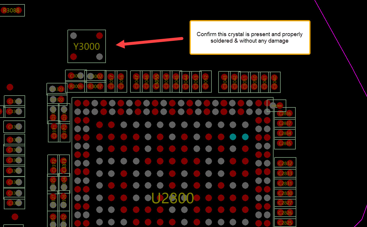

              Y3000 perfect condition, no damage & soldered properly, i even replace it from donor boards to make sure.
              I checked R3007 = 0ohm (correct value)
              Y3000
              pin 1 = 0.388v / DM 0.808
              pin 3 = 0.315v / DM 0.754
              L3500 & LB700 still 0v
              This is just my stupid questions, what if i put/inject power (3.3v) from another sources to UPC_X_5V_EN / UPC_T_5V_EN ??
