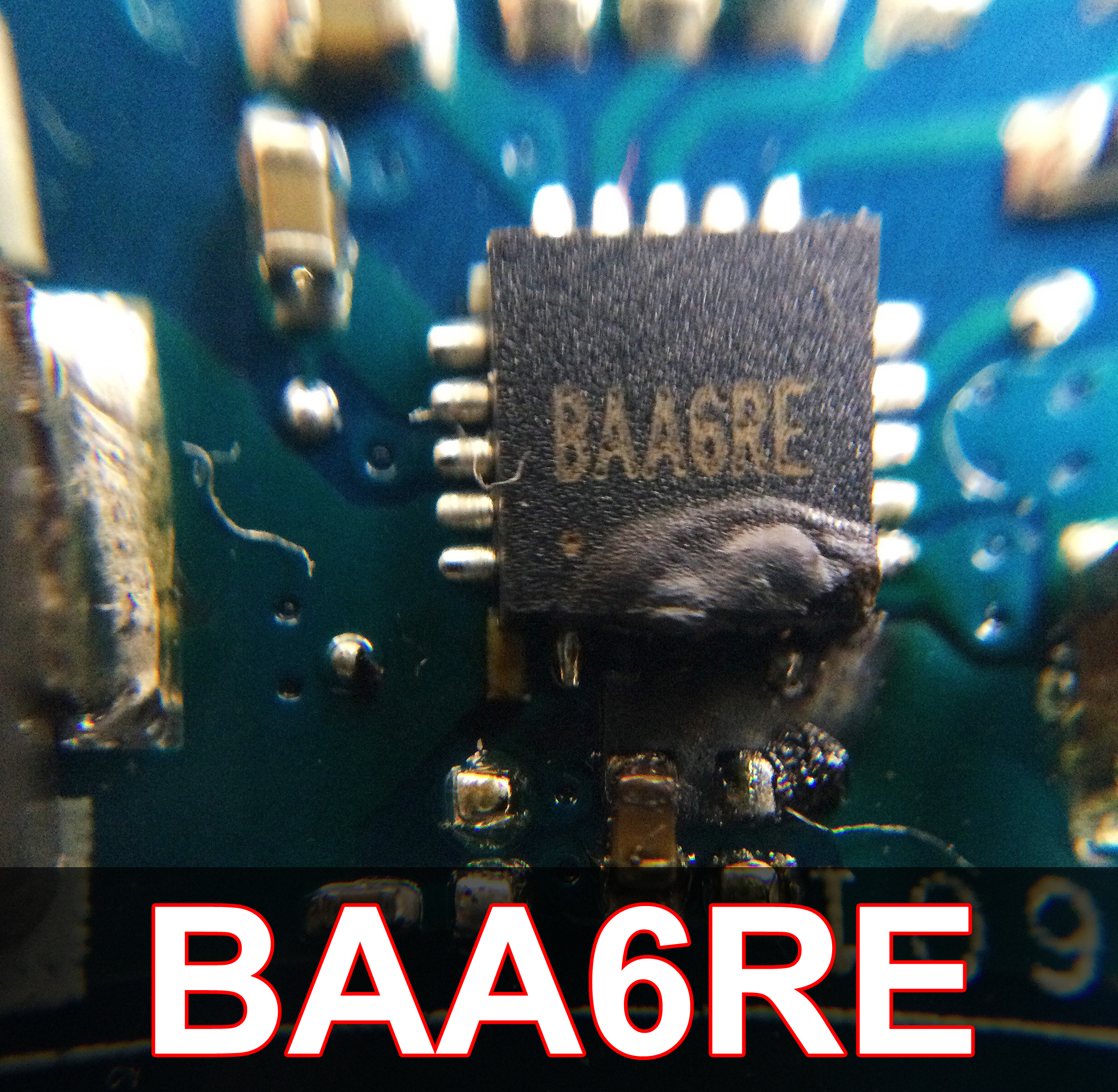

    Hi there
    1. Can anybody ID this Laptop IC Please?
    2. Does anybody have a Boardview or Schematic?
    The Only Info I can Identify is that:
    HP Laptop - HP 15-BA055SA
    Motherboard - BDL-51-D711P - Rev 3.0
    Thanks in Advance

    Re: IC ID Please? HP 15-BA055SA - BDL-51-D711P - Rev 3.0
    Believe the part is a regulator from Silergy.
    Will investigate...
      Baa=sy8286rac
        Wow, thanks Guys
        How did you find that out?
        What part of the circuitry would it be?
        The Laptop draws 4 Amps just in standby?
        Any idea what would cause it to go faulty so badly and melt it?
          https://www.badcaps.net/forum/showpo...23&postcount=1
              Hi people - Would anybody be so kind as to post a link for where I can purchase this BAA6RE please?
              Either Amazon or ebay, or anywhere else please.
              As finances are low, I am worried I would get the wrong IC.
              Thanks a Million
                Thanks a Million
                Stay Safe
                Google sy8286rac, there are lots of suppliers
                  AliExpress is the best option:
                  US $3.00 9%OFF | 5pcs/lot NEW SY8286 SY8286R SY8286RAC BAA6UA BAA6VJ BAA6AK BAA5VA BAA*** QFN20 IC Chips
                  https://a.aliexpress.com/_mswi5IH
                  Install the AliExpress app on your phone and chat this or another vendor of your choice.
                  Then chat them with the full part number of the ic. The above link should be fine for your repair but do confirm with the supplier before purchasing.
