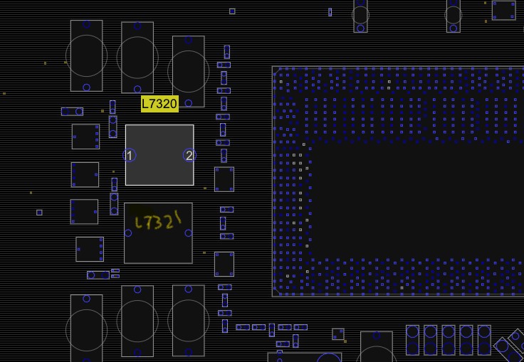

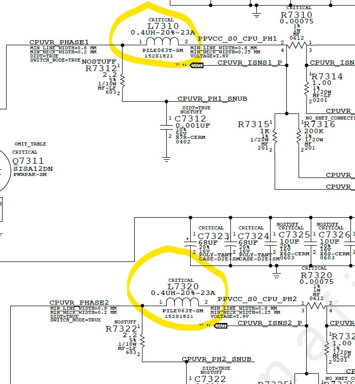

          Resistance to ground in diode mode:
          L7320 0.001
          L7310 0.001
          Resistance to ground in ohms:
          L7320 1.8 ohm
          L7310 2 ohm
          I guess these are the cpu coils?
          Thanks!

            Re: Macbook Pro Retina 13” 820-3476-A (A1502) - missing PM_SLP_S4_L
            u had the same exact voltage like i had on same board. it's cpu is in short. ofcourse u can try with 1 volt and see if cpu is getting hot or some caps, but dont go to high with voltage, u can damage cpu. go around 1 volt and see if cpu or caps emosfet get hot, maybe ur lucky and it's just one mosfet or capacitor near it

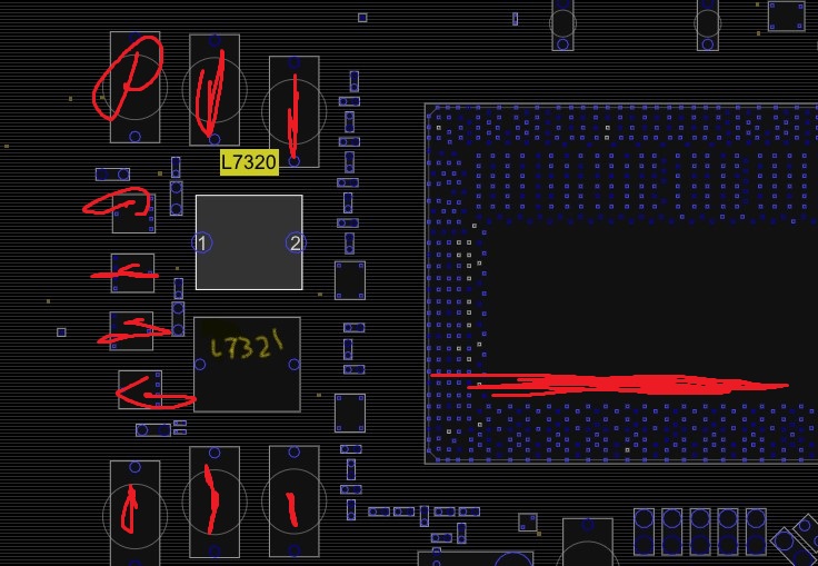

                inject 1 volt on the coil (cpu side) without cpu heatsink. chech carefully if cpu or mosfet or caps around it get a bit warm.
                on my board it was the cpu getting warm.
                • dellxps15
                  • Feb 2014
                  • 1588
                  • italy
                  look at the attached picture; check the red markez zone for getting warm and that side of cpu too.
                  edit: i did edit the previous post but dunno why i did a new post. sorry for that
