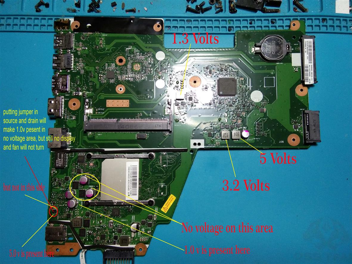

    Im working on this board, my problem is... the board power up but no display, fan wont turn. i check the voltages, 3.2v 5v, 1.3v is present except the voltage going to processor, the board is not shorted, no parts getting hot or warm. i also tried reflshing the bios, still no display, i need some help on this, thank you

    try to check the bios ic voltage 3.3v or try also to check the bios battery try to use external monitor. asus . is the memory built in. if not try to us good known memory ddr3L. most of the problem with non existing voltage can be repaired by just bios reflash unless theres a short somewhere in the board cheers

      board view is available https://www.badcaps.net/forum/attach...1&d=1448521678
