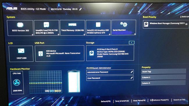

                        Originally posted by Pfudaniel
                        Ok. I'll look into it.
                        Is this BIOS text mode or it has graphical interface as the picture attached?
                        • Pfudaniel
                          • Feb 2021
                          • 91
                          • Netherlands
                          #32
                          Re: Asus Gl553VW turn on no windows boot
                          the bios is TEXT mode, no graphical interface
