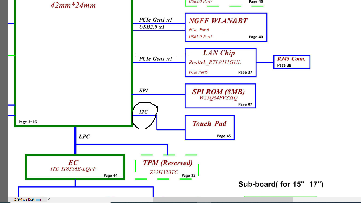

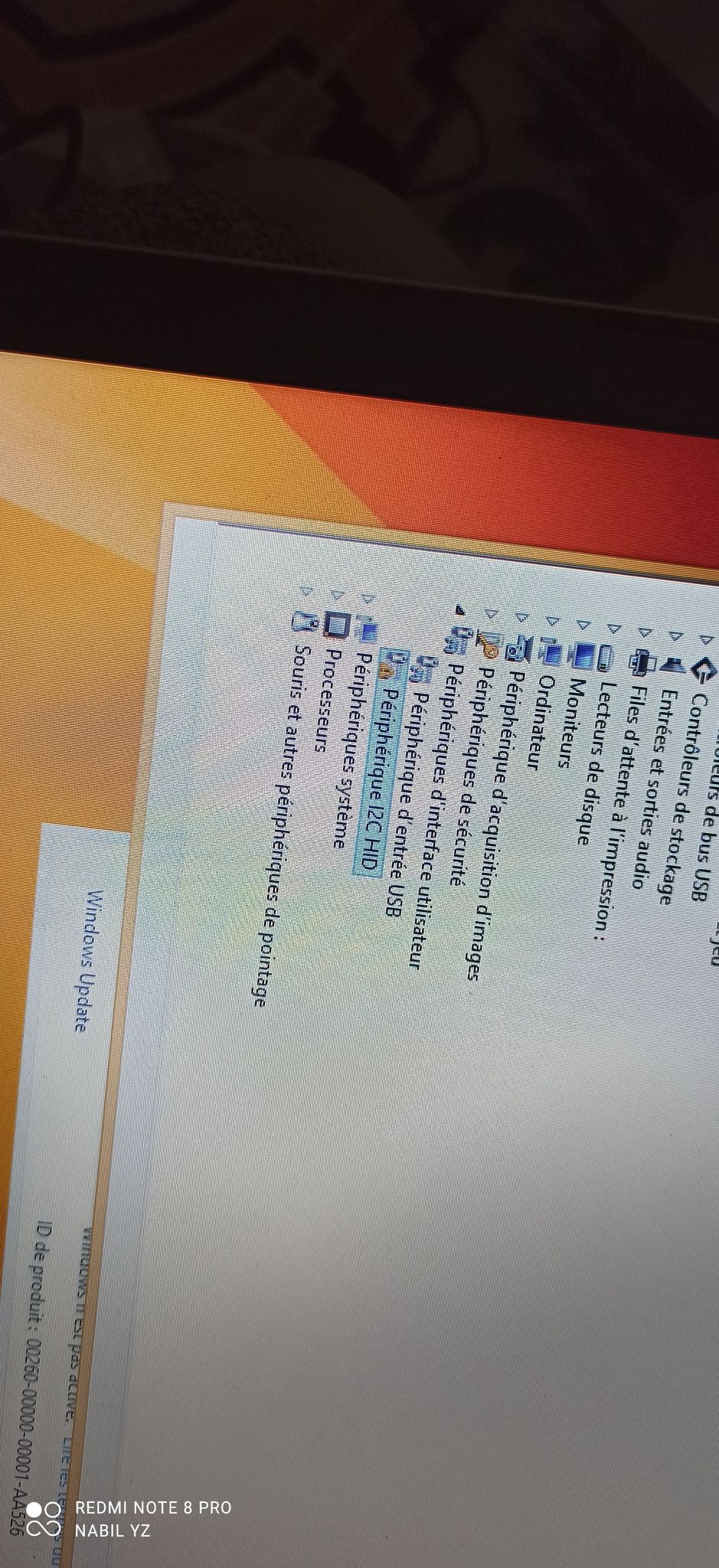

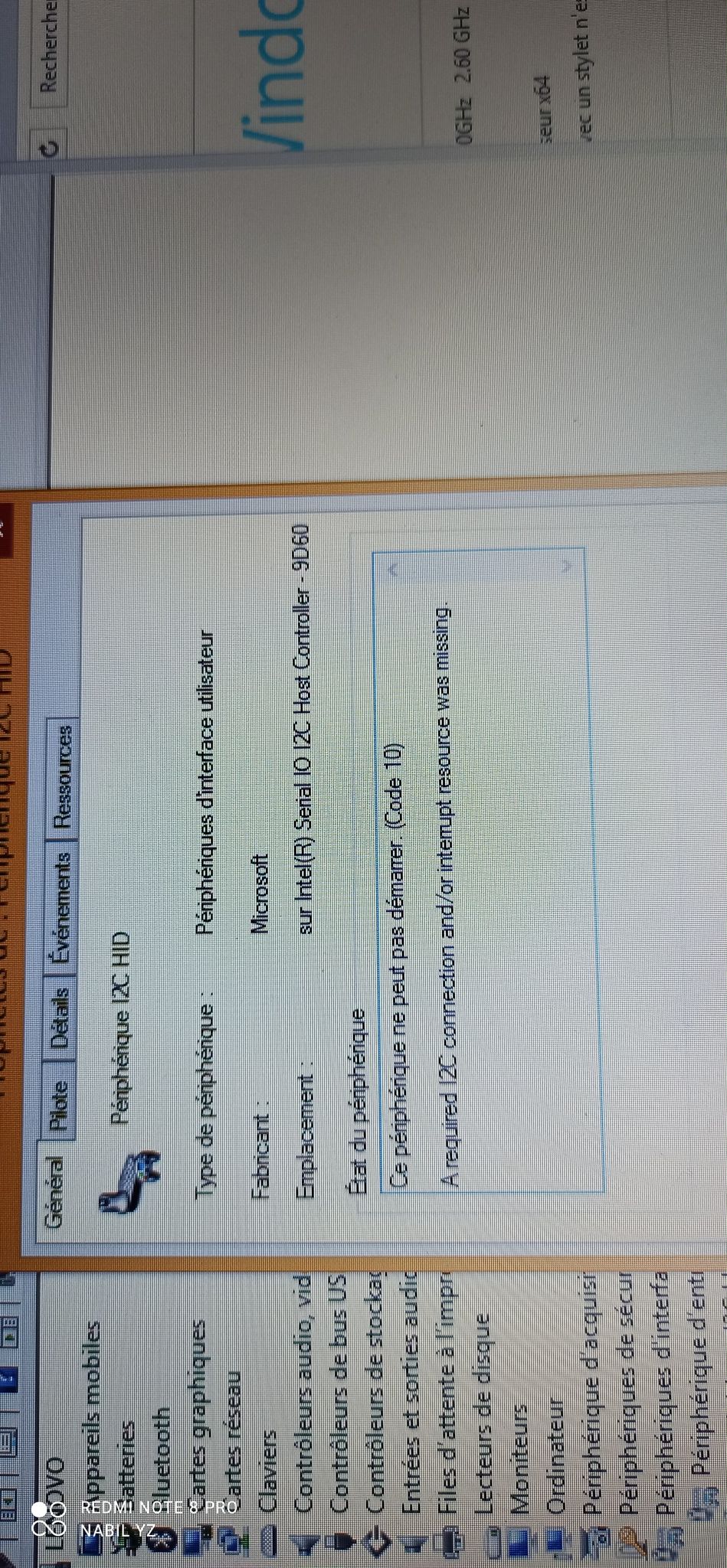

    hello i have lenovo ideapad 330 borad numb nm-242 touch pad not working
    i did try install new windows update bios update driver nothing work and when u
    take look at device manager i see yellow triangle on **i2c hid ** code errror i did install all the driver nothing is missing and when u try f6 nothing happaen
    10
    any suggestion 3v present

        Re: lenovo 320 nm-242 touch pad not working
        this is the problem

            Try these drivers
            Intel serial IO driver
            https://download.lenovo.com/consumer...s/9u0d03af.exe
            Touchpad drivers
            https://download.lenovo.com/consumer...st08af09mc.exe
                      any oen pls
