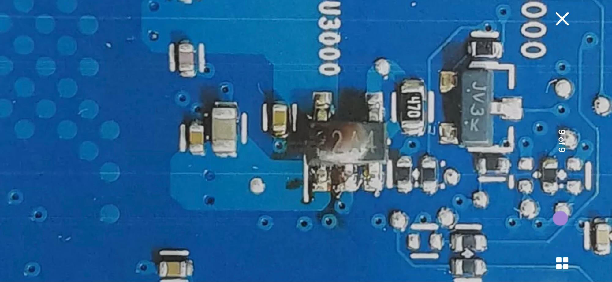

Help identify Burnt Component on HP 14-an013na
    Hi guys could anybody help me identify a replacement for this part? The laptop is a HP notebook model: 14-an013na the board number is: DINERAMD: 6050A2822801 MB-A01 The part that has blown is on the underside of the screen connector if that helps it has 3 legs on one side and 2 on the other side. From what I can make out it has 22A4 marked on the top.

    Re: Help identify Burnt Component on HP 14-an013na
    Image attached
      G5243AT11U SOT-23-very likely this is the part used for eDP power. You can check the pinout on your mb with reference to LA-C701P pg19 schematic.
        Thank you very much, I wonder how you found it. From experience or from looking at similar board which has schematics?
          From experience mate
              Jumper pin1 to pin5
