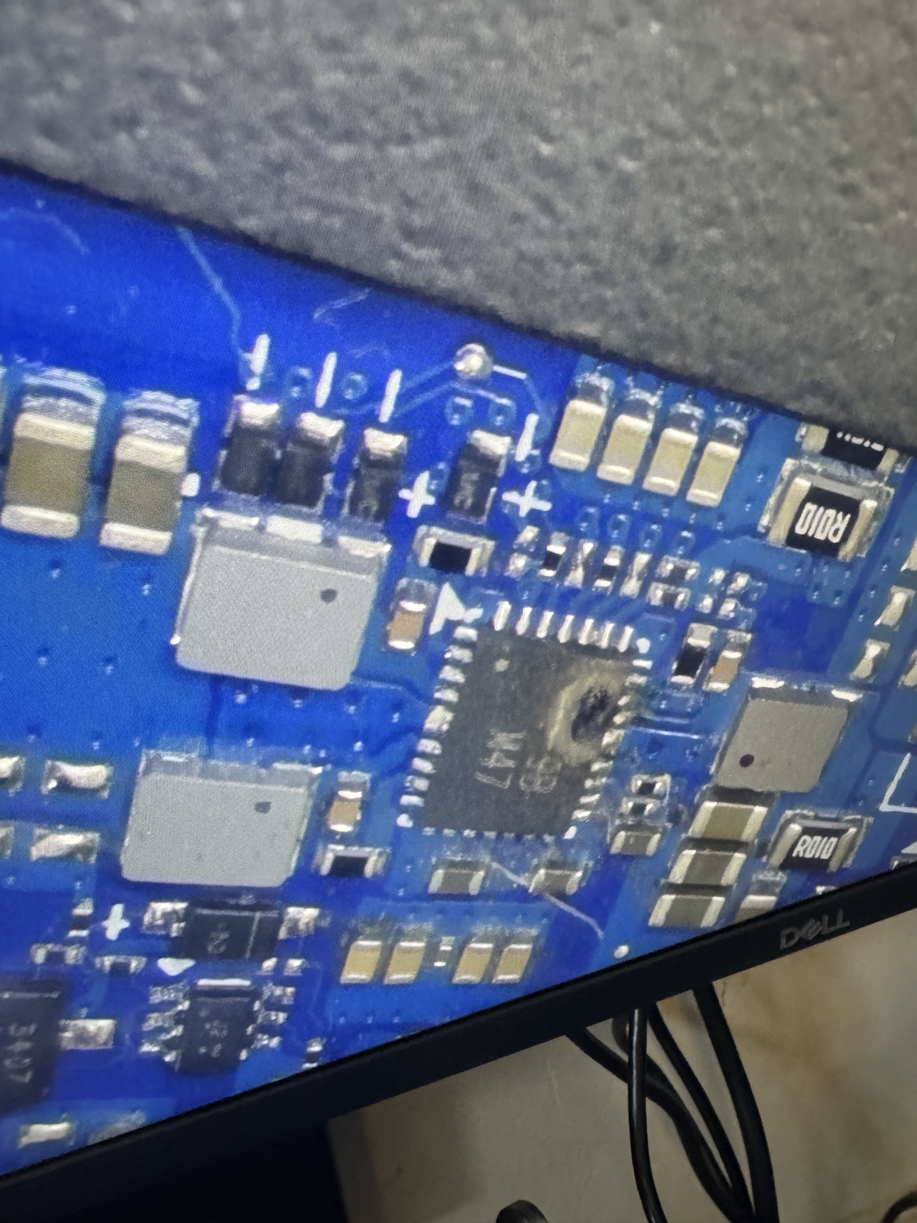

    I have a Asus Q540v laptop which has no power. I opened the laptop and found this burnt chip. Unfortunately, the marking on the chip is damaged. Anyone able to identify this chip?

    I got a guy with the same laptop take a photo of the chip for me. Can anyone tell mw what chip is this?

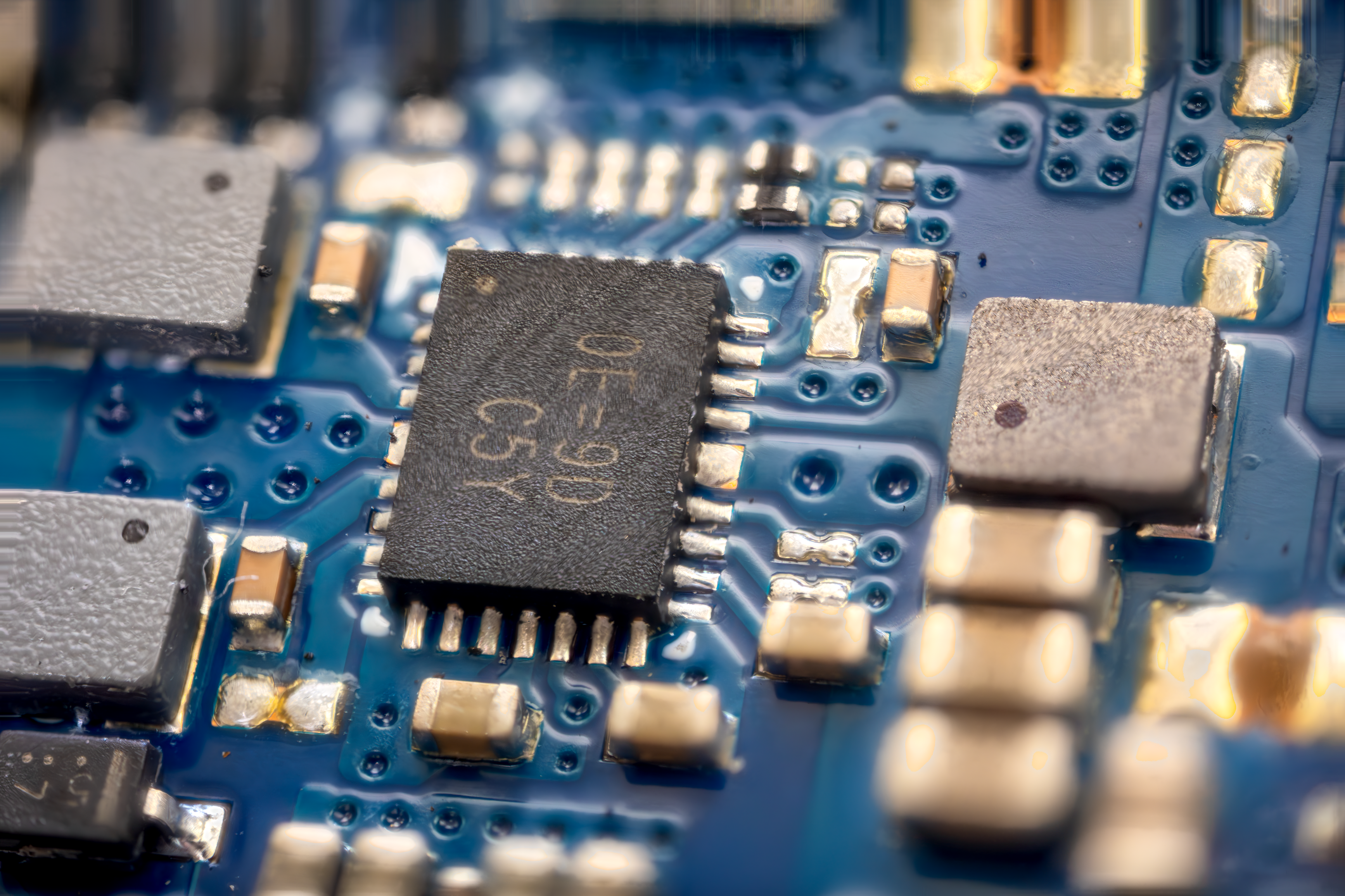

      For sure the part is from Richtek but so far, found at least 3 different case packages with the SMD code of 'OE='. Still hunting.
