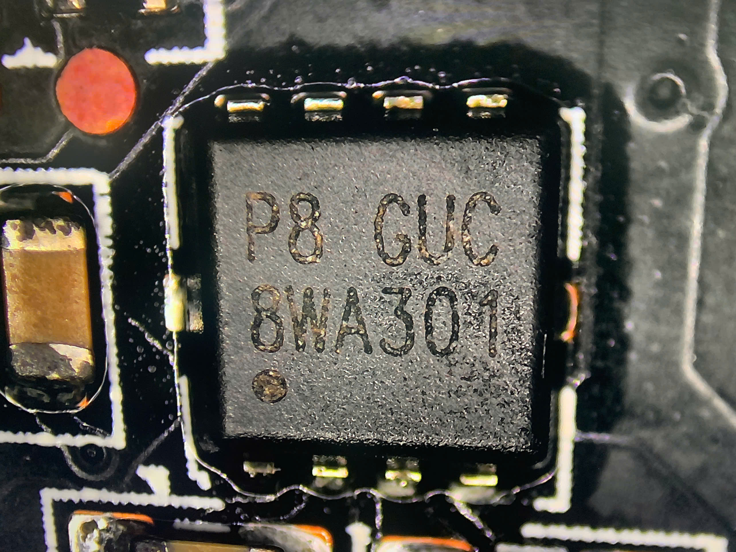

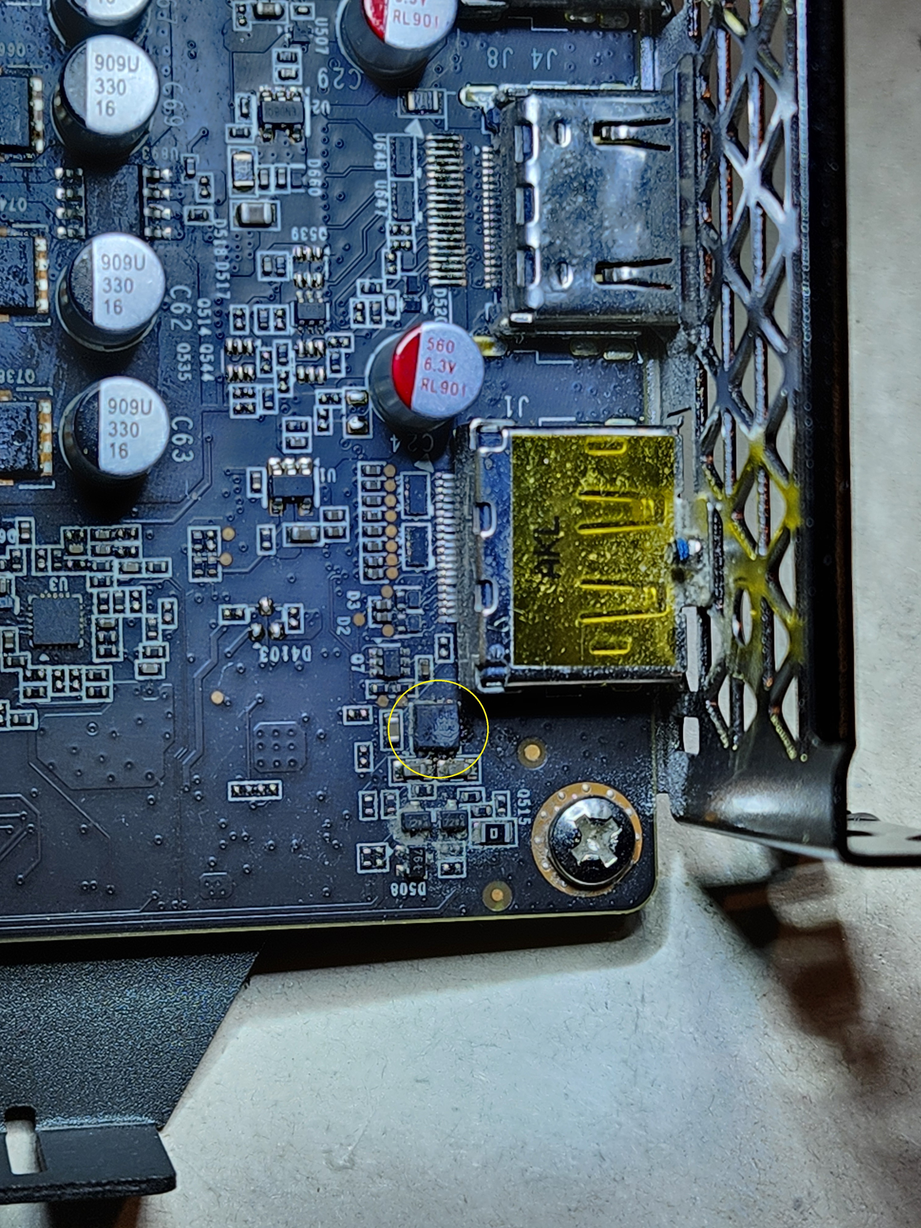

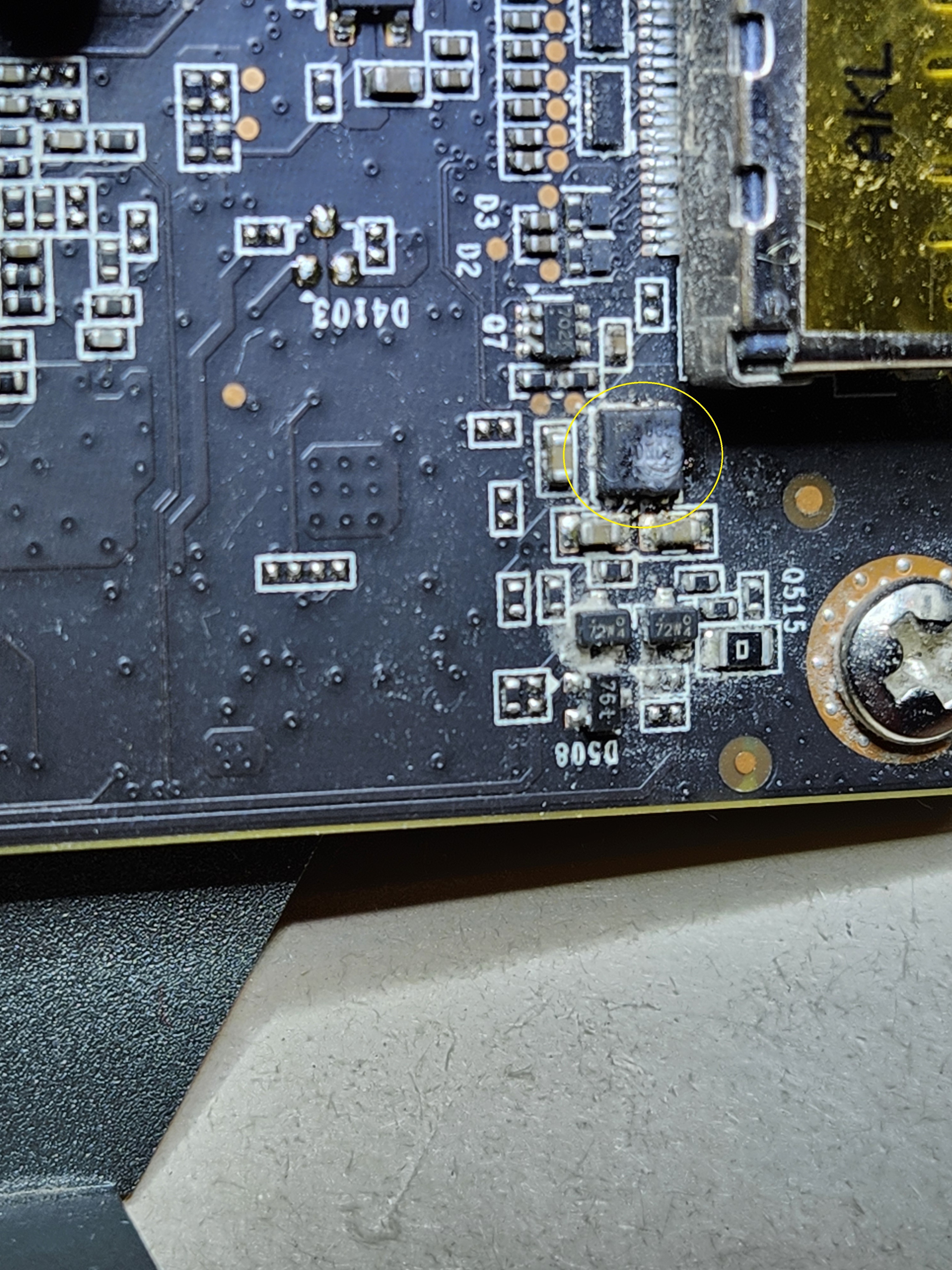

identify this burnt element on ZOTAC GeForce RTX 2060
  • fraser34
    • Jan 2019
    • 8
    Can anybody, please, help to identify this burnt element on ZOTAC GeForce RTX 2060 6GB 192BIT GDDR6?
    It says something like "6UDN..." on it.

    u can replace this by EMF20B02V

          Did you find out what caused the burn?
          • ductranvinh
            • Dec 2021
            • 135
            • Republic of Vietnam
            Short circuit dual mosfet vram lines and dead ic up1666q
