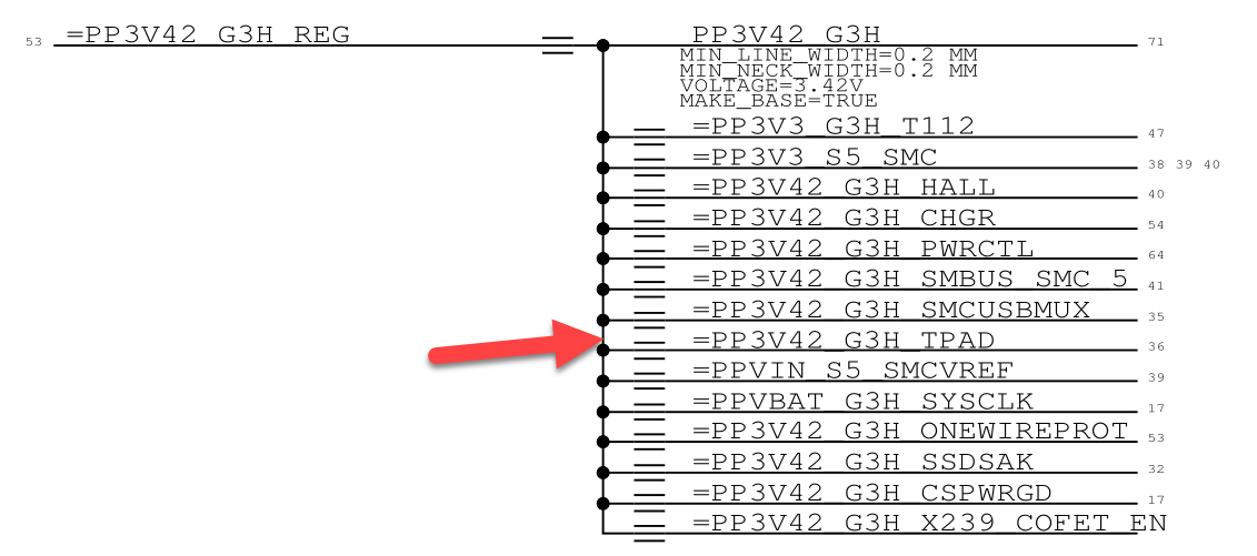

    Have a 820-4924-A - with no Green light on the charger.
    R7020 looks discolored and measures 31.9ohms insstead of 47ohm.
    attached a picture with voltages between dc jack and u7090.
    also getting a short to ground on PP3V42_G3H (L7095, C7099, C7010, C7008, ...)
    took off u7090 and L7095, C7099 and short still there. didn't take anything else off.
    thanks

    Re: 820-4924-A - No Green Light
    What is the resistance to ground at c7010?
    The 3v42 rail is required for the one wire circuit to operate and light up the adapter green light.
    You may have a shorted cap but please post the above resistance reading for this rail.

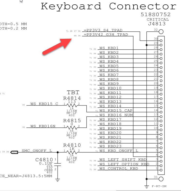

        PP3V42_G3H_REG goes all over the board including powers the one-wire circuit that is not being powered due to lack of 3v42 presence.
        Remove the trackpad & keyboard cables and check again on this resistance.
        Look around for possible liquid damaged parts that may be impacting this rail.
        Something is causing for this low resistance on this line which is then forcing this rail to shut off.
        Do you have a voltage injector? Do not use it yet. Others may have other advice but please post the results from the above testing.
                        Update: Macbook is working.
                        Voltage injection on the PP3V42_G3H_REG line
                        1V 1A - nothing got warm or hot (0.5xxA)
                        2V 1A - nothing got warm or hot (0.5xxA)
                        2V 2A - nothing got warm or hot (0.5xxA drops to 0.2xxA)
                        3V 2A - was drawing all 2 amps. i kept connecting and disconnecting the ground cable from the bench supply and on the 4th try it stayed on 3v and the amps dropped to 0.2A.
                        checked the caps and inductor that were shorting before and theres no more short.?????? where did the short go?? only thing i did was put IPA on U7090 and it's surrounding components.
                        pluged in adapter got a green light for 2-3 seconds then it stays on orange. Logic board with and without battery

                              • piernov
                                • Jan 2016
                                • 4439
                                • France
                                200mA drawn on PP3V42_G3H is still pretty much a partial short to ground. SMC can cause this (but still another component could be the culprit). It should warm up more than usual.
