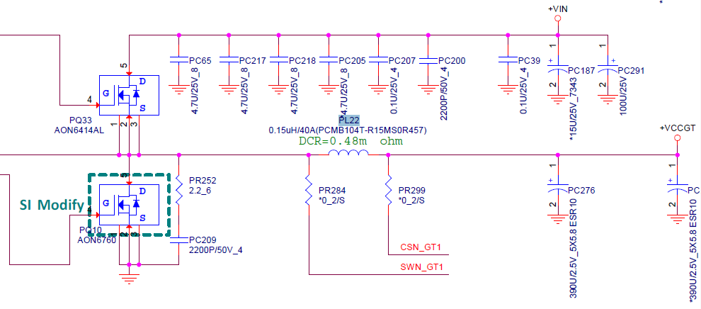

      I'm almost certain this is not a bios issue. I have the same board which works and I even solder its BIOS chip but it behaves the same. I even swap the BIOS chips. The issue is something with the motherboard.
      For example when measuring resistance against the ground on PL22 it is 4 ohms, while the same resistance on the correct one is about 11 ohms.
      Interesting, I cannot measure any voltage on this coil on both boards, but one board works fine.
      The only difference I could find so far it this resistance, but it is expected to be low, since it is CPU area.

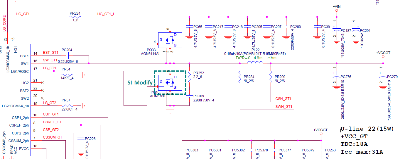

          • Askic
            • Sep 2018
            • 187
            • BIH
            Re: HP 460 G4 boot loop restart
            Here is that part of the power supply in which I cannot measure any voltage. I can measure VIN to be 19.5V. Without power, resistance between Drain and Source of PQ10 low side MOSFET. I have taken it out and between pins there is still 4 ohms and PQ10 is good.
            I would normally expect to measure here around 1 V, but there is nothing there. I must say, that this is probably not the issue because I have picture on the screen and HP logo for about 20 sec.
