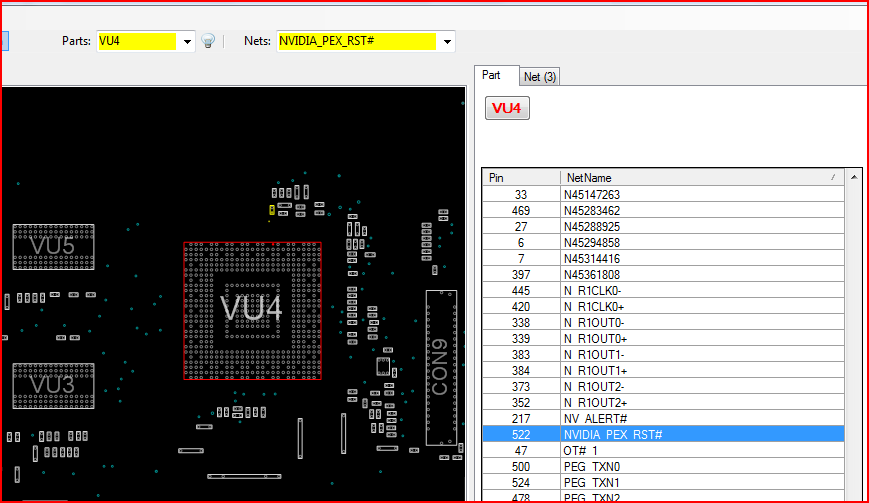

                          I've found the signal NVIDIA_PEX_RST# is always at low level. ( diode mode in that signal is ok, no short)
                          In the other hand the PLTRST_DIS# is at high level as expected.
                          I'll try that bios and will make some more measurements, but NVIDIA_PEX_RST# signal makes me think that nvidia gpu is damaged.

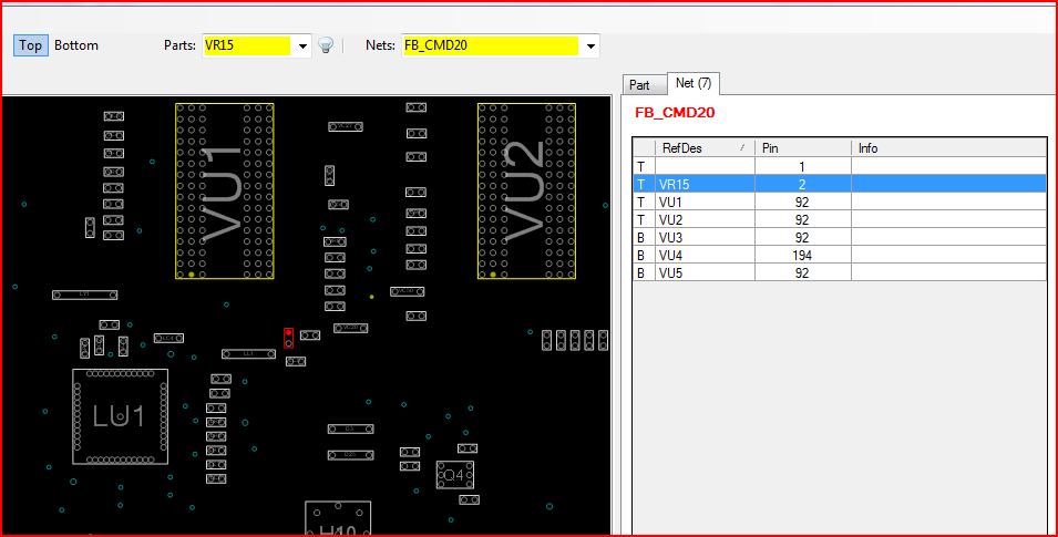

                              Other signal that seems to be wrong is FB_CMD20, it goes to all video ram chips and connected to RESET input of all chips, it has no voltage and presents no short to gnd.
                              Also tested DGPU_PRSNT# and it has 3 volts to enable discrete graphics.
                              I will continue with the tests but probably it's a waste of time.
                              If someone have any advice it will be welcome.
