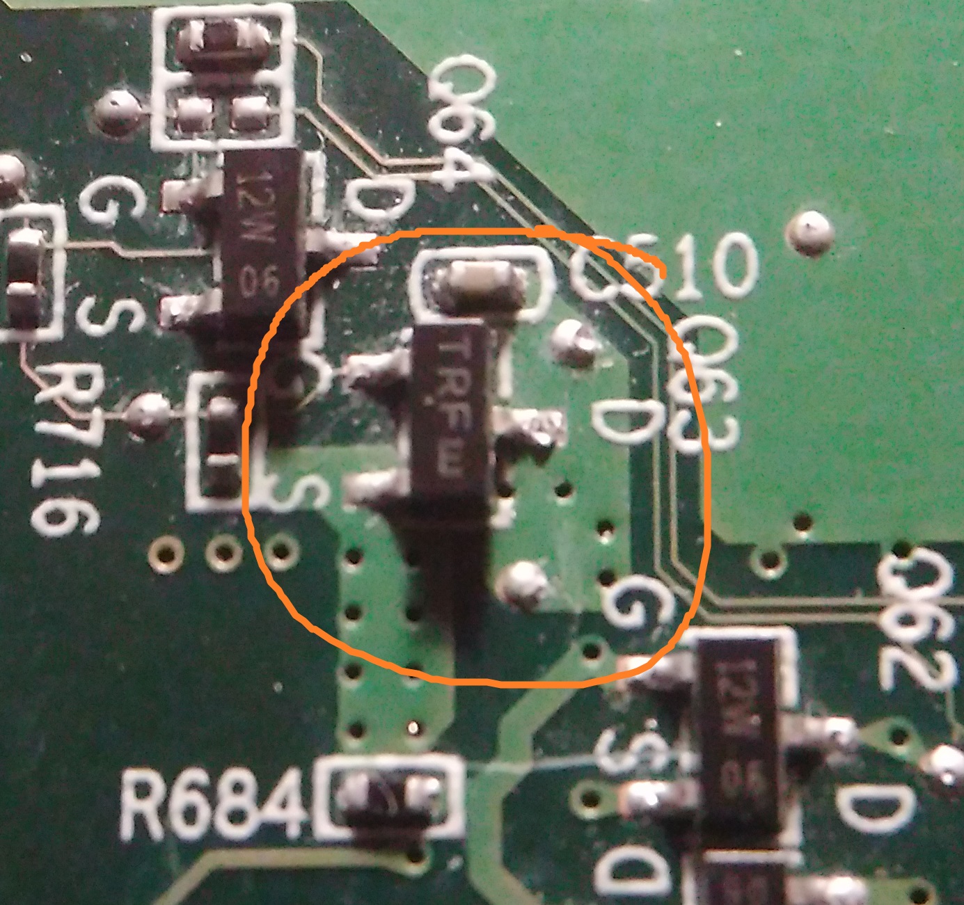

Can anyone identify this mosfet?

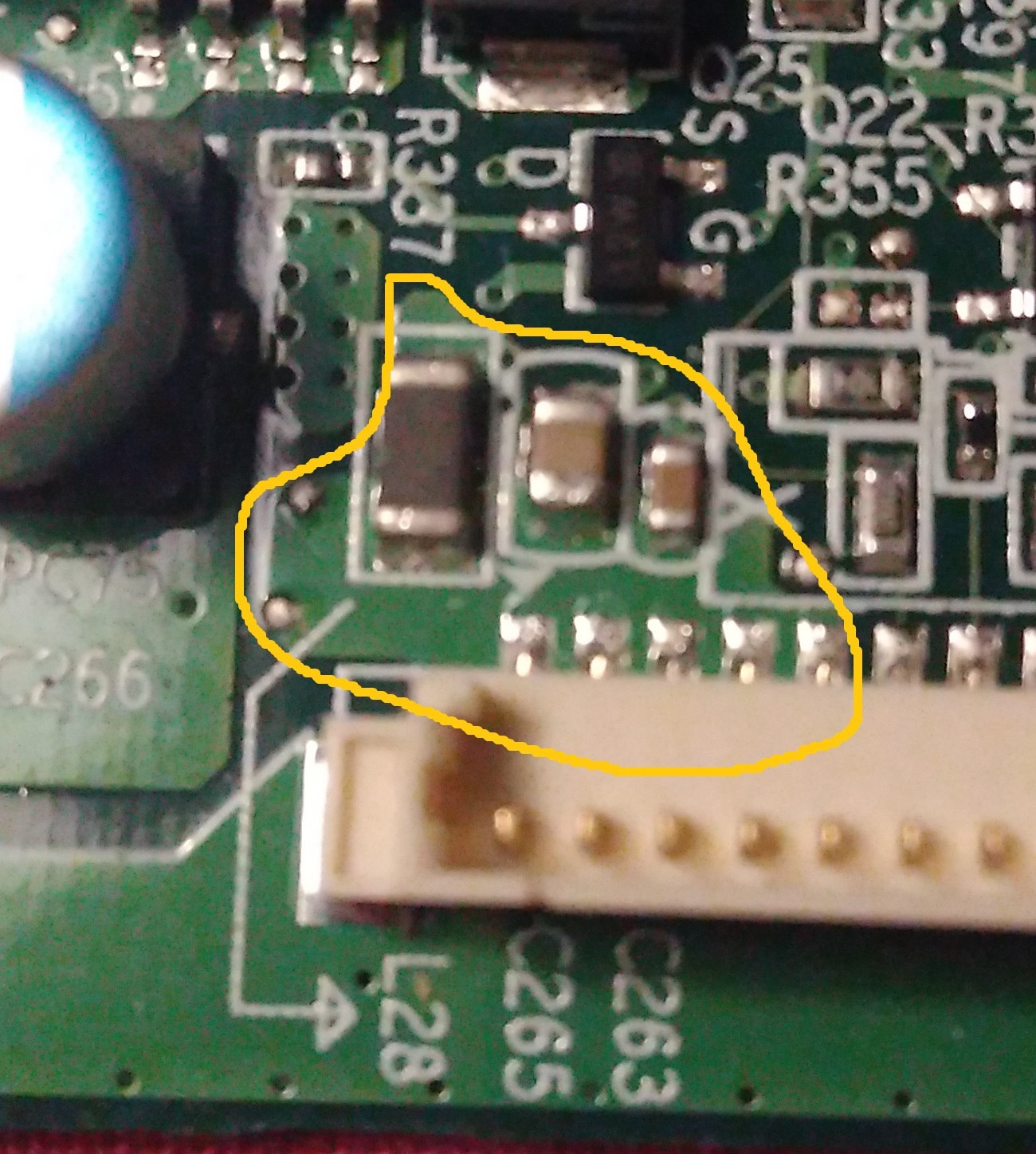

    I'm trying to fix this Dell 2205 AIO, the screen doesn't come on and I suspect the motherboard isn't supplying 12v to the inverter. Although I may be wrong.
    What is TRF with a value of E and apparently the dot means its led free?

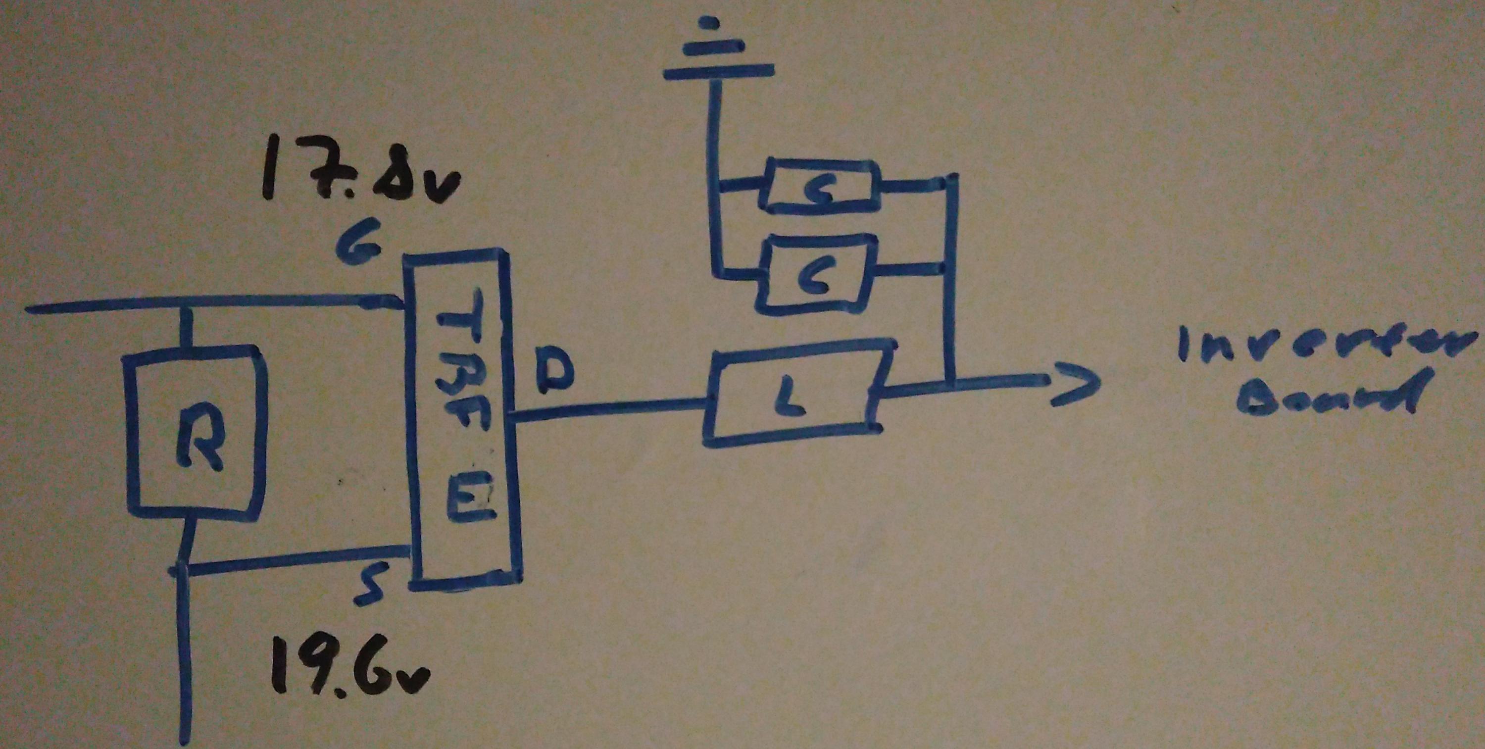

    I also put a little schematic thing up, I don't know if it's helpful.

    It is a load switch mosfet used in video device where sensing signal is required
    Google TRF mosfet you will find it at second page
    Although it is TRF m p channel
    Onsemi.com make these
    But they are two types p channel and n channel so check which one you have
    P channel conducts drain to source but not backwards
    N channel conducts source to drain but not backwards
    Three leg mosfet
    If you have schematic , first check number on it motherboard starting Q and find it in schematic

      I also found the pdf but didn't understand what was going on, thanks for clearing up for me!

        If n channel then mosfet conducts when gate valve is higher than source
        Vgs high= vg- Vs= 17-19= -2 wrong
