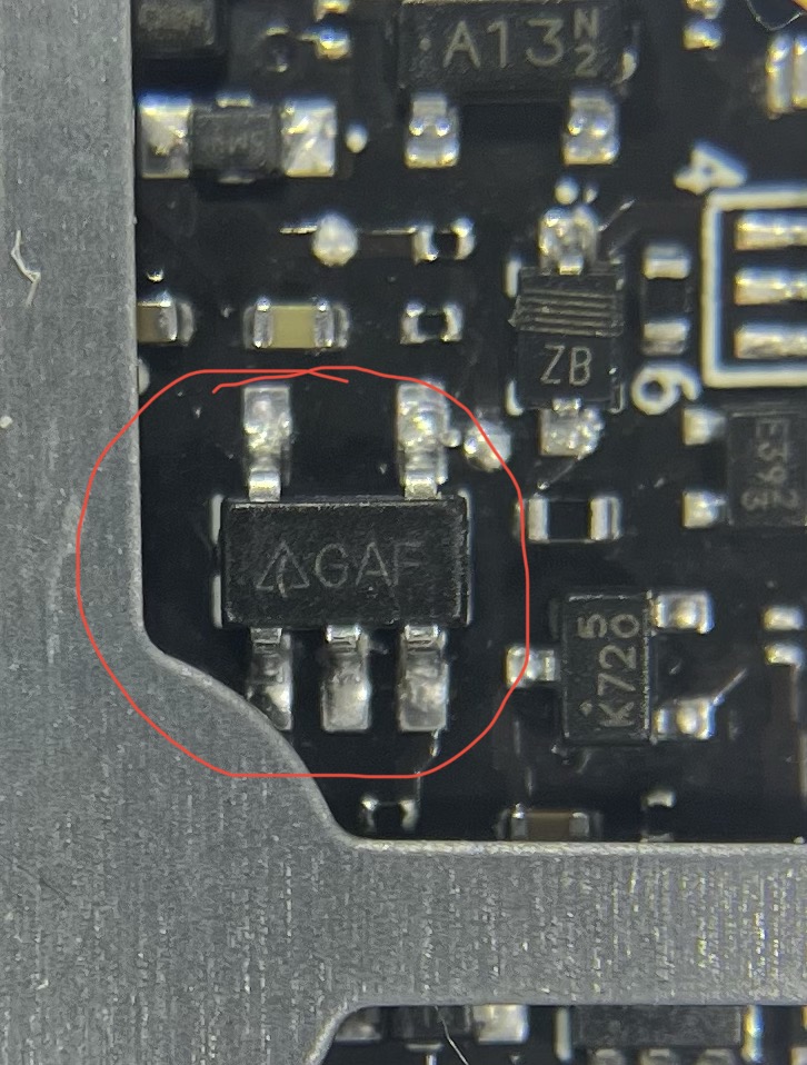

Can someone help identify this mosfet marked GAF ?
    This mosfet is from surface 2 go and if i try power it on this is only component what is heating.cant find schematics to identify this mosfet so maybe someone can help?

    Re: Can someone help identify this mosfet?
    Linear stabilizer AP2204K-ADJ GAF

      Thank you very much

        Re: Can someone help identify this mosfet marked GAF ?
        Here is the data sheet for this device
        https://cdn.badcaps-static.com/pdfs/...aed78f3519.pdf

          I am working on a HP Spectre that keeps resetting the charger. Using my thermal camera I found a component on fire, temps reaching 140c marked "GAF". Thank you for providing the actual component name. I ordered it today and hopefully this will solve the issue.

            I have the same exact issue. Did that solve your problem? The only ones I have found come from China so it will be a while before I can even test a new one.

              AP2204K-ADJTRG1 Diodes Incorporated | Integrated Circuits (ICs) | DigiKey
