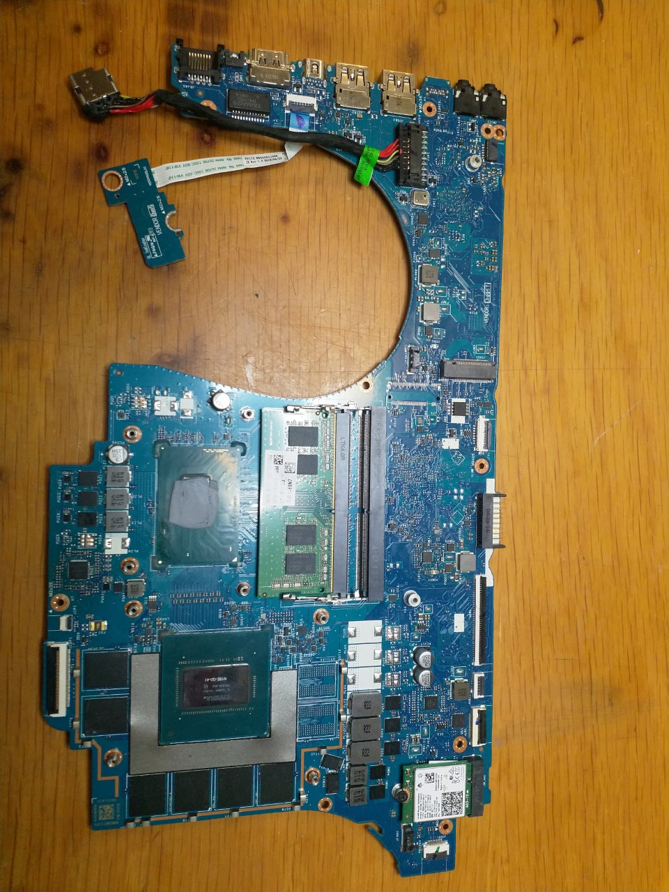

    Hi everyone
    i have this laptop from HP with motherboard LA-H492P
    it powers on with battery but not with ac
    if i connect ac the battery it starts charging (led is orange on dc-jack)
    if i press power then laptop powers on (using the battery) and battery stops
    charging (dc-jack led turns white)
    If i remove the battery and connect ac then laptop doesn't power on
    The laptop motherboard is LA-H492P , i have replaced the battery charge IC
    (iSL88739) but i still have the same symptoms.
    I am uploading the schematic and photos in case someone can help me find the problem

    Re: HP OMEN 17 not power with AC
    voltage on PU801 pin 1 2 30 31 32 29 & PQ801 all pis PQ803 all pin ?
      you mean PUB01 (isl88739) ? i cant find PU801 in schematic
      PIN 1 2.21v
      PIN 2 2.85v
      PIN 30 19.17v
      PIN 31 19.05v
      PIN 32 18.6v
      PIN 29 19.65v
      these are the voltages without battery connected
      PQB803 has 19.17v on pins 1,2,3 and 19.7v on the rest
      PQB801 has 19.7 on pins 1,2,3 and 19.17v on pin 4, 19.7v on pins 5,6,7,8
        PIN 1 2.21v
        PIN 2 2.85v
        PIN 30 19.17v
        PIN 31 19.05v
        PIN 32 18.6v
        PIN 29 19.65v
        ok my mistake PUB01 you ACDRVE voltage is low should be above +22V to 28V
        do a cool checking no power multimeter ohms test S D G PQB01/3 both of them
                      sorry for the late reply as i had a few days internet downtime,
                      using beeper mode PQB03 shows 550 and PQB01 buzzes like its shorted
                      using ohms mode (2M ohm) PQB03 Source is 400, Gate shows nothing and Drain is 400 (these numbers fluctuate a bit from 390 to 410)
                      PQB03 S 397 G nothing and D nothing also , i did the measurerments with black lead on ground and red lead on the legs of the mosfets
                      i will desolder PQB01 to see if it is really shorted
                          Originally posted by mobotest
                          @Am0rPHiA
                          Any update?
                          i removed PQB01 and discovered beneath a smalll wire connecting source to drain, apparently someone did this to bypass the fault and get 19v but it didin't work correctly but with the symptoms i described earlier.
                          now without the wire i have the following voltages
                          PQB01 drain 19v source 3.37v gate 4.8v
                          PQB03 drain 3.26v source 3.38v gate 4.8v
                          on PUB01
                          PIN 1 2.21v
                          PIN 2 2.85v
                          PIN 30 4.80v
                          PIN 31 3.24v
                          PIN 32 2.8V
                          PIN 29 3.37v
                          are there any known equivalents to replace PQB01 and PQB03?
