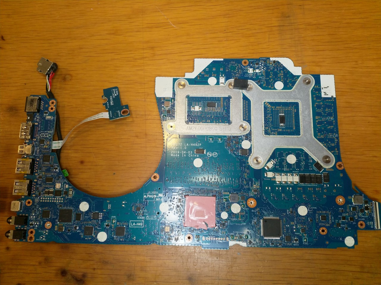

    Hi everyone
    i have this laptop from HP with motherboard LA-H492P
    it powers on with battery but not with ac
    if i connect ac the battery it starts charging (led is orange on dc-jack)
    if i press power then laptop powers on (using the battery) and battery stops
    charging (dc-jack led turns white)
    If i remove the battery and connect ac then laptop doesn't power on
    The laptop motherboard is LA-H492P , i have replaced the battery charge IC
    (iSL88739) but i still have the same symptoms.
    I am uploading the schematic and photos in case someone can help me find the problem

    voltage on PU801 pin 1 2 30 31 32 29 & PQ801 all pis PQ803 all pin ?

      you mean PUB01 (isl88739) ? i cant find PU801 in schematic
      PIN 1 2.21v
      PIN 2 2.85v
      PIN 30 19.17v
      PIN 31 19.05v
      PIN 32 18.6v
      PIN 29 19.65v
      these are the voltages without battery connected
      PQB803 has 19.17v on pins 1,2,3 and 19.7v on the rest
      PQB801 has 19.7 on pins 1,2,3 and 19.17v on pin 4, 19.7v on pins 5,6,7,8

        ok my mistake PUB01 you ACDRVE voltage is low should be above +22V to 28V
        do a cool checking no power multimeter ohms test S D G PQB01/3 both of them

          My HP laptop (DIFFERENT than your model) had similar symptoms.
          If you want to try something quick for a possible fix, read further.
          I had parts corresponding to MOSFETS PQB01, PQB03, PQB05 and CHARGE IC PUB01 replaced on my laptop.
          Pin4 on PQB01, PQB03 should be about 25V to open the MOSFETS and let adapter voltage through to power the laptop.
          Pin30 on PUB01 provides that voltage, but you have already replaced PUB01 so now replace PQB01, PQB03.
          PQB05 is involved in charging the battery. Replace it if replacing PQB01, PQB03 does not solve all the problems.
          FYI: PQB04 lets the battery voltage through to power the laptop. Since your laptop is booting ok from battery, PQB04 is ok.

                      sorry for the late reply as i had a few days internet downtime,
                      using beeper mode PQB03 shows 550 and PQB01 buzzes like its shorted
                      using ohms mode (2M ohm) PQB03 Source is 400, Gate shows nothing and Drain is 400 (these numbers fluctuate a bit from 390 to 410)
                      PQB03 S 397 G nothing and D nothing also , i did the measurerments with black lead on ground and red lead on the legs of the mosfets
                      i will desolder PQB01 to see if it is really shorted

                          i removed PQB01 and discovered beneath a smalll wire connecting source to drain, apparently someone did this to bypass the fault and get 19v but it didin't work correctly but with the symptoms i described earlier.
                          now without the wire i have the following voltages
                          PQB01 drain 19v source 3.37v gate 4.8v
                          PQB03 drain 3.26v source 3.38v gate 4.8v
                          on PUB01
                          PIN 1 2.21v
                          PIN 2 2.85v
                          PIN 30 4.80v
                          PIN 31 3.24v
                          PIN 32 2.8V
                          PIN 29 3.37v
                          are there any known equivalents to replace PQB01 and PQB03?
