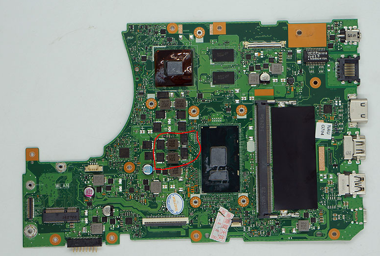

                            #53
                            Re: Asus R702UA dead (missing voltage)
                            Hi All.
                            i got question too board x556uv, the circle on picture below dont have voltage.
                            Can someone help?

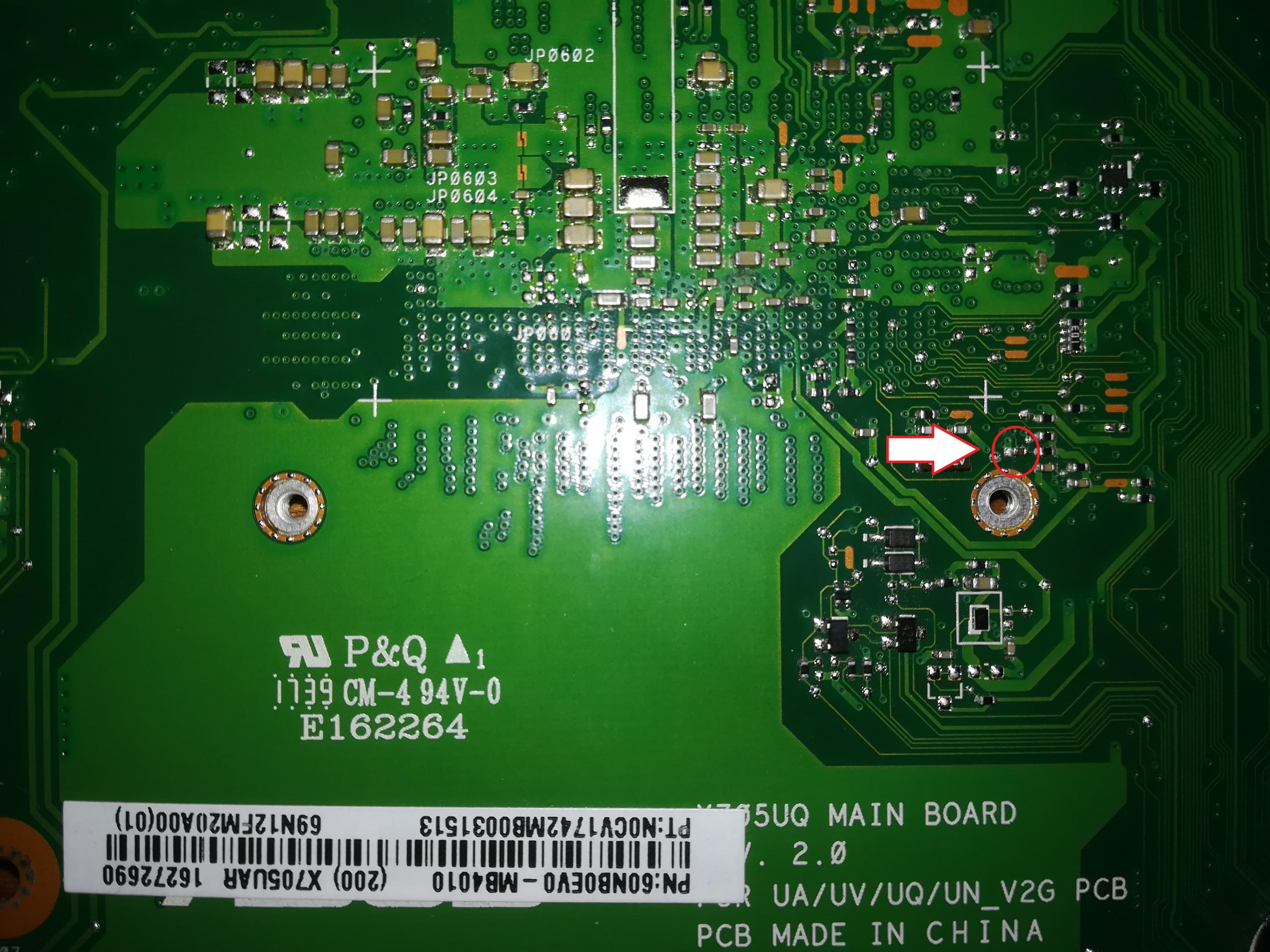

                                    #57
                                    Thanks a lot guys, thanks to this topic I did manage to solve the problem. I found the cap and replaced it with one from a scrap board.
                                    In case someone else runs in to this problem, attached is an image of the cap that needed replacement.

                                      #58
                                      Nice job, and thank you for the picture, I should have post one myself back in time.
                                      Edit: if people ask about the value, it's something like MLCC 1uF 6.3v 10%
