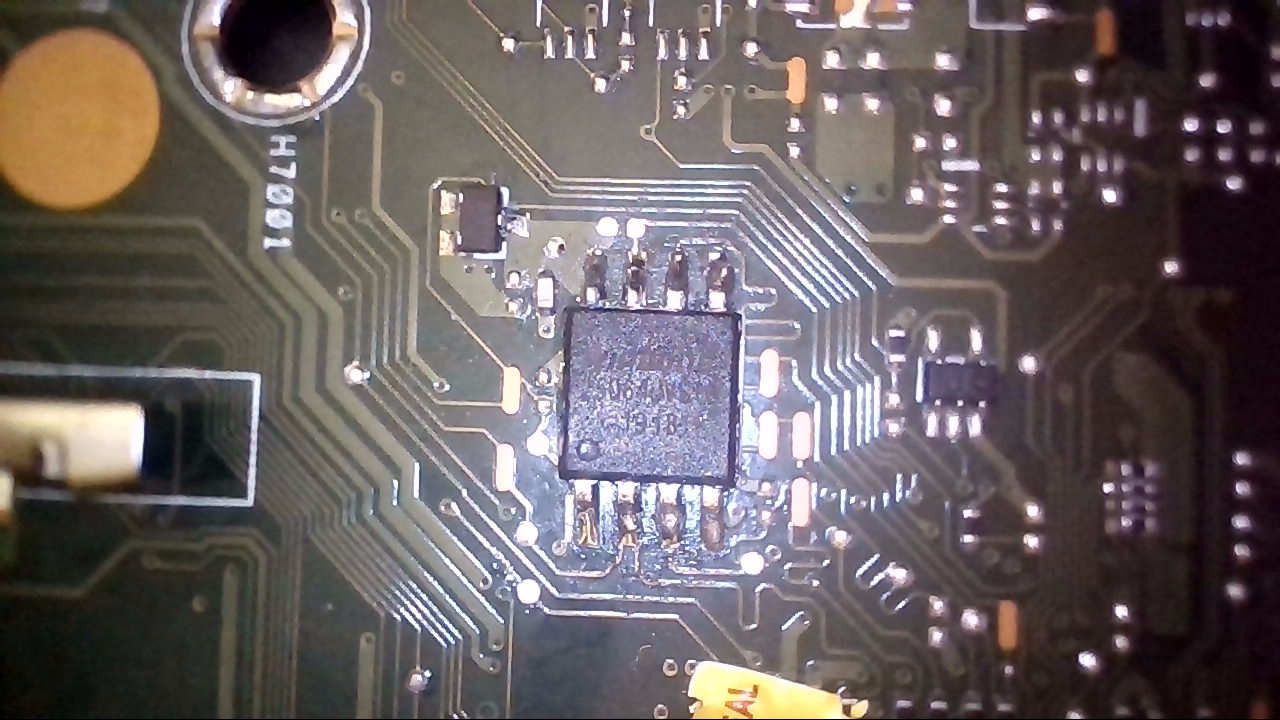

      can you check again if pin 96 goes to 0V & come back & test Ohms on that pin 108 is connected to 10K R test voltage other side.
      UP LODE A PIC near BIOS IC
      what is the voltage on pin 111 on SIO this pin actives +3VA that you have marked (coil left red 3.32V) to +3VSUS & +3VA ECO

        96 stay 3.3V, doesn't go to 0V when I press power.
        pin 108 isn't connected to a resistor, the trace go on the other side of the board and there is nothing backside.
        111 is 3.3V

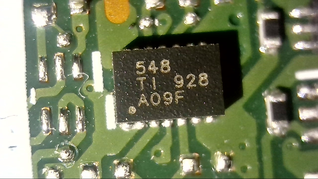

              I think I've found the PU8803 equivalent IC on my board, it's 548 ti 928, 14pins, and I have 3.3V on 8 9 13 and 14.
              Still searching for the RTC diode

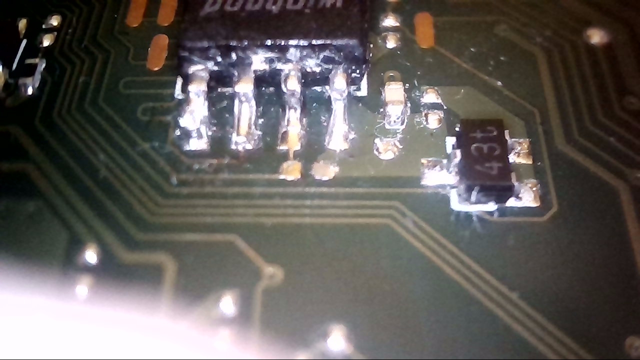

              edit : I did test all schottky diode marked 42t and 43t, none are shorted or cut, but still no idea which one is RTC

                do you have another BIOS chip to replace & try ? what is the voltage on bios chip except pin 4 & 8 as you power the MB

                  edit: I have 3.3V on all pins except the pin4 obviously.

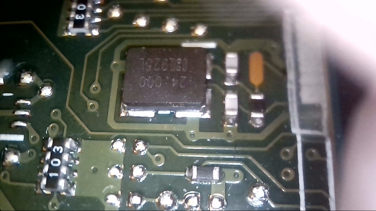

                    there is a crystal in the MB near SOC CPU X2401 you have 2 caps or resistor what is the voltage on side GND other voltage may be 0.6xx,

                      On bios chip, all pins except 4 and 8 are stable 3.31V pressing power or not doesn't change anything. Pin 8 is 3.27V stable too.
                      Pic related for the crystal, two caps and one resistor I guess, they are sometimes 0.28V, sometimes 0.22V

                                      Here is the pic of the IC we spoke in #26
