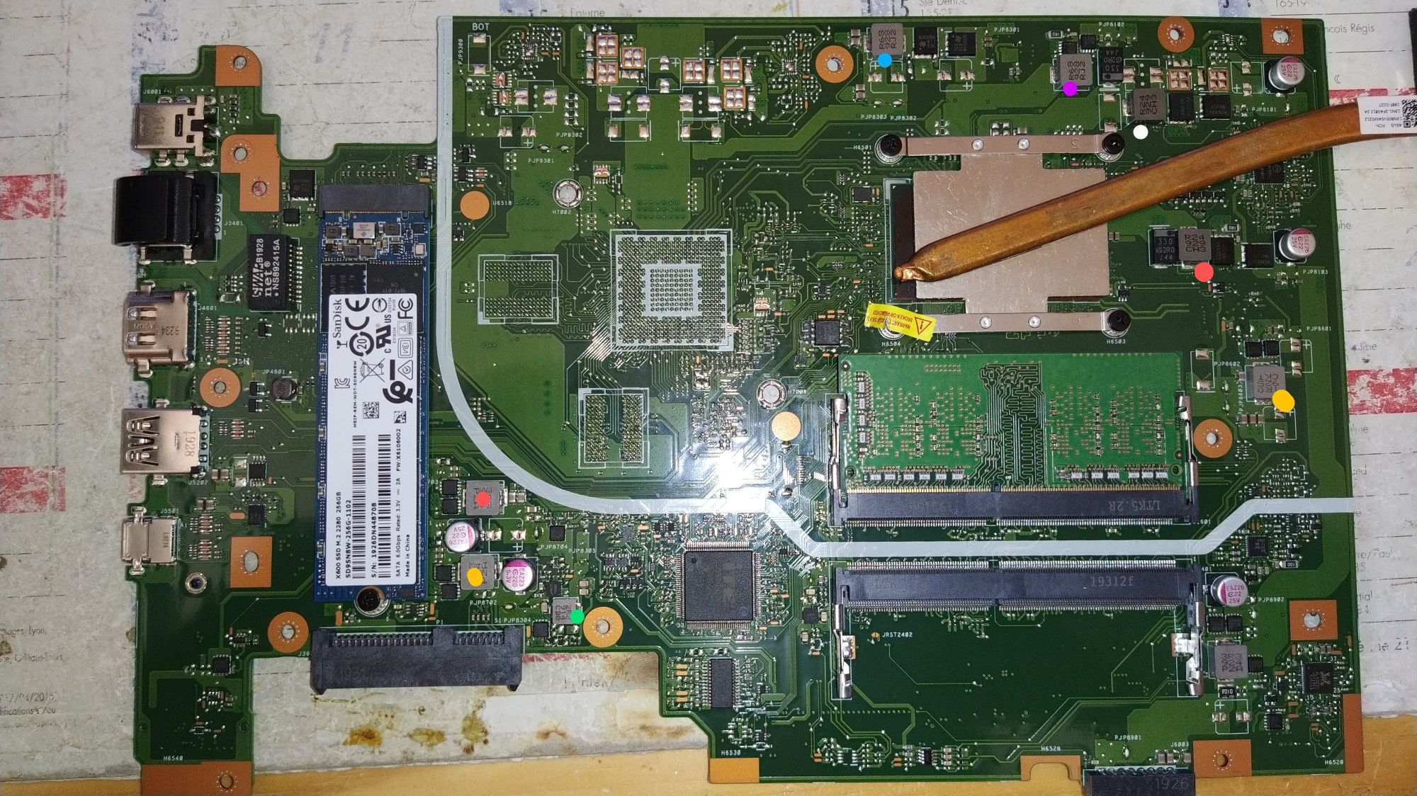

    Hello guys,
    I have this laptop, can't figure it out what is the problem.
    The battery is dead 2V.
    Few month ago the laptop died but just remove the battery 30sec and it went alive.
    This time is different, I have 3.3V, 5V, 0.8V and 1.1V power supply alive even it's off, when I try to power on, white LED light, but no change on power supply, 4 of them still dead 0V (CPU and RAM)
    What should I check?
    Thanks!
    Mainboard sticker say X705UAR, mainboard itself is X705UQ V2.2

    Re: Asus R702UA dead (missing voltage)
    Bordview is not out try to request in Schematic section CPU Core coils will not genarate until RAM section is cleaired upload pic of the MB & mark the Voltages one the coils RAM IC number ? RTC section is Good ?
      Thanks for reply.
      I join a pic of the mobo with color spot, here the value:
      left red 3.32V
      left yellow 5.18V
      left green 1.87V
      blue 1.03V
      purple 0V
      white 0V
      right red 0V
      right yellow 0V
      3.25V on bios chip
      The IC under ram power suply is uP9002P 8GR920
      The IC for CPU is NCP81236A
      I you want closer photo on a small zone I can do it.
      Thanks.

        PWM CONTROLLER UP9002 pin 4 3 7 8 14 voltage ? & the 2 Mosfets connected to PWM check if no short on the 2 fets & the voltage of them , resistance to GND on coils with 0V
          All of these are 0V
          Not sure about the first part, but mosfet not shorted D/S or with G either.
          Ram coil to GND 166ohm
          RED coil 16 ohm
          white coil 8 ohm
          purple coil 80 ohm
          With that 2 low resistance I believe there is something wrong with CPU?
            Perhaps "Deep Sleep Well" issue. Do you have dc power supply?? If yes, then measure the consumption in off mode. Have you flashed bios??
            @techtiger, you may get core voltage but no ram voltage on coil in soc platform as soon you plug the adapter. Just solved such a case on quanta Y11A mb where consumption was 0.080A as soon as you plug in dc supply with no dc jack light but vcore @1.72V present but no ram volatge on coil. It was a problem with DSW and that's the reason 3/5V ALW always remain on.
                Hello mcplslg123, thanks for your help.
                I have DC poxer supply, the board take 19mA when off, and 22mA when "on"
                I try lot's of me clean, rebuild bios and even reflash ITE, nothing change.
                Any ideas?

                  since SOC cpu those coils show most of the time low resistance RAM coils also good what is your ITE XXX ?
                        Originally posted by alderick
                        It's an ITE IT8995E-128
                        check pin 83 1.2V ON
                          pin 83 is 0V
                            pin 83 is 0V
                            ok that's Bad now check pin 35 57 82 96
                              35 is 0V
                              57 0V
                              82 0V
                              96 3.3V
                                35 is 0V
                                57 0V
                                82 0V
                                96 3.3V
                                does the pin 96 RSMRST when press PWRBTW goes to 0V & come back to 3.3V you have to check the requarments of the SIO now par exemple VACC VA EC ect
                                  The pin 96 stay at 3.3V when I press the power button, while the white LED goes on.
                                  Edit: found pin, VACC is 3.3V and VA_EC is 3.3V too.
