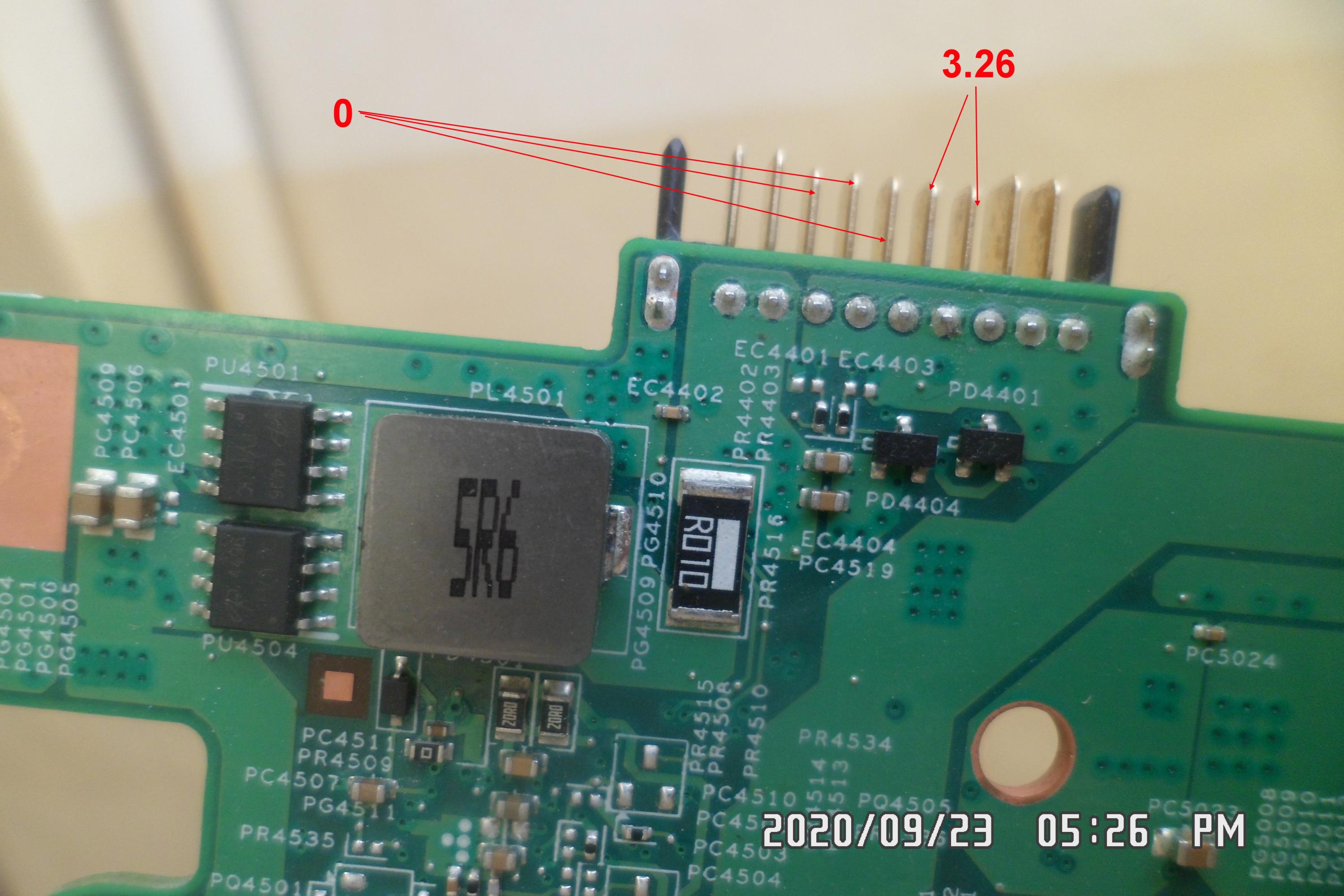

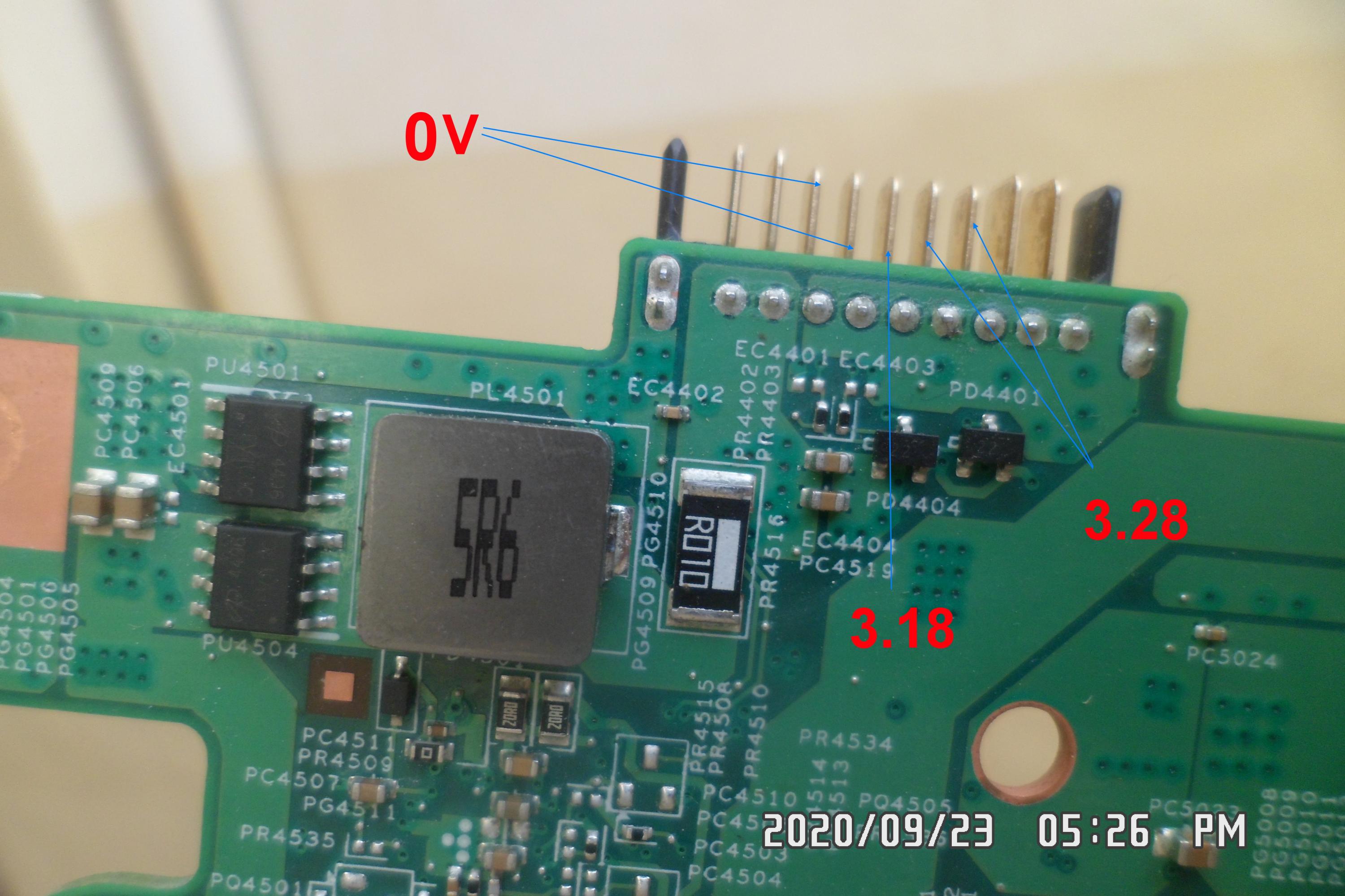

    Hey Guys,
    i have a dell 15 not charging the battery .
    here is the voltage

    There must be 100 dell 15 models....
    Post the motherboard part number,and the schematic (or a link to it if its already posted) .

      dv15 cp uma mb
      10263-1
      48.4ip01.011
        • 21439
        Re: dell 15 Battery not charging
        Originally posted by Gnikosalalalal33
        dv15 cp uma mb
        10263-1
        48.4ip01.011
        schematic. https://www.badcaps.net/forum/showthread.php?t=34711 .Remove the mosfet and check it for short S/G/D

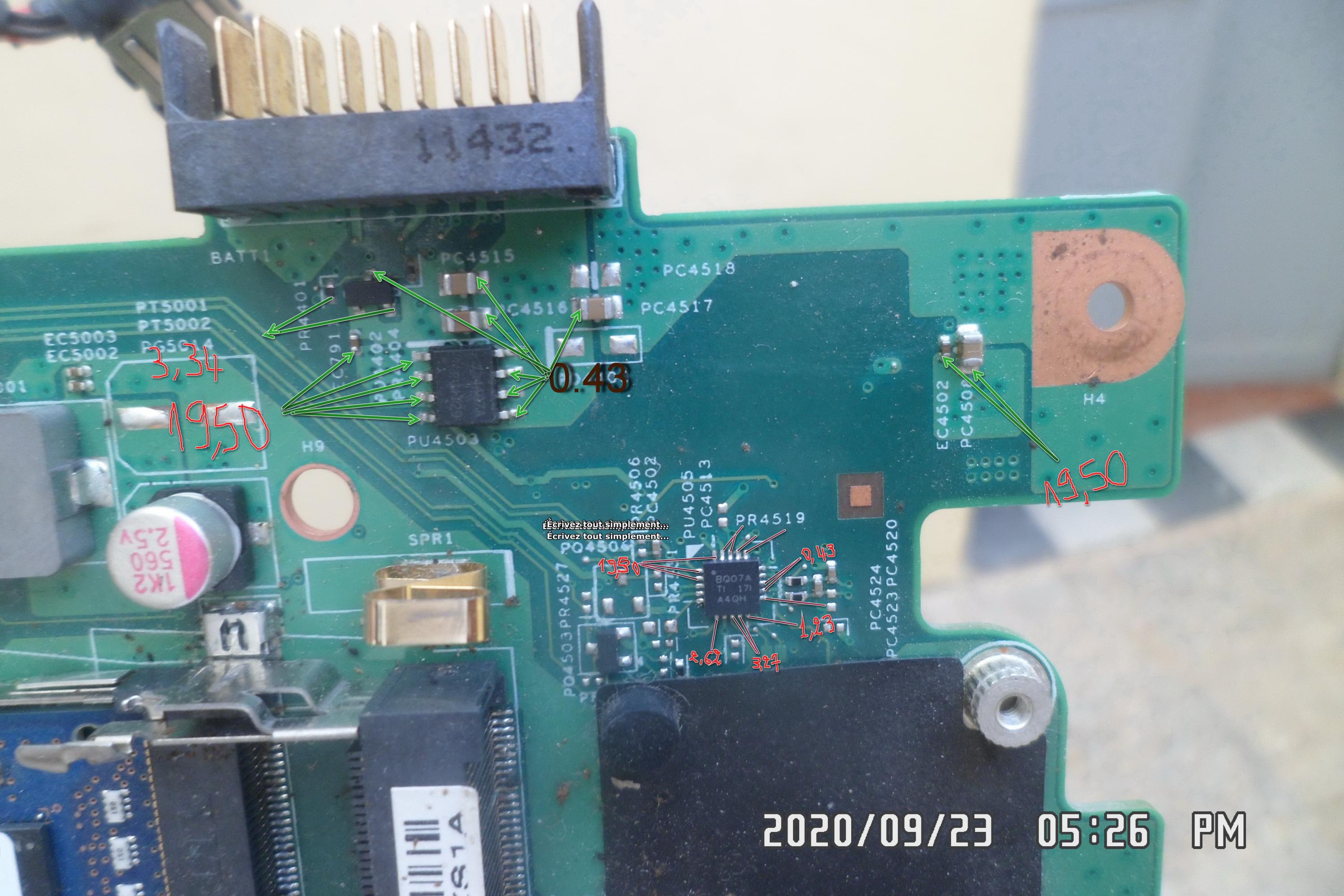

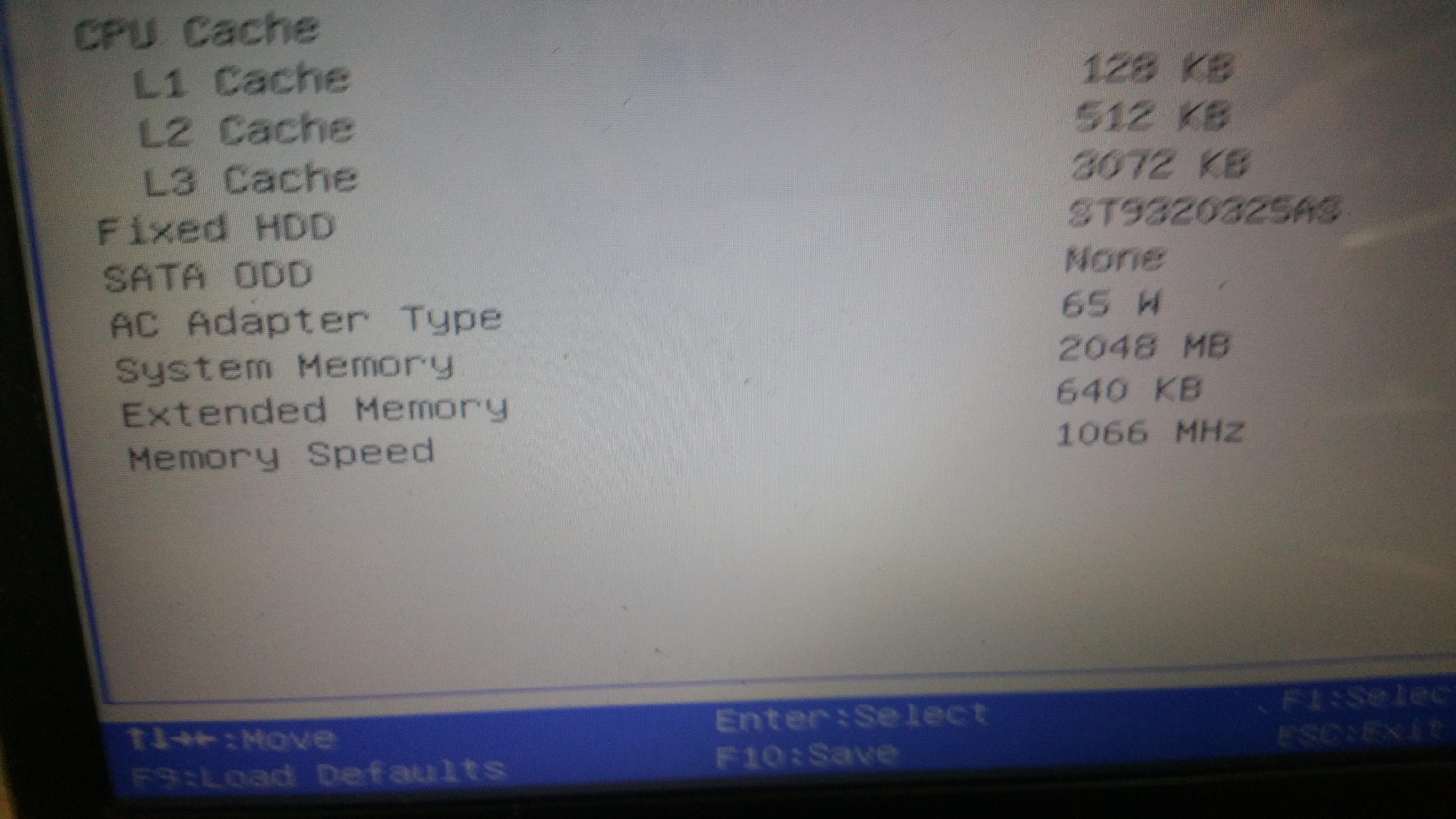

          Check charging/discharge mosfet first. IS the adapter recognised in bios setup??
            with battery

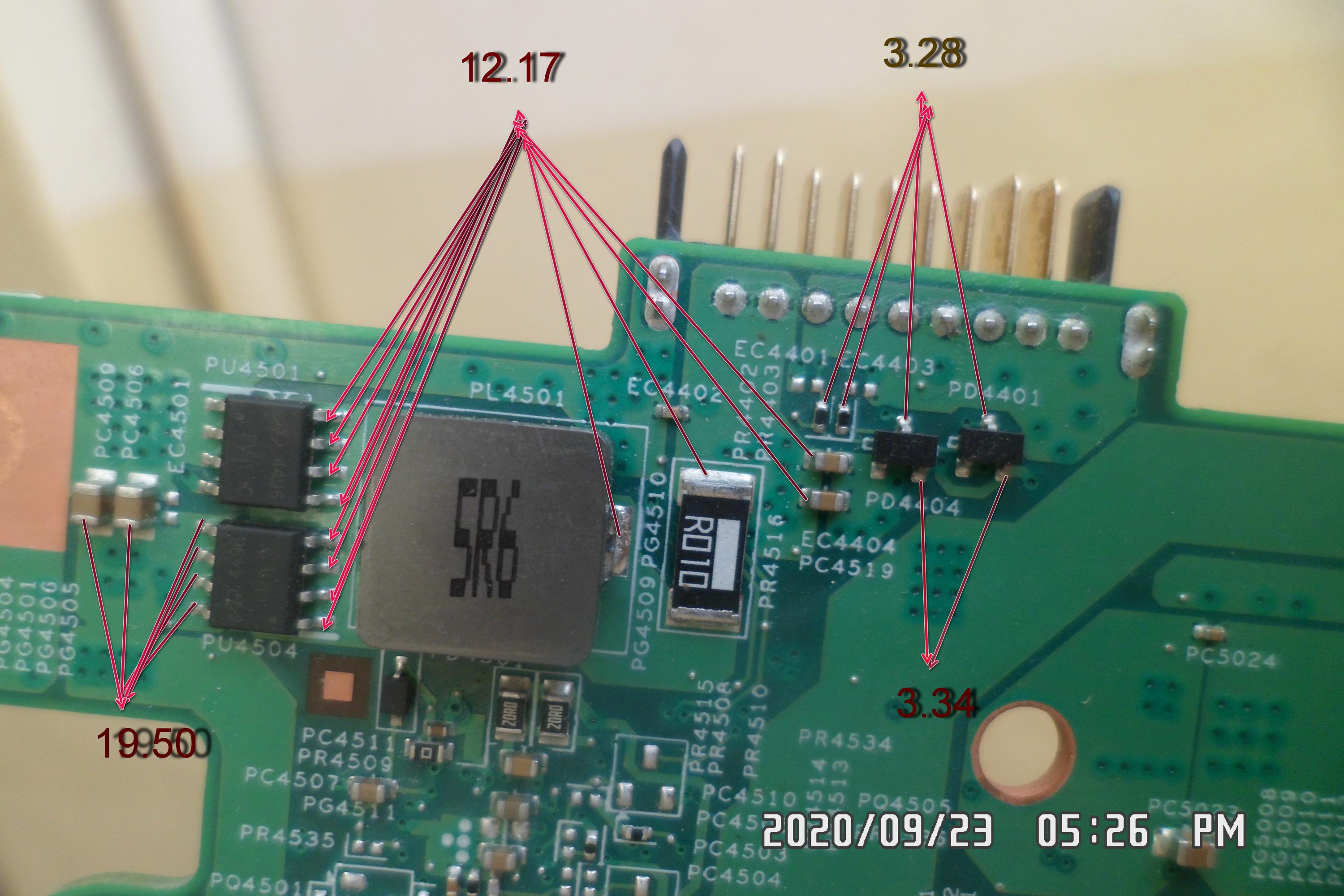

                  Didnt you read post#5
                  i have changed PU4501 AND PU4504 AND PU4503
                  AND I D'ont know if i change th BQ07A OR NO
                    Dont change components randomly without finding the fault. I asked for psid measurement which you are yet to answer. This way nobody can help you.
                        So do you mean problem solved or charger recognised but still not charging?? If still not charging ,measure charging IC pins voltage and post here.

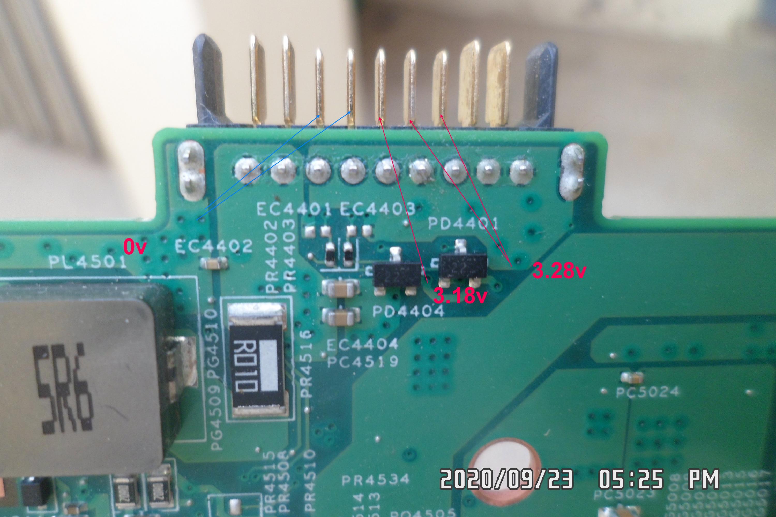

                            here is charging IC pins voltage
                            • mcplslg123
                              • Jun 2015
                              • 7262
                              • india
                              Your Measurements are incomplete and preety useless. Measure ACDET/ACOK/ACDRV/REGN pins.
                                problem resolved after change BQ07A
                                thanks to all especially mcplslg123
