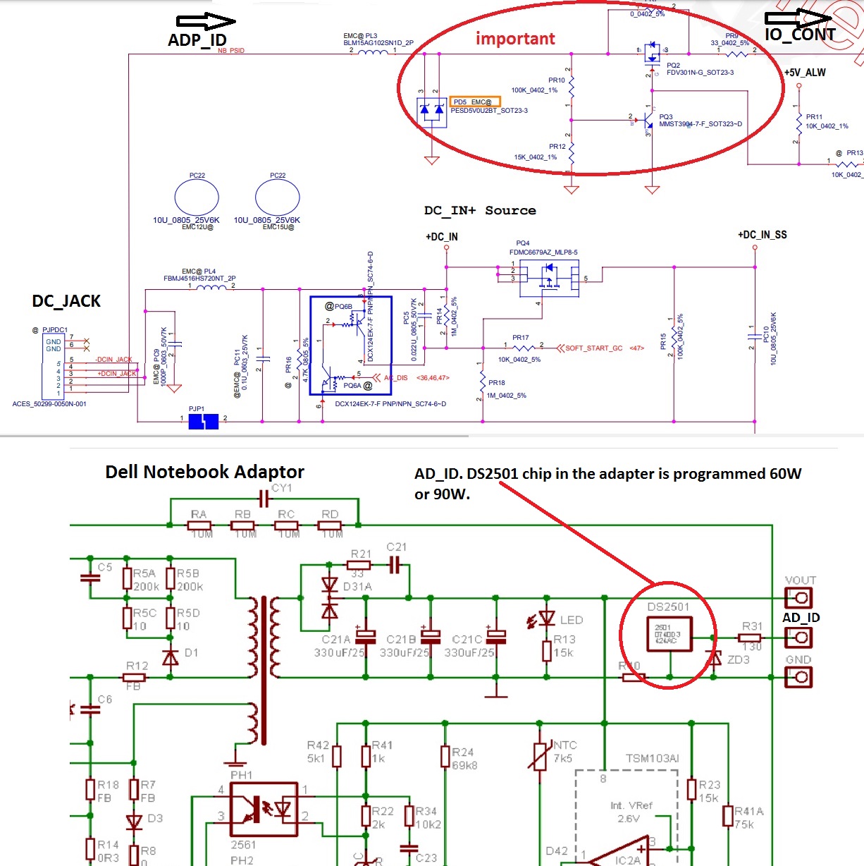

    Then I found these schematics:
    https://www.badcaps.net/forum/attach...5&d=1517020862
    (original post: https://www.badcaps.net/forum/showpo...7&postcount=13 )
    And took some measurements of PJPDC1 and PBATT1:

      Re: Dell Inspiron 15 5559 AAL15 LA-D071P battery not charging
      Check pin 36 of kbc MEC-1404 for 3.3V. This is your ps id signal. Dell are known to have failure in ps-id circuit. But first check the voltage on that pin and report back.

            The genuine Dell charging cable came in today and... It seems to be working. Does this mean Dell actively prevents third-party chargers from working? Is that even legal? Especially when so many universal chargers also claim to work on Dells?
              thats for "middle pin" is made
              dell wont charge for many years. now there are many vendors that is using middle pin/hp lenovo .../

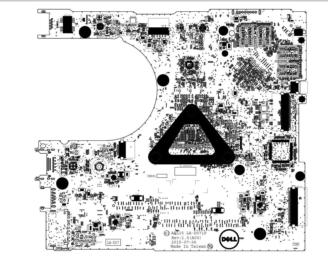

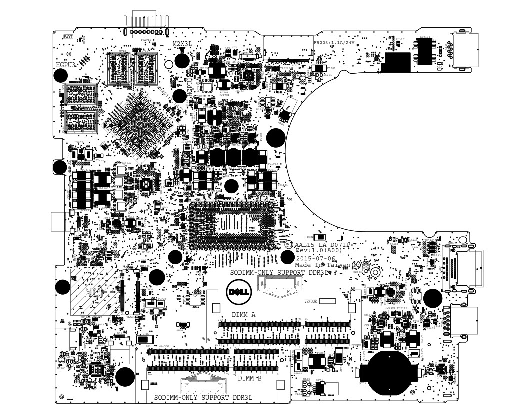

                            @giagi - does your logic board look like the attached ?
                                  After you open the box - confirm if the logic board looks like what I posted earlier.
                                      yes the board looks like the one you posted
                                      except the numbers on mine are
                                      AAL12 LA-C142P
                                      rev3 (A02)
                                      2015--05-19
