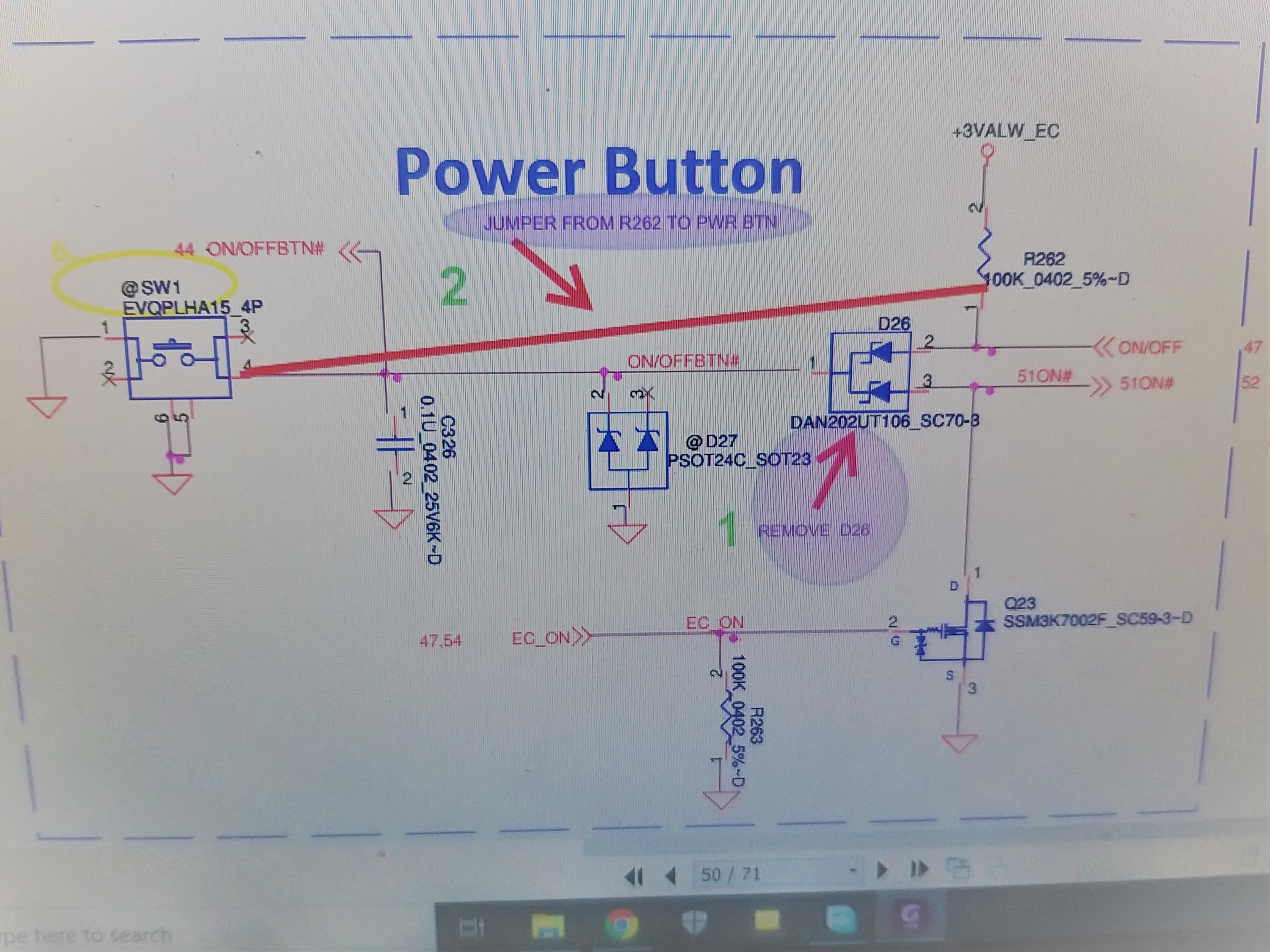

        remove D26 and make a jumper from R262 to power button Pin 4 I have solved 1 issue in Acer through bypass 51on logic

          Re: Alienware M17x R4 no power, low resistance 5v/3.3v to GND
          since dellxps has found that his board powers on with 19v on the power button, i don't think this is the issue, however i can try it if there are no other options.
          @dellxps15 do you have voltage at PL10 and PL11 when in off state?
              Weird that there is such a difference between r3 and r4... Ok i'll give the jumper wire a try.
                wait before make a jump wire.... 3.3 and 5 volt should come even if we have 19 volt on power botton.
                check all 3.3-5 volt ic contact and pins before do anything, because i read u worked on that area.
                on some post over i posted if u have 3.3 volt on mosfet near kbc...
                read post #18
                  Yeah all contacts are ok, but i have all 4 fets off and both coils and caps, i'll first put those back since we figured that 15ohm is ok as the r3 board has 15ohm too,
                  I replied to #18 in #20
