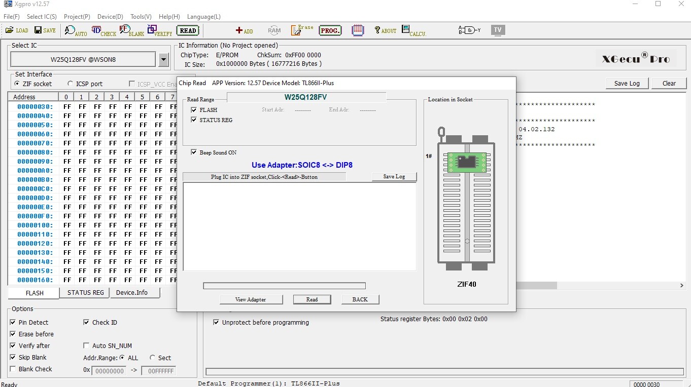

        I want to read W25Q128FVPQ with EZP2019+ but canr read.
        what can I use to read/write W25Q128FVPQ
        This box can support all kinds of chips you can refer to .

          Hello friends please I have problem with the new EZP 2023 programmer, after insering the chip into SOIC, when I read the bios is says chip empty. Anyone with the solutiaon

            That's a driver problem.
            Drivers are included with the software.
            Go to Device Manager and look under USB
            Install the driver for the EZP2019 programmer.
            Problem solved.
            Don't forget to deactivate the driver signature :-)
