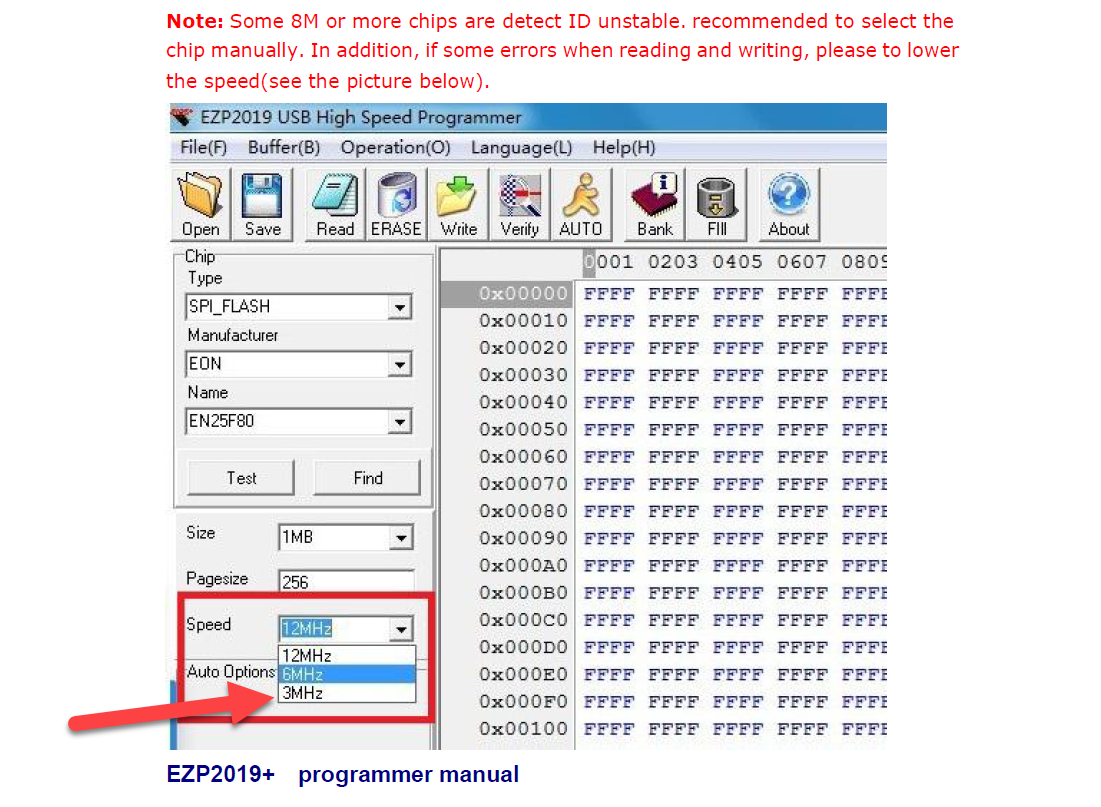

          I recently got EZP2019+
          I am trying to read Winbond W25Q128FVPQ but always getting not detected message.
          I am using SOC8 pin socket that came with programmer.
          I am selecting W25Q128 inside EZP2019+ software available chips.
          Is there anything I am missing ?
          • mon2
            • Dec 2019
            • 14720
            Re: Help with bios programmer (EZP2019+)
            Manually slow down the SPI flash data rate to 3 Mhz as per attached graphic and test again.
            Please post your results.
