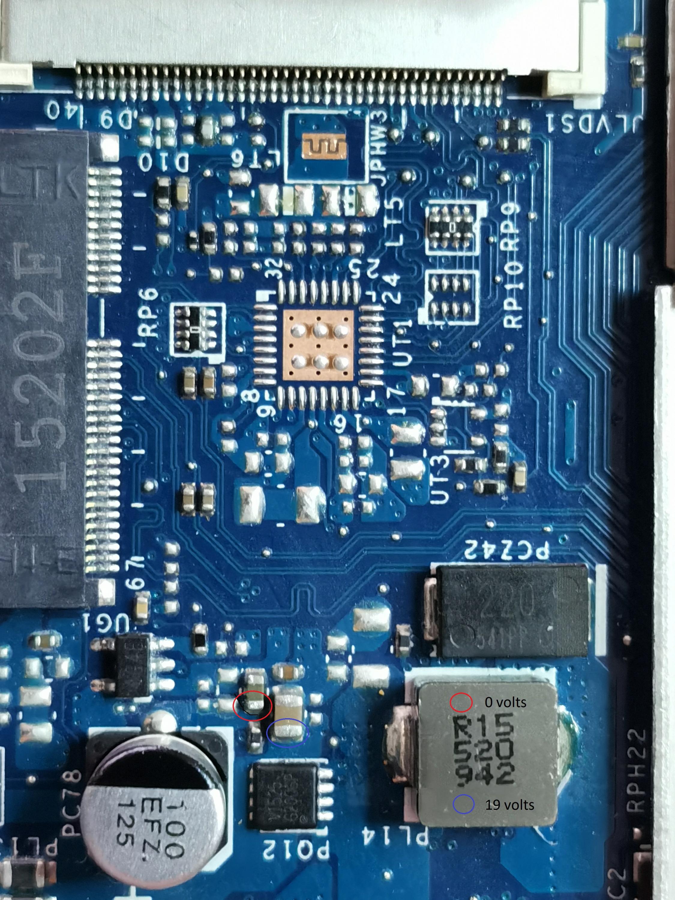

    Hello, i have this Hp board (LA-C701P), it work but no image (only with external monitor) when i power on the lcd stay a more black but no image, i have change the lcd without results.
    Any idea?

          Pin 15 and 16(+LCDVDD) in board connector is 0v, i dont have a 2º cable to test but the pin 1 and 2 dont have continuity between the connectors and according the Schematics i have pin 1 and 2 are (LVDS_TXP0, LVDS_TXN0).
          maybe a cable problem?

                Check UG1 pin 1 3 4 5 voltage & check INVPWR_B + 19V on the LVDS 28/29

                  Re: HP Board La-C701P-Work only with external Monitor
                  28 and 29 , 19v
                  4,5 - 3,3v
                  1,2,3 - 0v
                    Back trace R172 should be near the IC what voltage other side ? Short pin 5 & 1 just to check voltage is crossing +3V
                        You have to keep holding from a tweezer or put a jumper that voltage must cross over , check voltage LVDS pin 37 38 27 28 15 16 screen must be connected
                            When i short (1,5) i lost de 3,3v in pin 5 (stay o volt) only 3,3 v in pin 4, with the short 37,38 - 0 v; 27,28-19v; 15,16-0v
                            Without short same voltage in LVDS
                              remove UG1 & test all pins again for voltage after test Ohms in pin 1 you have 2 caps in this line CG2 CG3 test one of the are fault or not their is another prob DATA & CLK is missing on pin 37 38 LVDS was the screen connected when you check voltage ?
                                I dont see the capacitores, do you see them in the image i attached? yes when i test the pins 37,38 the screen was connected...
                                  i remove the UG1, and only in pin 4 i have voltage (3,3v)
                                    Hello i have correct the issue, thanks for the help techtiger, like you say when i remove the UG1 and short pin 1-5, i have have all the voltages in the lvds pins, but still not working, so o chage the cable, and now are working...
