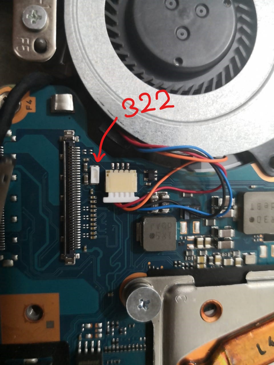

    hello all,
    I have Toshiba tecra Z40-A1241 laptop, there is a picture on it's screen but with no light on the screen, I test the screen on another laptop and it works perfectly,
    and test the video cable and it also works. As shown in below picture I want to know what this white part(it has a 322 number on it's surface)? fuse or something else? I can't find laptop schematics.
    please help me.

    Re: What is this part??
    i think it's crystal
      Can remove it and connect directly? I can not find a replacement
        If it's a crystal than you can't
        but i think it s not a crystal...you have a picture but no backlight
        with lvds cable connected, take all the measurements and post it here
        if you have a schemayics post it
          Unfortunately, I don't have schematics. On one of it's sides there is 19.0 volts and on the other side there is no volt.
            no you can't, it won't work if you connect directly/jumper.
            what is your board code ?

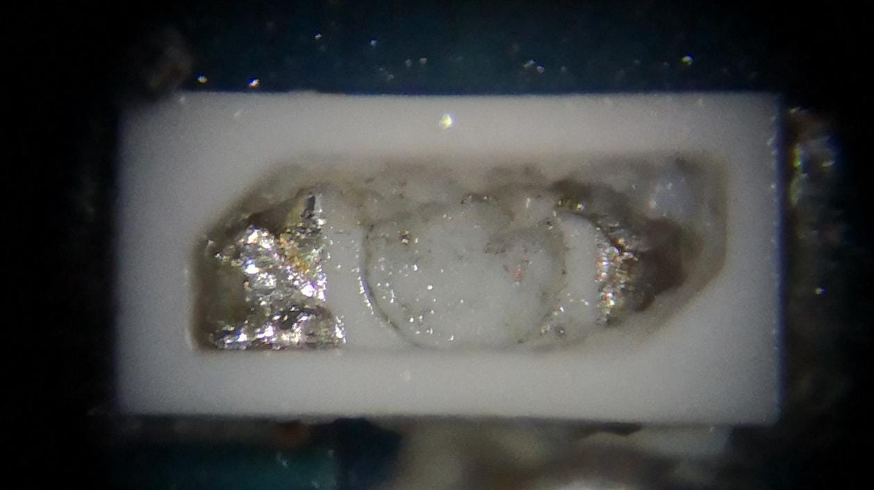

                this is the part under microscope
                and this after removing silicone on it
                    the part is marked as 322 and it cant be crystal. Let the part remain removed and power on the mb and check voltage on both pads of that part. Its likely to be a fuse but first check voltage reading.
                      measure ohms across the good one .
                        Thank you, it is a fuse I connect it directly and the screen works !!
