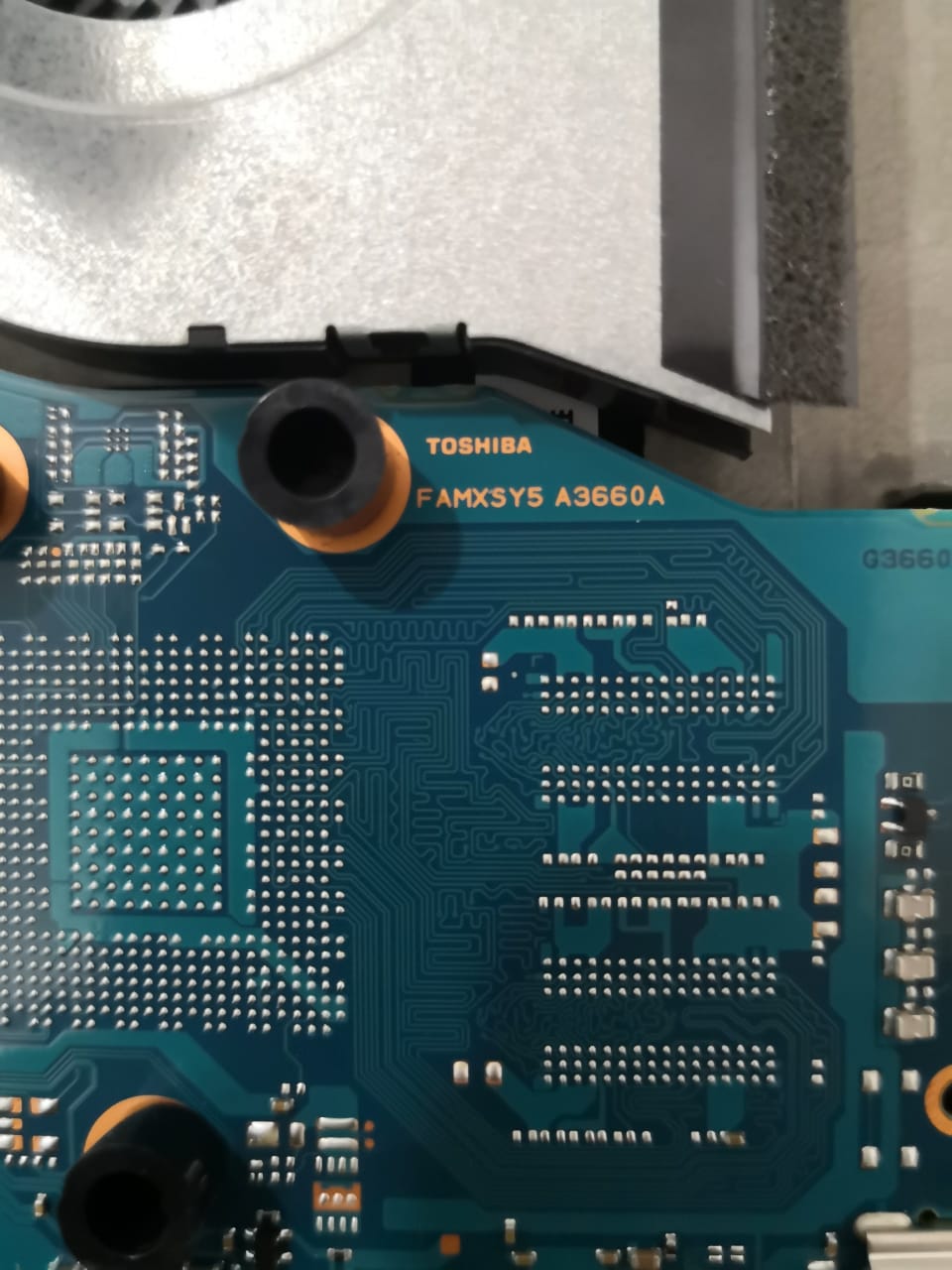

    hello all,
    I have Toshiba tecra Z40-A1241 laptop, there is a picture on it's screen but with no light on the screen, I test the screen on another laptop and it works perfectly,
    and test the video cable and it also works. As shown in below picture I want to know what this white part(it has a 322 number on it's surface)? fuse or something else? I can't find laptop schematics.
    please help me.

          Unfortunately, I don't have schematics. On one of it's sides there is 19.0 volts and on the other side there is no volt.

            what is your board code ?

              What is your board code ?
              [ATTACH]217341[/ATTACH]

                  Motherboard Code: toshiba famxsys a3660a

                    the part is marked as 322 and it cant be crystal. Let the part remain removed and power on the mb and check voltage on both pads of that part. Its likely to be a fuse but first check voltage reading.

                      measure ohms across the good one .

                        Thank you, it is a fuse I connect it directly and the screen works !!
