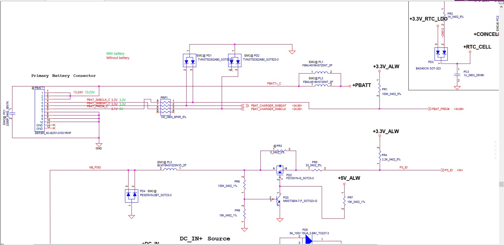

    Hello!
    I have problem with this laptop. Not charge the battery, but it works with it.
    MB num: CDM70 LA-E082P Rev:2.0(A01)
    When i plugged DC adapter the charging led is light few secound then goes out.
    The laptop has a not genuine battery, but i tried also with new, working Genuine battery. The charger is genuine dell 65W charger,i tried also 90W dell charger.
    I measured battery connector with and without battery.
    I think the ISL88738 is bad but i'm not sure.
    Can anyone help me?

    Start by give us the 32 pins voltage.

      32pin bgate:12.5V

          The charger wattage - is it correctly recognized in the bios?

            It cannot identify the charger.

              If it cannot identify the adapter wattage correctly, problem is PSID. Charging IC is likely to be ok. Measure PS_ID signal.

                PS_ID is short to ground.

                  Most probably PD4 ESD diode is the problem, remove it and check again. And dont use HP or replacement noname chinese power supplies on a Dell machines!

                    Yes, the esd diode caused the problem. i found it when i wrote prev. post
