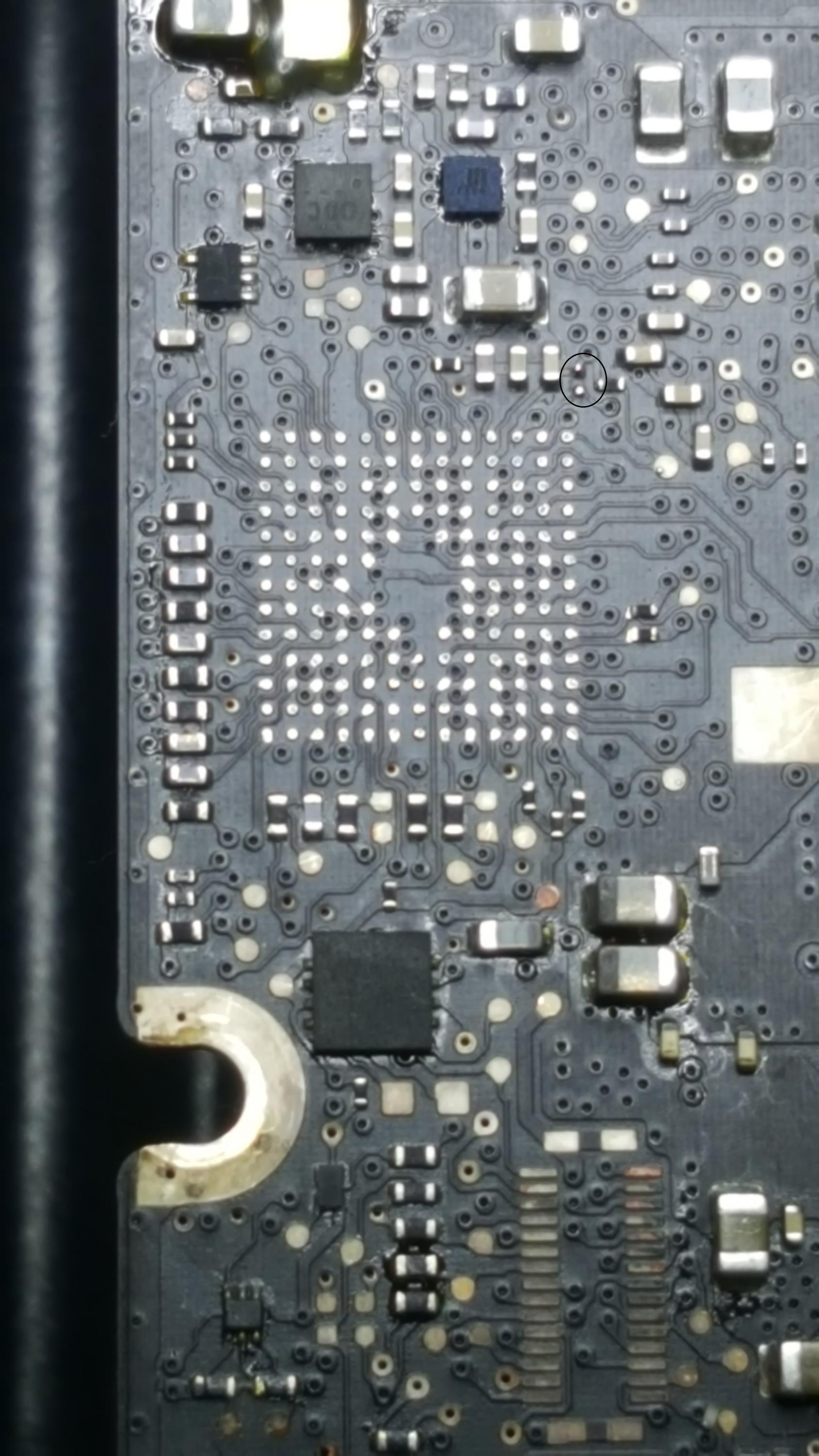

    A1278 Board 820-3115-B
    Component - R5081
    Is 10K ohms the proper value for this part?
    Page 50, Sheet 46 of SMC SUPPORT shows SMC_BIL_BUTTON_L connected to a 10K 1/20W resistor but it shows it connected to PP3V3_S5_SMC. Boardviewer shows SMC_BIL_BUTTON_L connected to pin 1 and PP3V42_G3H connected to pin 2.

    Schematic indeed says 10K.
    PP3V3_S5_SMC is PP3V42_G3H.
