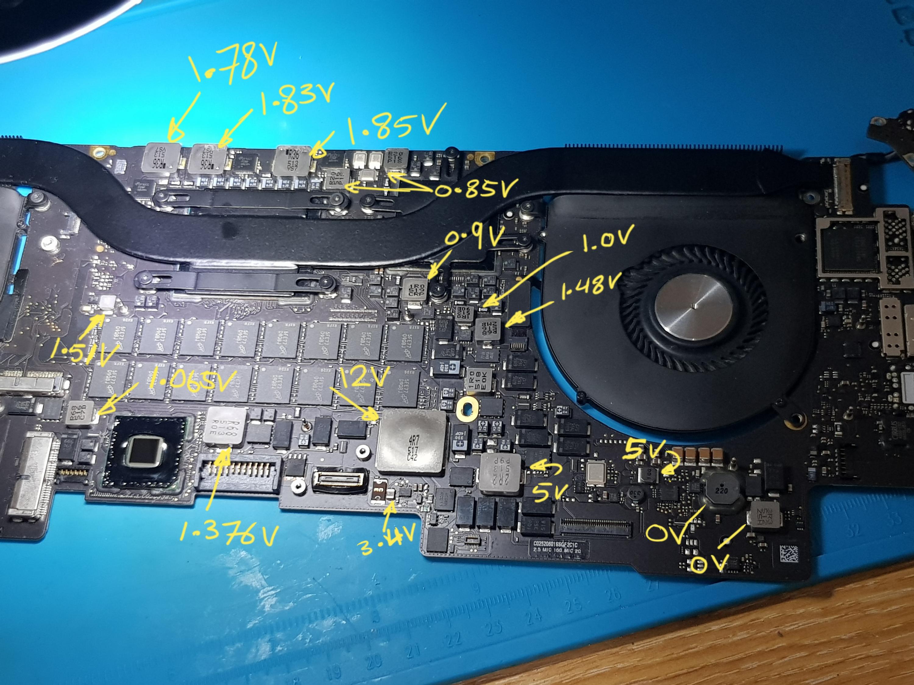

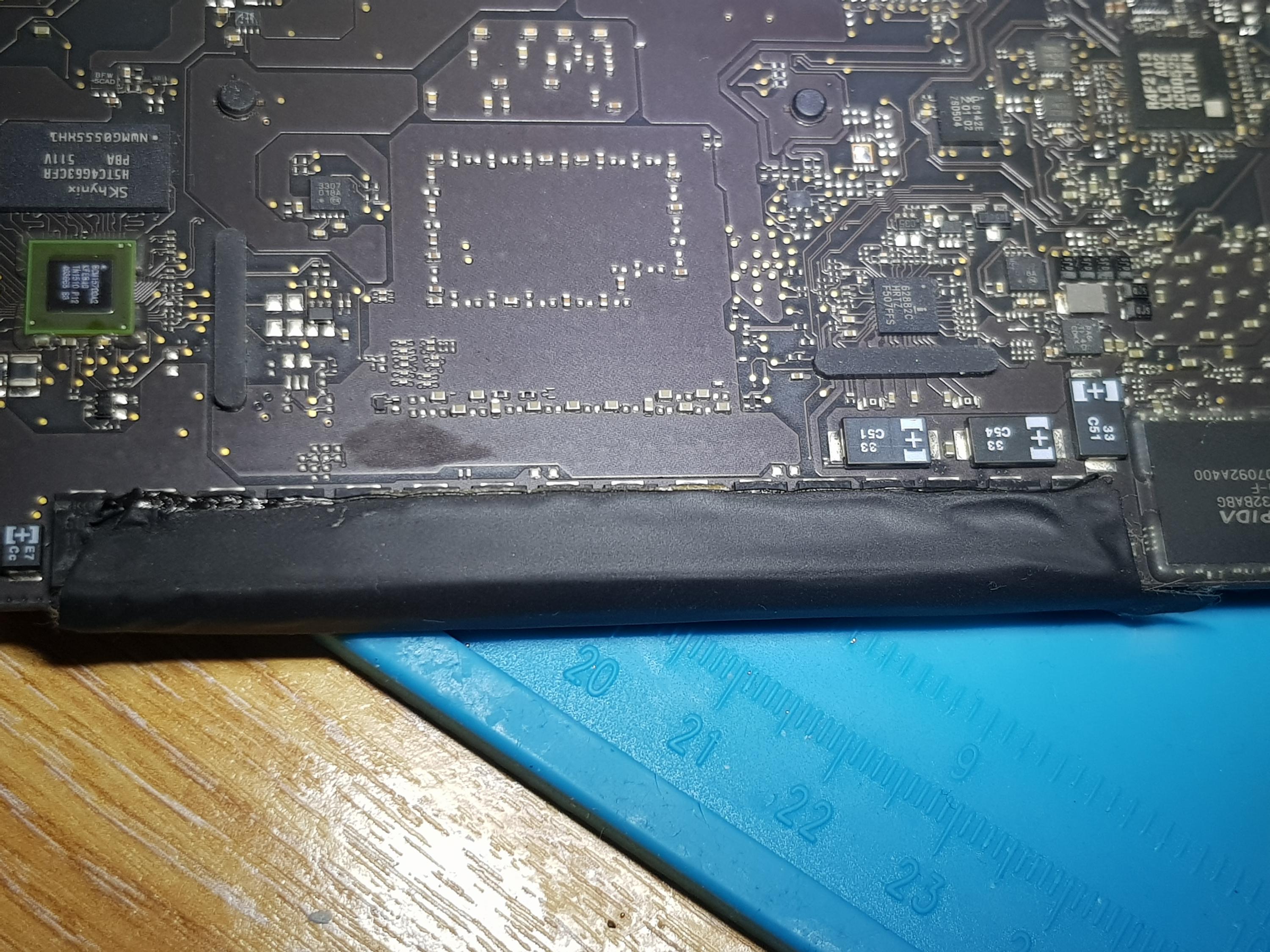

    Hi friends
    I have a macbook pro mid 2015. A1398.
    The laptop powers on but nothing on screen. And no "Chime" sound as well.
    I have checked all the rails and all provides related voltages.
    The black thin nylon cover on the PCH chip have sings of high temprature (some bubbles) and i noticed similar signs on the black paste rounding the vcore rails.
    When powers on, all the voltages are pressent. The fan is idle even when the cpu starts to wam up. And the pch also starts to raise its temprature .
    I do not know what to start with. As i suspect cpu or the pch chip.
    Any advise?

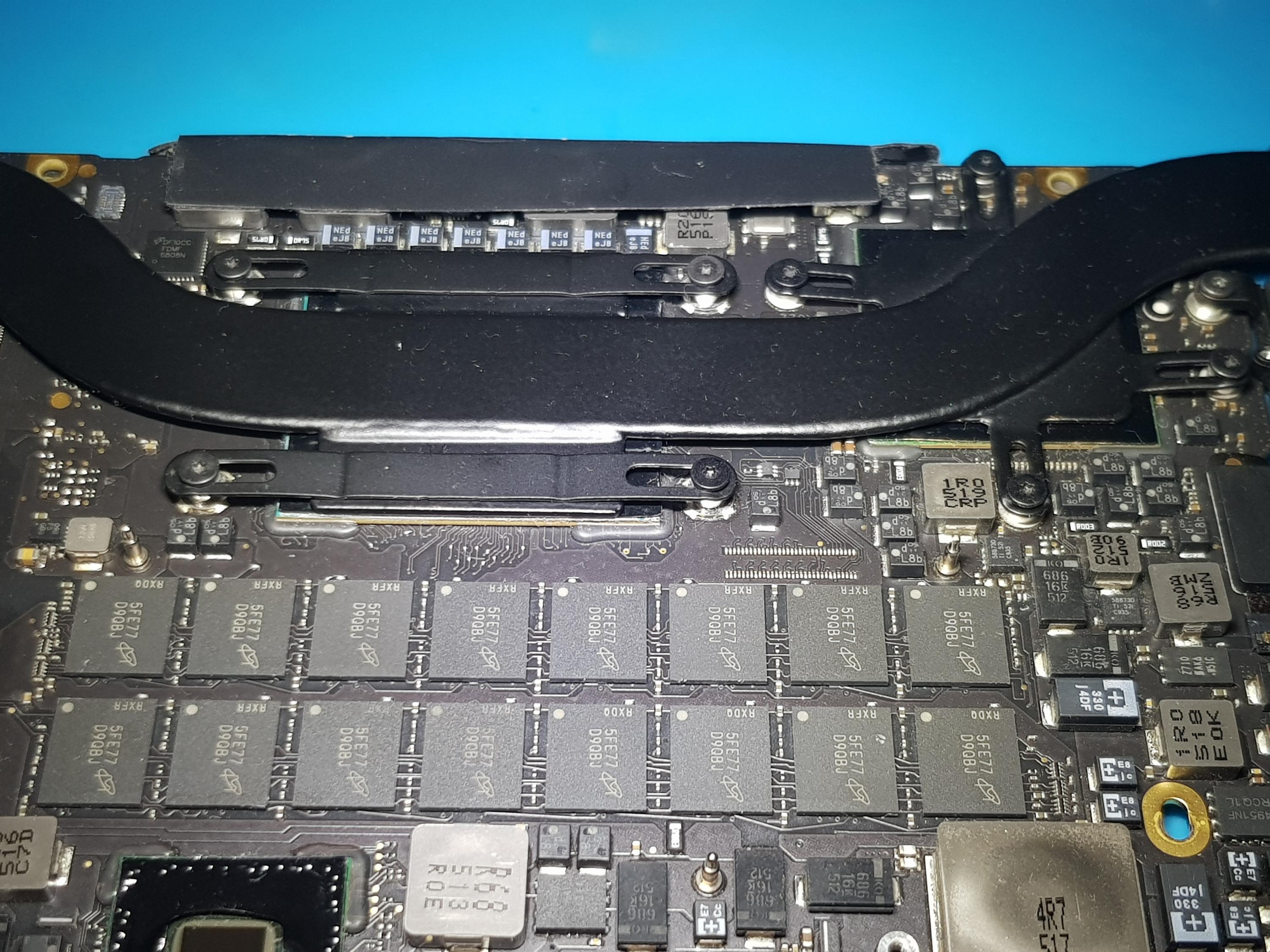

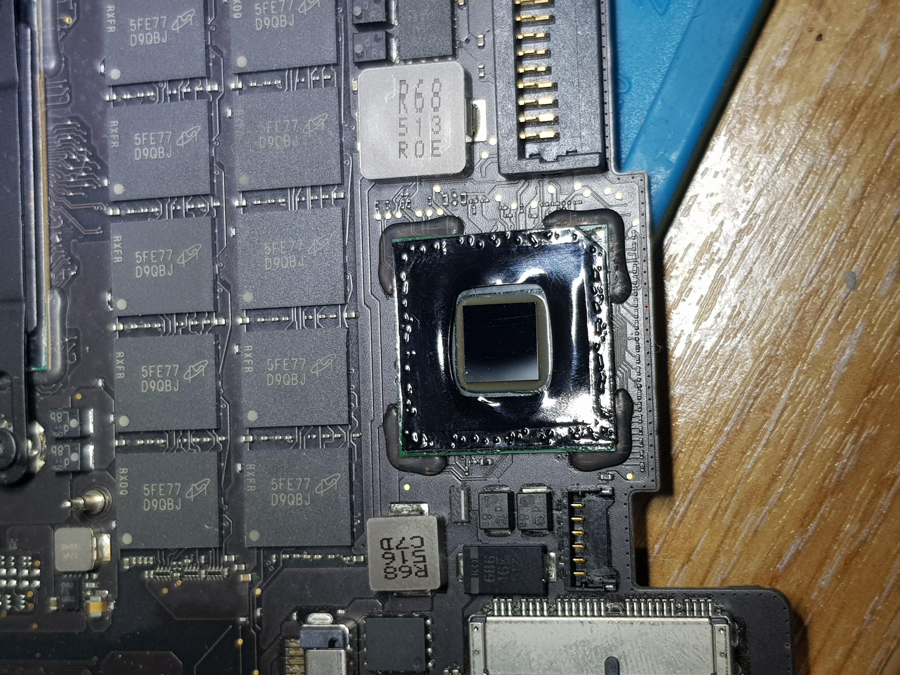

    Re: Apple macbook pro A1398 not posting?
    History of the machine? Exact voltage on CPU VCore?
    Post pictures around PCH and CPU
        My apologies for the late reply due to unexpected event.
        Thanks for following up.
        Unfortunately, i do not know the history of this laptop. But there is no water damage to the board. The only thing i noticed was the heating signs as i mentioned before.
        I have taken all the voltages of all the rails on the board.. and also took pictures for the pch showibg the sings of heating.
        Kindly refer to the attached photos.

                              • Weelcup
                                TopTech
                                • Oct 2017
                                • 302
                                Board is 820-00163 (or 820-00426, same thing), no known issue except CPU VCore VRM chip that can cause random shutdown occasionally (but not really common on this model).
                                Plug in USB drive and check if the activity LED blinks after a while. If nothing I'd try a known good EFI just to exclude this possibility.
                                I managed to get a donor board. But i am not sure which one should i replace first the CPU or the PCH chip. My expectations are going toward the CPU though. As it is getting hot really fast. But I am open to your suggections...
                                Thanks in advance
