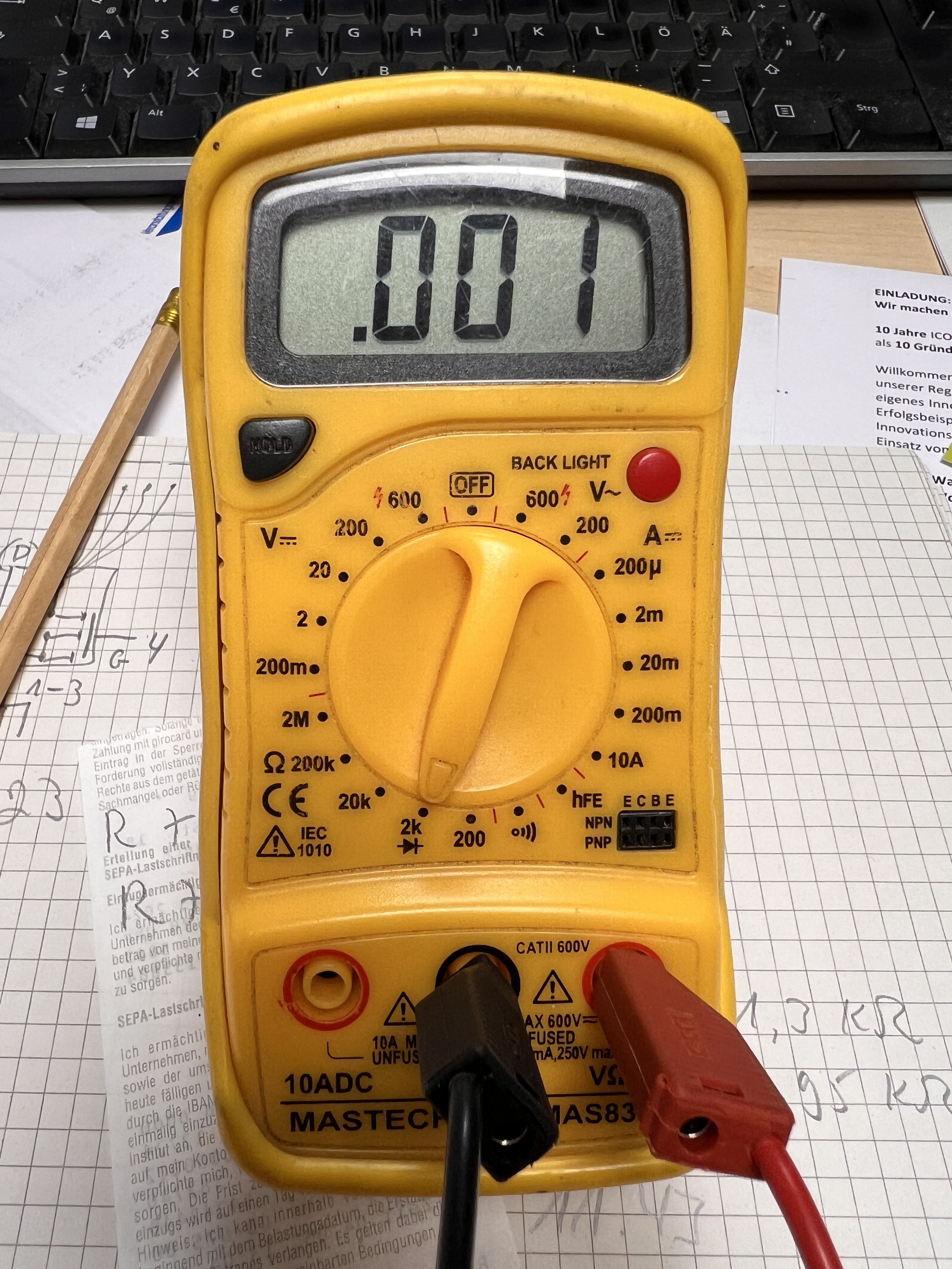

        Seems a bit high. Touch your meter probes together. What is the resistance measurement?

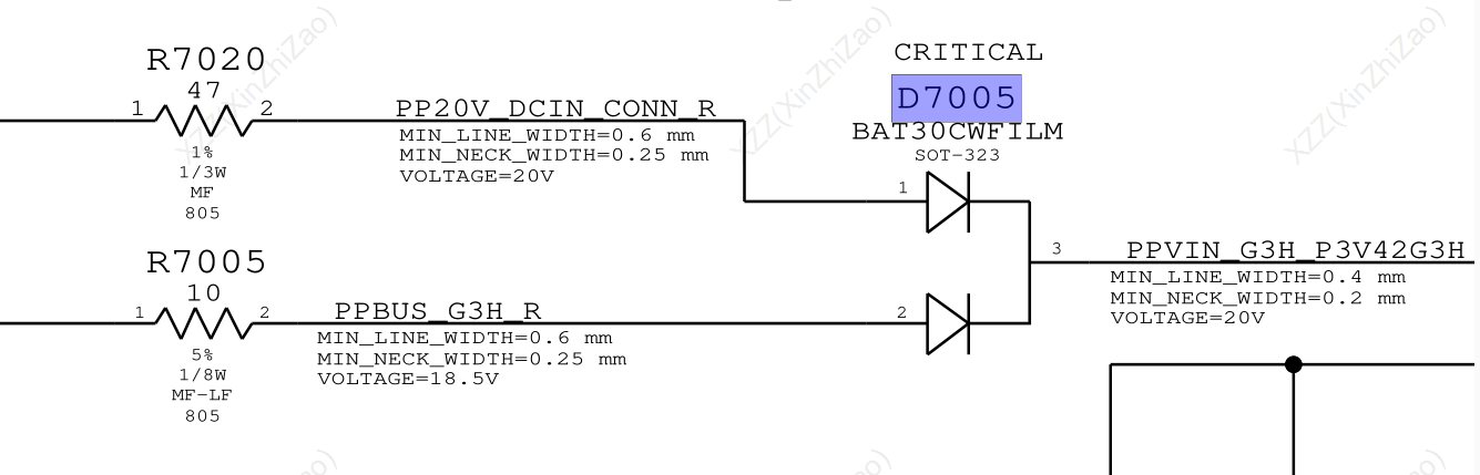

        Locate the dual diode @ D7005.
        Confirm the voltage @ D7005, pin # 3 with only the power adapter attached. Check the voltage to ground of pin # 2 (still with only the power adapter attached). We are checking if this dual diode is leaky or not.

          What are the units of measurement? Is this kohms? If yes, then ok. Confirm it. Be sure the battery is not attached during these tests.
          Yes, kOhm (see atached pic.)
          Between pin 17 and 18 there are 3,8 Ohms. is this how it should be?
          0,001 kOhm on diode mode
          00,7 Ohm at 200 Ohm mode
          D7005 pin 3= 19,9 V
          pin 2= 12,3 V
          pin 1= 20,1 V

            I just checked the R7005 and R7020 next to the D7005. there are OK.

                  at the schematics (see above) is writen that on the pin 2 (D7005) should be 18.5V but I messered only 12,3V is this OK?
