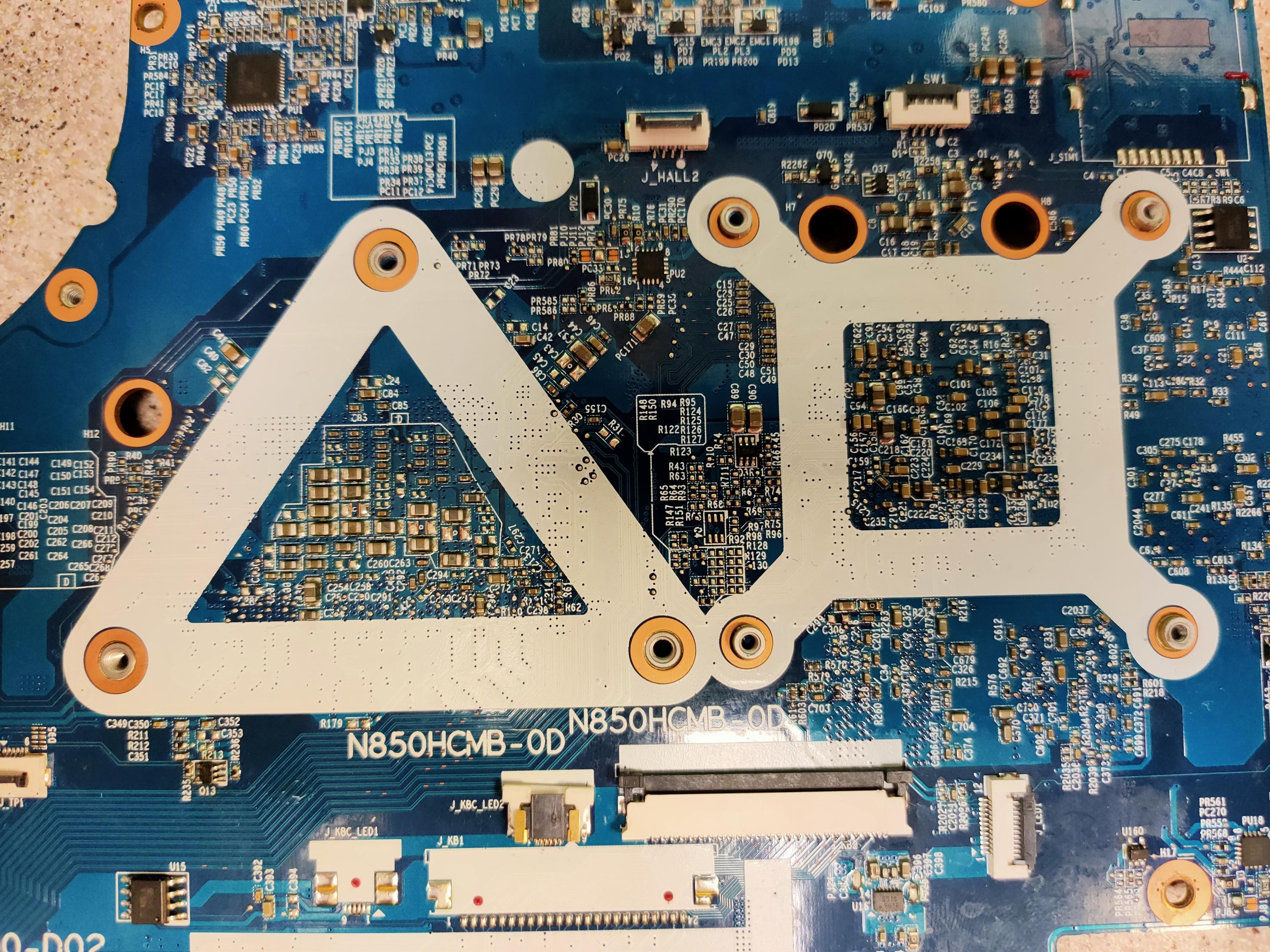

    Hi Guys,
    I looking for some advice.
    I have a Clevo n870hc that's has stopped working. Plugging the power adaptor in and displays a amber light on front. (No Battery installed)
    If power button is pressed that the led turns green for a few seconds and go back to amber.
    With battery attached the changing circuit seems to be fine and laptop was displays amber and when battery is
    changed it goes green as it should so i'm guessing the ITE is working.
    On the odd occasion when pressing the power button, the power button led stays on and both the CPU and GPU fans kick in but after a few seconds they
    shuts down and wont restart. On that occasion the screen stays blank and displays nothing, not even a back light.
    Where would the best place for me to start?

        I have started doing a cap test and found shorts in:
        Page 66 - Gpu
        c587, c616, c618, c619, c621
        Page 55 - Processor 5/6
        c594, c595
        Page 56 - Processor 6/6
        c596, c579
        Before i start changing the caps, i cant seem to find what may have caused the issue. Possable GPU/CPU Temp?

                      Measure exact resistance to ground. 6 ohms to ground on CPU VCore for Kaby Lake is perfectly fine. GPU VCore may be similar or even lower.

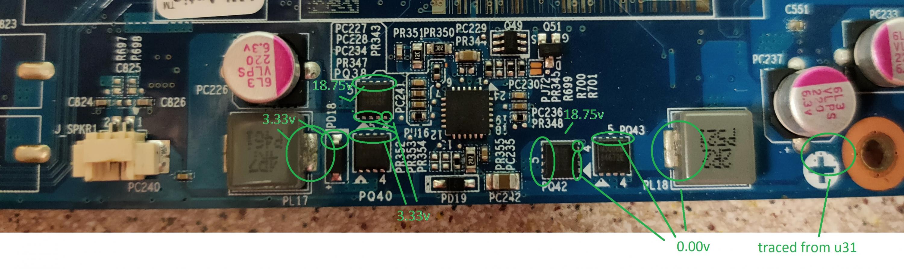

                          I have been working on finding 19v and 3.3v and they seem to be fine but i cant find the 5v rail.
                          Can anyone tell me if on page 84 the type-c, 5v should that be always live with ac connected?

                            Check page 90 5V, 5VS, 3.3V, 3.3VS, 3.3VA if all voltage are available then follow the power sequence page 107 & feedback what’s missing

                              v3.3
                              u31
                              pin 1,2,6,7 - vdd3 - v3.3
                              pin 8,9 - 3.3vs - v0.00
                              pin 13,14 - 3.3v - v0.00
                              v5
                              u30
                              pin 1,2,6,7 vdd5 - v0.00
                              pin 8,9 - 5vs - v0.00
                              pin 13,14 - 5v - v0.00
                              u26 - VA
                              1 - 19.28v
                              So it does look like i have 5v is rail down. I have been looking at the type-c/usb 3.0 area as i can see a bit of what looks like liquid damage as U14 looks a bit crusty.

                                DD_ON# SUSB# missing trace it back U31 pin 8.9 5VS not 3VS

                                  Nothing from pin 4 on PQ42. just tracing DD_ON# & SUSB# now.

                                    find out PJ501 jumper if its' soldered remove it & see if 5V is there or not if not check the resistance to gnd of both pads

                                      Removed and got about 0.65v and then it started to slowly drop on pins 1,2,6,7 - u31
                                      • cdgold3
                                        • May 2018
                                        • 23
                                        • Cleveland
                                        Re: Clevo n870hc / No boot
                                        Pad on side of U31 - no resistance
                                        Pad other side - 1.191
