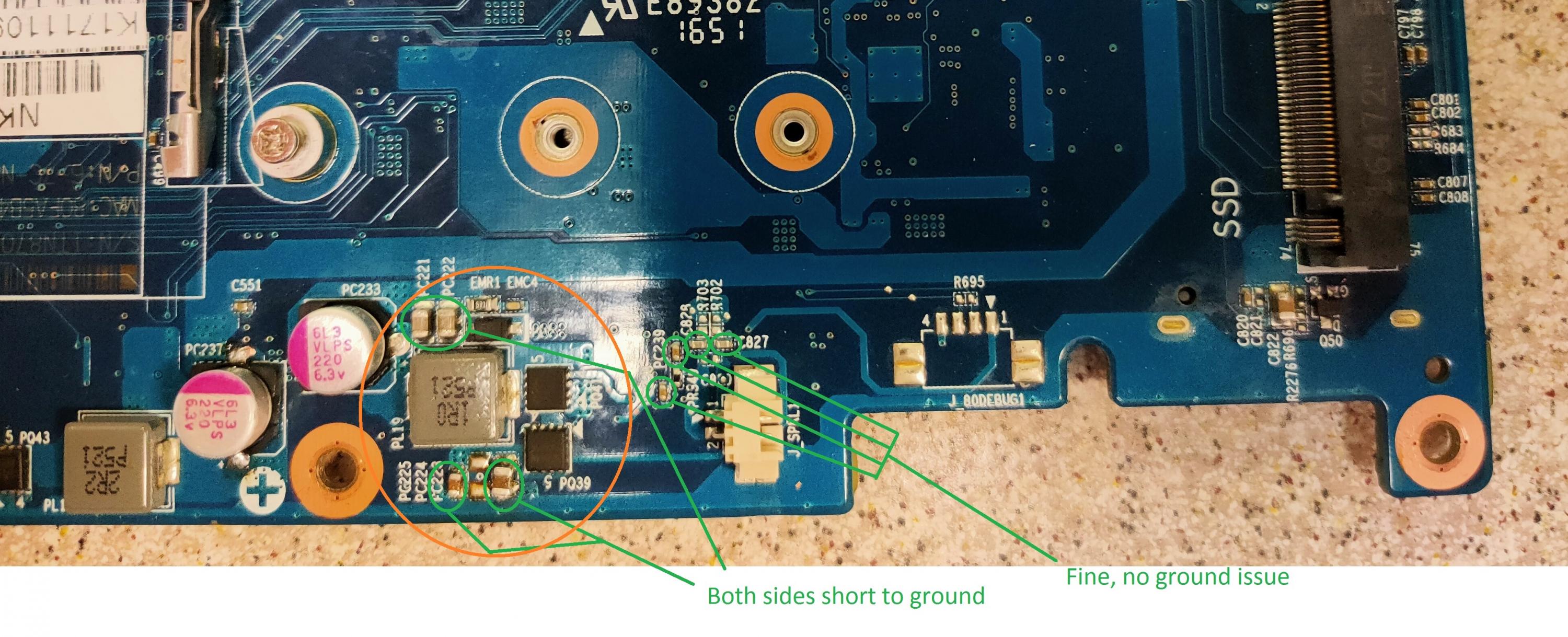

              Last night i found that there was no VREG5 on pin1 on PU16.
              I tracked from Q49 Pin 2 to R700 and got 4.47v. Unfortunately i may have caused a shorted something when looking at PC235. So now i have a short to ground on the 19v rail.
              Before the above i removed PQ43 and PQ42 and they seemed ok. just they are not getting a signal to trigger.
              I tried removing both U16 and PC235 and still got the short. So at the moment i am now tracking the 19v short but i think its coming from the right bottom of the board. If i ground and touch pc225, pc223, pc211 and pc222 i get ground on both sides.
              I have removed pc225, pc223 and still get the short but i am still looking.
              Testing say pc242 and C763 there is ground only to one side so the issue maybe in just that area.

                PQ39 was faulty, now have 19v again
                  Re: Clevo n870hc / No boot
                  after replacing PQ39 that fixed the short to AC but i found another on PC221,PC222
                  After removing PJ44 short disappeared from side 1 but side 2 is still to ground.
                  I cant work out where side 2 connects to. Can anyone point me in the right direction?
