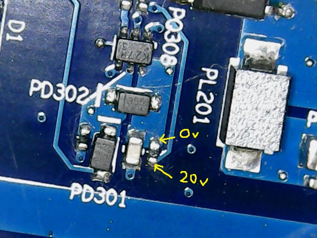

    I have problem with Lenovo g50 -70
    power on but i cannot see nothing in screen
    please check the picture .. is this OK ?

    That one is PR306 and should have 200KΩ
    Anyway - it should power on and see something on display. what you have in picture is from battery charging. Works independently that part.

      i have 200ΚΩ

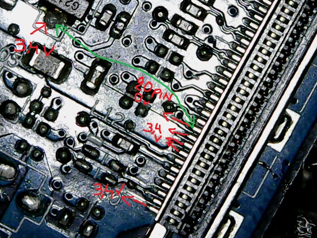

          I put a ligth in screen and i see activite . but the backlight dont work and i dont see the lenovo logo.
          blinking a dim light

                So you see picture but no backlight !..do you try on external display !
                can you take this measurement on JEDP1 : Pin 1/2 , Pin 21/22 , Pin 2 Q8

                    I try with external display ... but not work
                    PIN 1 20.1V
                    PIN 2 20.1 V
                    PIN 21 3.4V
                    PIN 22 3.4V
                    pin 2 q8 ???

                      No need now for pin 2 of q8 since you got 3.4 at pin 21/22 , sorry to not ask for this before : pin 20/23 for 3vs ..if you got it than try another screen and /or another screen cable...if no backlight than try flashing bios .

                        I had a lot of lenovo with this type of problem. I just disconect lvds cable from display, reconnect back and everything is back to normal.

                            What about pin 20/30V !

                                pin 20 0v

                                  R21 and C22 doesn't exist, if there is no short on pin 20 try to make a jumper from 3VS to this pin and see if there is a picture .

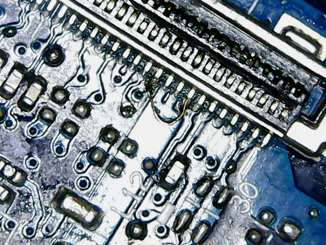

                                    Re: LENOVO G50 -70 power on No screen
                                    take a look..

                                      3Vs appear after switshing power button ,this is your S0 satate.It supply many others IC's .
                                      why you don't have it on pin 20/23 !!
                                      can you take the measue of Q24 ( D/G/S) and see like Kiraro says if thers is a short on it !
                                        i make a jumper and i have this action from the screen ... no backligth and one horizontal line blink every 3 or 5 second ....
