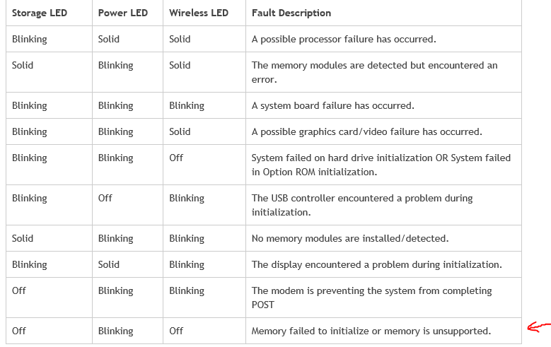

    Hello Everyone,
    I have a Dell Latitude E5440 that doesn't power On. It flashes Power Led continuously [Long blinks].
    Initial problem of this laptop was that the RAM IC [TPS51362] got burnt and caused a short on the motherboard. After replacing the IC, the short was gone but the Laptop did not power On. Instead, it starts blinking (long blinks) Power led continuously when I connect the AC adapter or Battery.
    According to Dell's blink codes, it is assumed to be "Memory failed to initialize or Memory is unsupported"
    check the attached image.
    Any ideas on what i should do???

    Is your 3/5ALWS & LDO voltages are ok ? RTC section Ok? What are the missing Voltages on the MB when Press the power button?

          +VDDRP & VGA CORE are missing ? U45 U46 pin 14 8 what is out put voltage ?

            The flashing power led is more like a Power On loop. Goes On-Off On-Off continuously......
