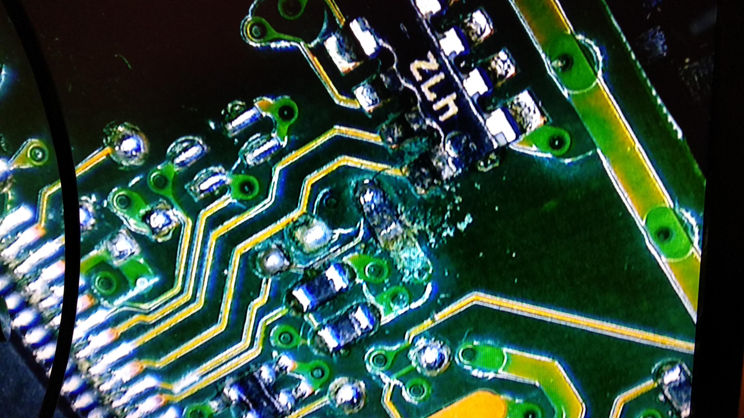

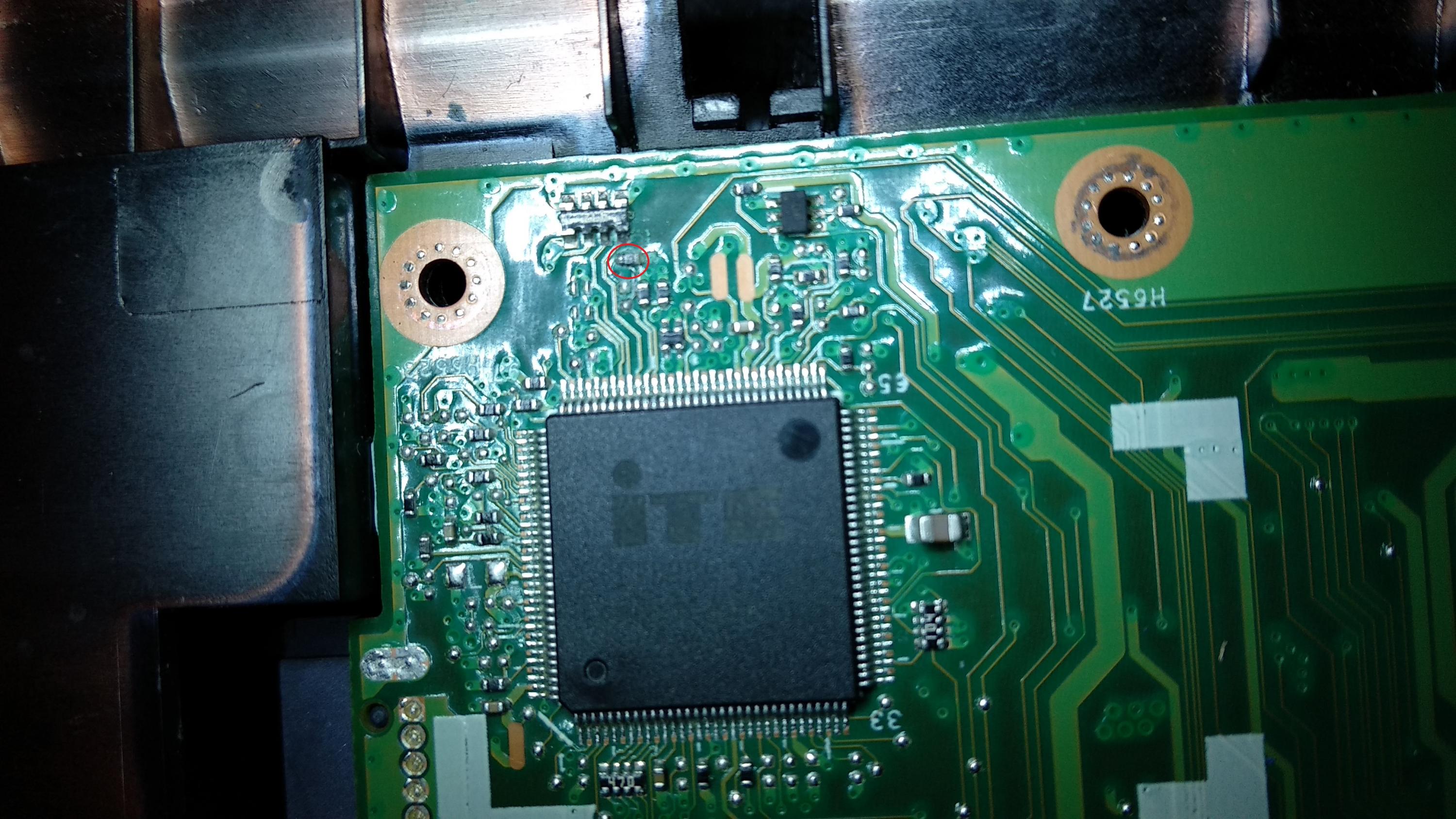

    Hello
    Have Asus f552m to fix
    Water damage
    ThΓ© Guy says : when i touch some pins on SIO the laptop works. Either no boot. Led ok
    On inspection this Guy is dead
    Can u help me identify ?
  • disorder
    • Sep 2015
    • 154
    • france
    Re: Asus f552m : nerf to identify resistor
    hello
    finally find, 100kohm, line 3vsus_on, so explain that no boot, cause ITE not activate
    replace by new one and voila !
    pb solved
