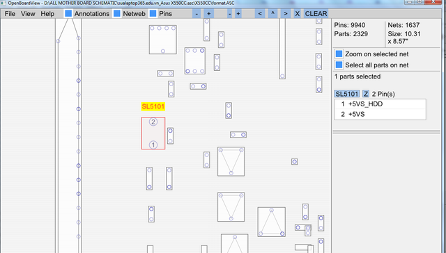

    Ive tessted the SL5101 i dont have +5VS HDD READING reading

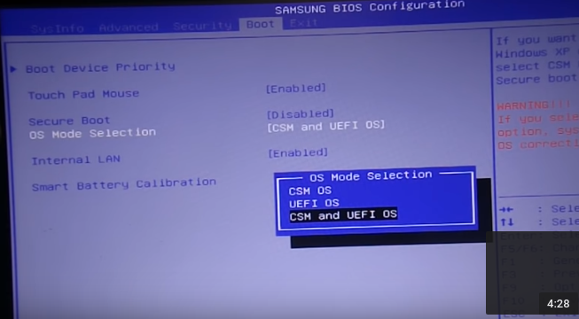

    There is a nice utility there in Windows called swupdate by Asus. Asus update.
    It rocks! It udpates everything just fine, until time comes to updating BIOS. Swupdate does not update BIOS correctly and this is a common problem on these notebooks.
    To fix your issue:
    During boot FN + F2 to go to BIOS.
    Go to BOOT options
    Disable secure boot
    For OS Mode selection, select CSM and UEFI OS
    Save changes, and reboot
    Now obviously, this solution might not work for you because you might have a different problem with your notebook. Try and report back.

      I dont have any boot selection that you have sir

        ODD detecting?? Q5101 gate voltage??
          Check security section. It's there.
            ODD 1-3 pin has 5v reading Im reading 12VS in pin 4 of pq5101
            • mcplslg123
              • Jun 2015
              • 7262
              • india
              Re: X550cc rev 2.0 hard drive not detecting
              Thats correct.

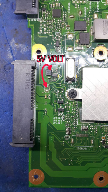

                          Hi can I just create a JUMPER from from pin 1-3 of Q5101 to PIN 2 of SL5101 ? is it safe?
                          upload pic site

                            Aha I see. So the hdd in not connected via cable. It is directly connected via socket. So no cable issues.
                            With regard to the short connection. Why dont you just replace the mosfet ?
                            However, try to connect the hdd with out power the laptop. Just measure the resistant on the side that does not get the 5v...
                              10 OHMS risistance
                                10 OHMS risistance
                                You got 10 ohm to gnd on the sata connector without a drive plugged in? Thats too low. I'd suspect that small cap right next to the connector. Remove it and measure again! The pads on it look darkened. Something most likely shorted the rail and killed the fet. Also please measure gate voltage on the fet.
                                Do NOT bridge another 5v rail to it. This may cause more damage!

                                  thanks sir for the help ive just remove the capacitor then everthuing boots perfectly
                                    Perfet. Well done! As always, just a little cap that breaks everything
                                    You can leave the cap unpopulated. It is just for EMI filtering and not important.
