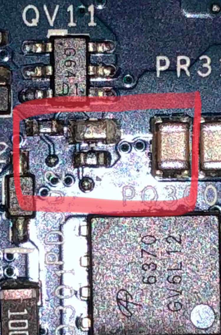

    first of all I am a total noob with board level repair. My Dell XPS 15 9550 backlight died. I tried to replace the screen but it is still not working. I found the schematics online (only for rev 0.0, I have 1.0) but no board view which means I basically can't find anything really on the board. Not to mention that I have never really used a schematic.
    Either way I managed to measure the backlight voltage on the 40pin connector. It is 9mv and supposed to be 25v. Any idea what I should try out next? No matter how much I look at the schematics I don't get any further. The only other thing I managed to do is to look at QV11 pin 1,2,5 and 6 which are also 9mv and probably supposed to be 25v too.
    Here are a few pictures https://cdn.discordapp.com/attachmen...825/image0.jpg
    https://cdn.discordapp.com/attachmen...355/image1.jpg
    The capacitor under Q11 is the only one that looks a bit weird but besides that I found nothing. Any idea what that is used for? Any advise on anything about this is welcome, I have no idea what to do next and I definitely don't have the money to get a new board.
    I hope someone can help me, thanks

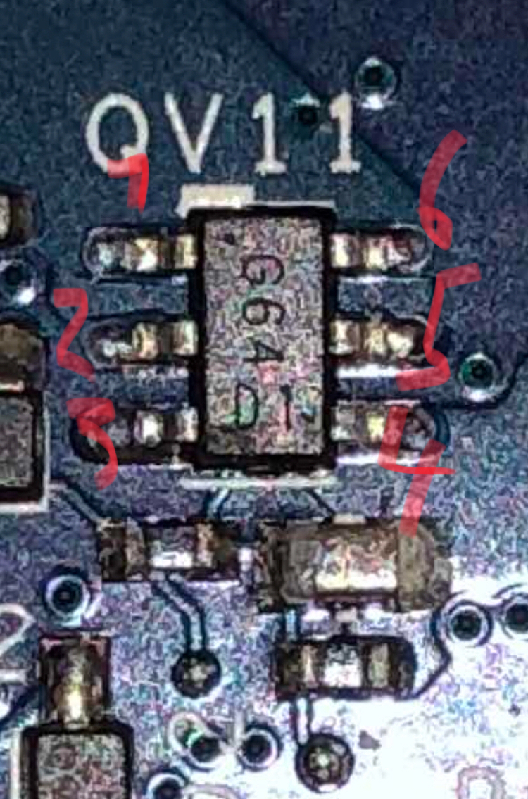

    Re: Dell XPS 15 9550 no backlight
    Test QV11 all legs for Voltage pin4 +B 19V (not 25V Volts ) pin3 8-10V it’s a mosfet , there is a voltage divider connected to pin 3 in that way the voltage on pin 4 will switch to the drain side

      How do I know which pin is 3 and which one is 4? Also I have just shorted one of the pins next to it to 3 or 4, no idea for just a split second. I hope that didn't make anything worse. I definitely wasn't careful enough and got a short spark between the pins I think. Screen is still on with no backlight.
      One of the pins is at around 13.53v and the other ones are still at around 9mv. The other pin (again 3 or 4) is at 13.48v.

        I have also managed to measure QV12. It has 2 pins on one side and one on the other side. The left pin is at 3.38v, the right pin is at probably 0mv? Sometimes it shows 0.1mv or 0.2mv and then goes back to 0. The top(or bottom?, the one that is alone) pin shows 0.4mv (constantly).
          Test again with out shorting pins

                4 is 13.6v right now and 3 is 13.55v right now. All the other pins are still at like 8.7mv.

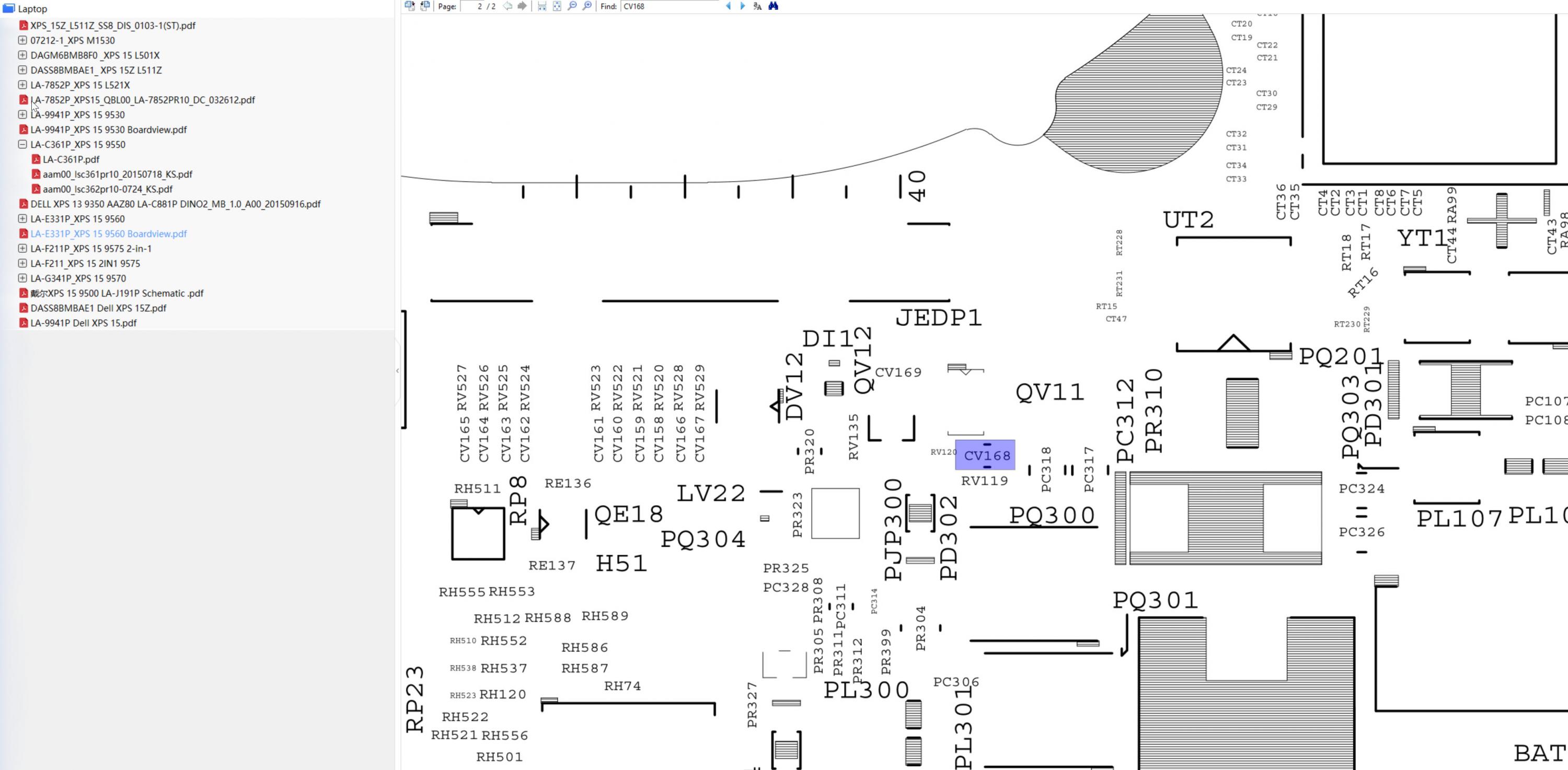

                      https://puu.sh/EH4PO/88f0016834.png
                      https://puu.sh/EHoGY/edef2df9a6.jpg
                      Maybe I have the wrong schematics (my schematics is rev 0.0 while my board is rev 1.0) but it would make sense to me.
                      edit: I shorted pin 4 and 5 and the backlight actually turned on!!! so what now? Replace the right resistor with 1m ohm?

                        Ok I did it, it works now the capacitor CV168 was defect. This is what gave me the 378 Ohm. A guy took it off the board for me and now it works. Should I replace that or can I leave it off?
