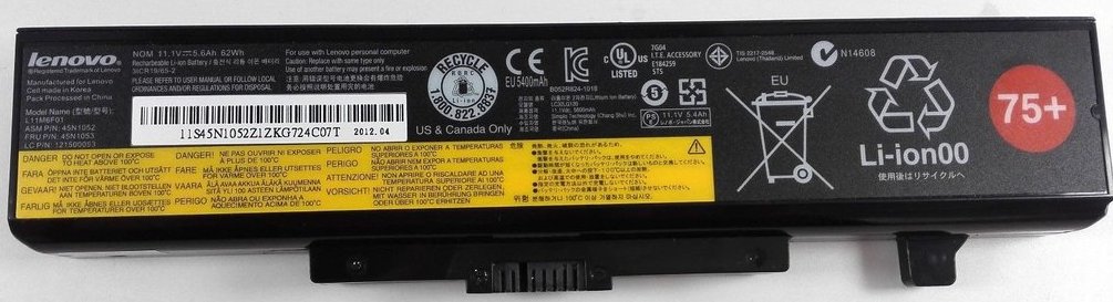

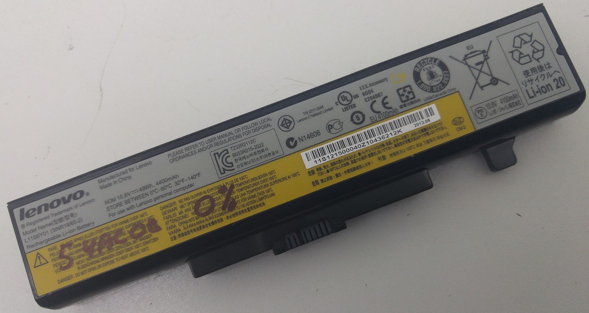

    Dear Forum Members,
    I have the following laptop batteries:
    - part number: L11M6F01 , 11.1v 62Wh belonging to Thinkpad E531
    - part number: L11S6Y01 , 10.8v 48Wh belonging to Ideapad G585
    the two batteries have the same shape and pins but different voltage ratings.
    some websites claim these two part numbers are compatible, but I am not sure.
    what will happen on mainboard if I use the second battery (belonging to Ideapad G585) in Thinkpad E531?
    Does the Thinkpad's mainboard get damaged after some time?
    have anyone replaced a 11.1v battery by a 10.8v battery yet?

    Re: Battery Compatibility, Lenovo E531
    Hi
    I Think thats no problem.the running wil be shorter because the G585 Battery has only
    48WH .
      I replaced it into Thinkpad E531. the new battery can turn the Thinkpad on, but it does not charge the new battery. At startup, the Thinkpad laptop says: the battery is not genuine and cannot be charged.
      the new battery is genuine but belonging to Ideapad G585.
